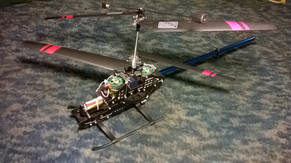

    I happened upon a posting for this Walkera 400D Coaxial heli. From the pictures, it seemed rather well built for a cheap coaxial, but I noticed it had a swash plate at the lower rotor, suggesting full fixed-pitch cyclic control (further investigation verified this). Being the same size class as the old Syma I have, I have spare motors already.
    The thing only cost me $40, why not...... It was compete with Tx, 2 3S packs, and some spare parts and another whole frame.
    Flying the thing is a bit weird at first. I had to tweak the CG a bit to get it trimmed enough to control without jacking the radio trims too much. Once that was done, I was able to dial it in to a neutral hover.
    Full cyclic control at one rotor against another rotor with a 45* lead fly-bar is a weird thing to experience compared to a CP heli, or even a FP fly-bar heli. It's all well and good until you put too much cyclic into it and the fly-bar goes crazy. I'll have to play with the fly weights next to see if I can make it a bit more agile.
    It's just something of medium size to bash around indoors during the winter..... and chase household pets, and what-not. :D WP_20161124_001.jpg

      Last nights session with reconfiguring the layout of the electronics and power system resulted in a more modular battery flexibility, or being able to use 3S 1600mAh or 2200mAh without adversely affecting CG.
      Upon further inspection, all blade grips swash plate and bearing plates are aluminum "Lynx" looking upgrades, with a whole other set of blade grips for other types of blades with thicker roots! The carbon fiber main frame is similar in construction to a T-rex clone variant. I know Coaxials aren't anything special, but this one seems to have a few redeeming qualities that make it nonetheless intriguing.
