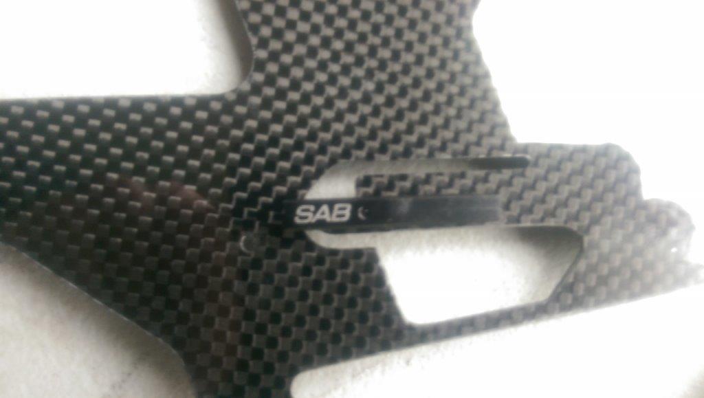

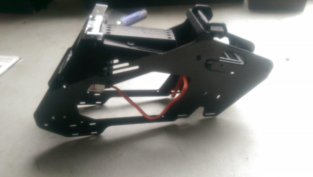

    FIRST STEP.... File down all the edges of the frames using sandpaper.

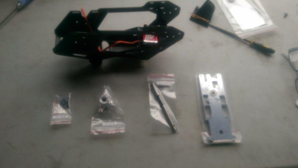

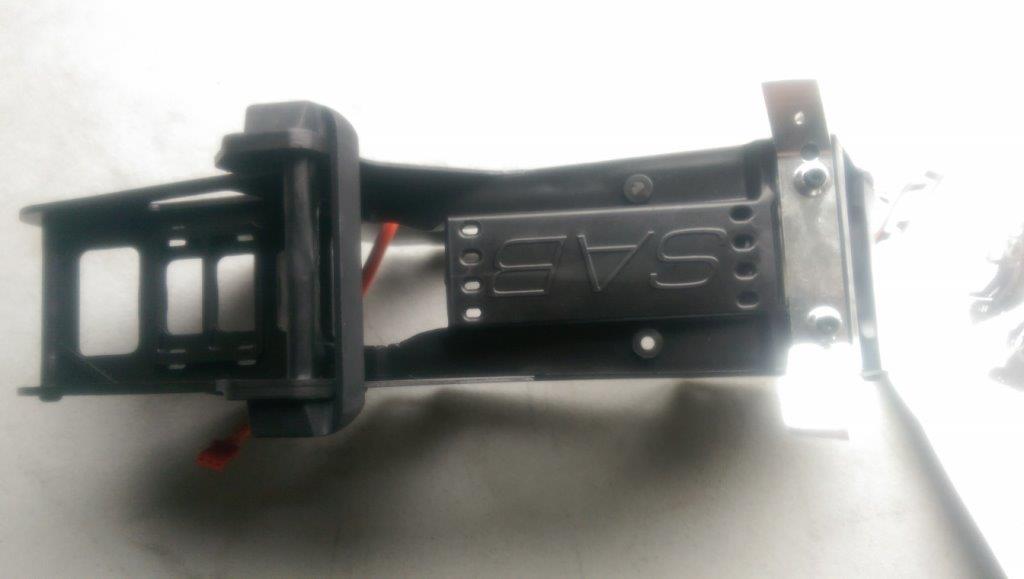

    The frames went together really easily. The most significant thing i should point out was that you should make sure you install the battery clip. Small part easy to forget.

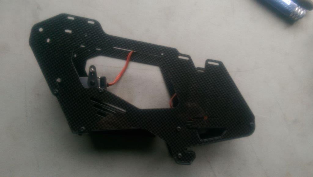

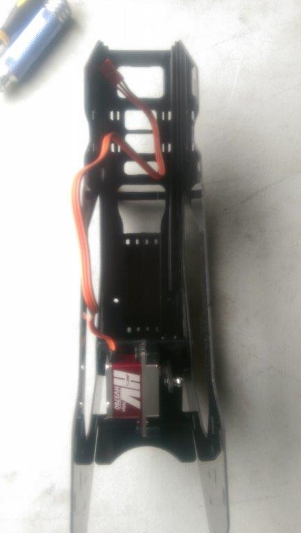

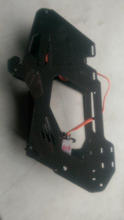

    I installed the bottom plates and the servo mount as suggested in the manual. If you dont insert the servo now, you will have to remove the rear servo mount at a later stage.
    One of the things about this build is how well laid out the components are and how impressive the instruction manual is.
    I brought the optional landing gear... the mounts here are non standard. The front landing gear mount is a bit tricky to figure out so inspect the photo below.

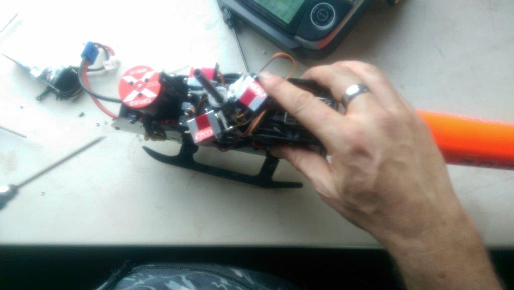

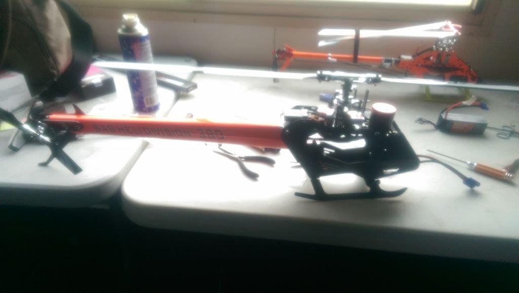

      Its even starting to look like a heli now. Currently 53 minutes into the build (note we were drinking coffee and occasionally watching someone fly)./

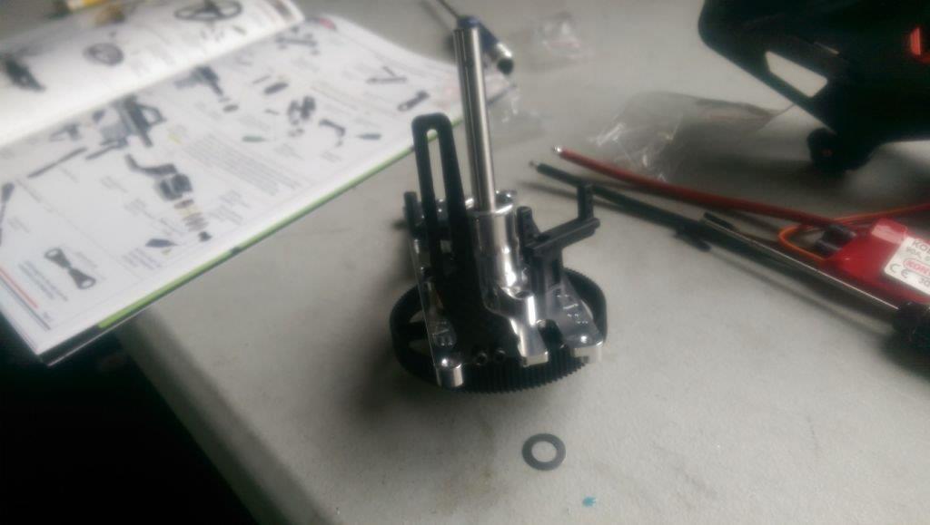

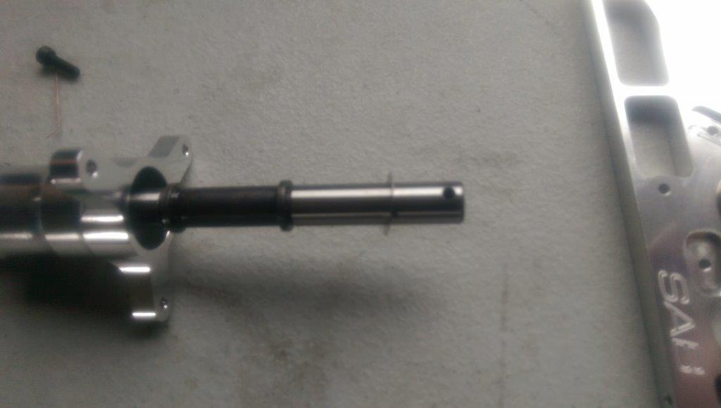

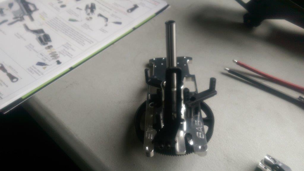

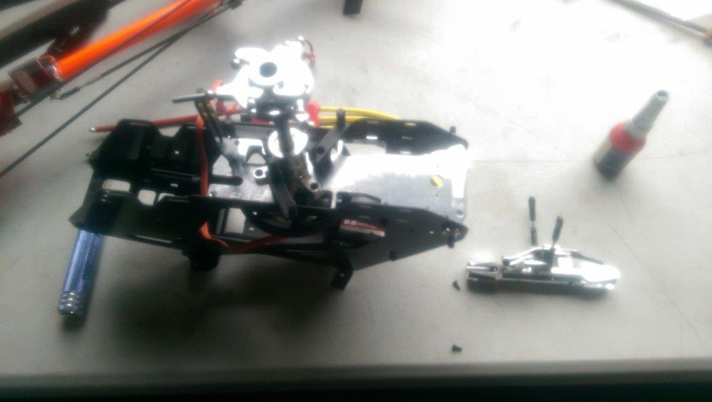

      Installing the main shaft was very self explanatory.
      My old MINIP about to be retired. What a fantastic helicopter this thing was.....

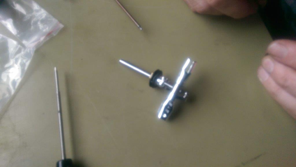

      Installing the main shaft. Note the SHIM.

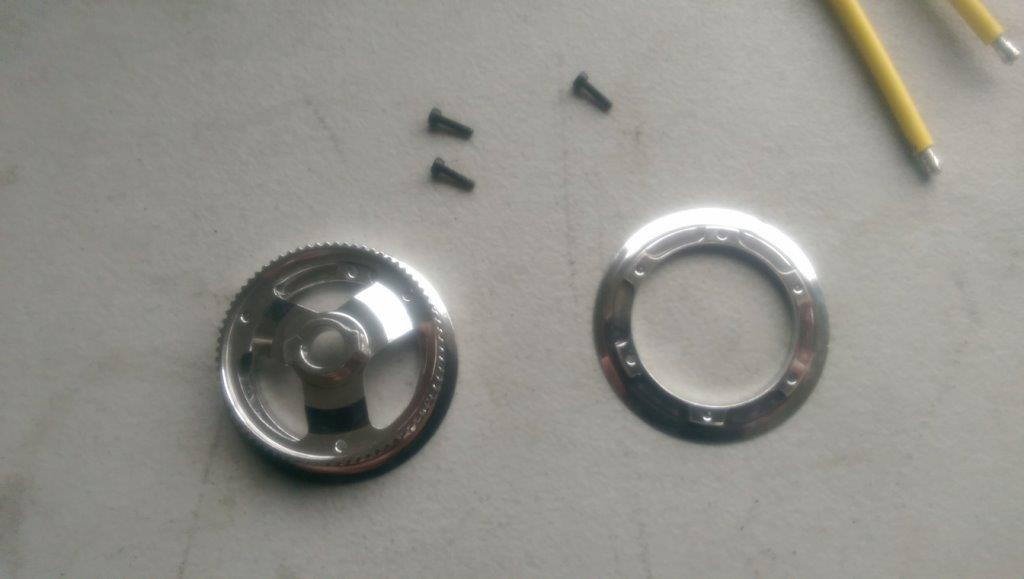

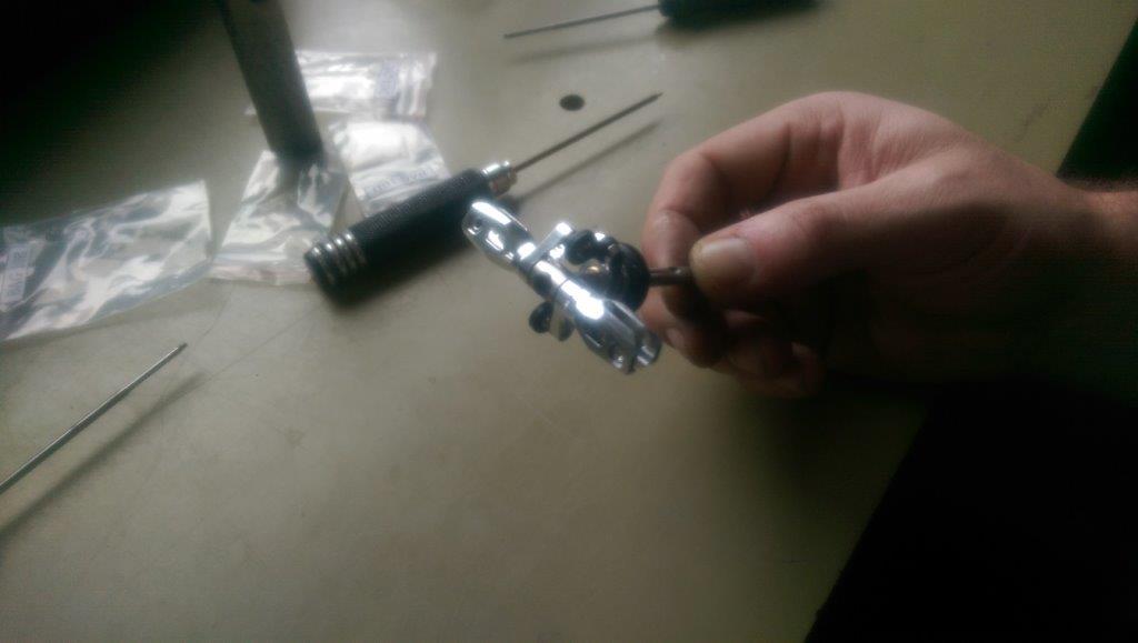

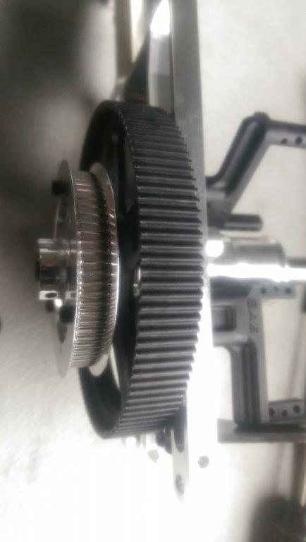

      Main Tail Pulley Gear disassembled.
      Note there is a shim between the tail pulley and the main gear.

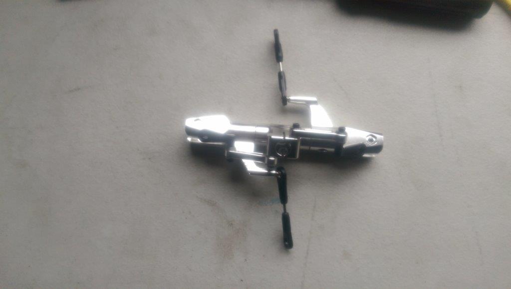

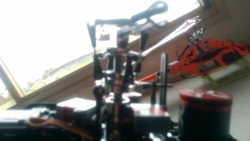

      Head complete...Very easy to assemble. 1 hour and 29 minutes into the build.

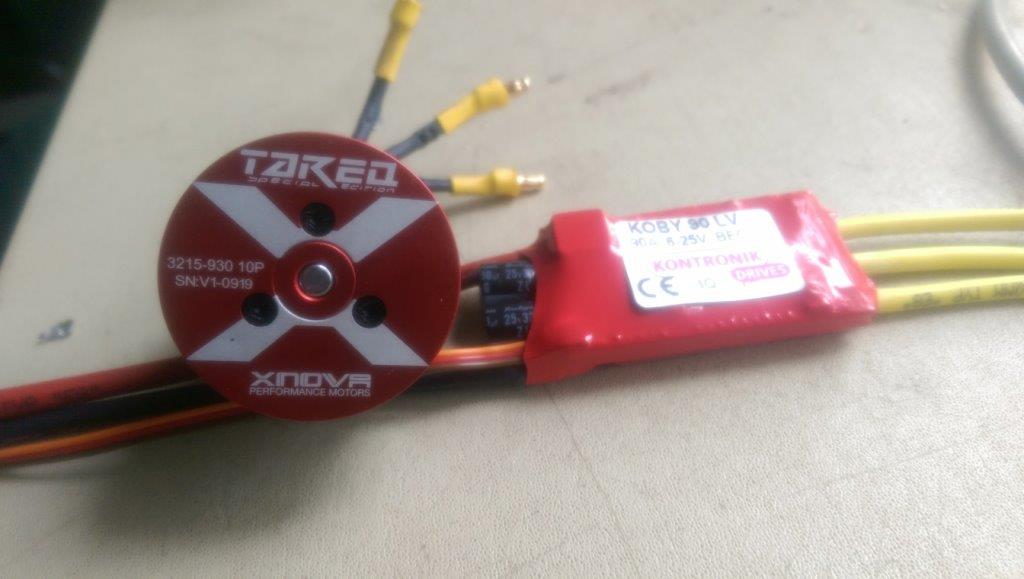

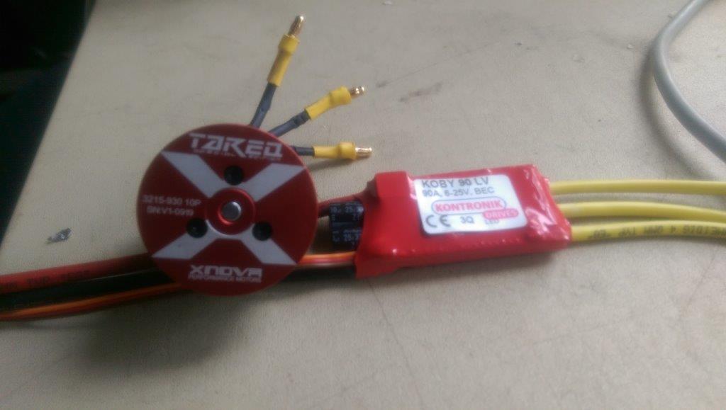

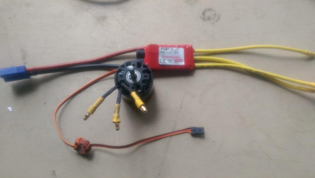

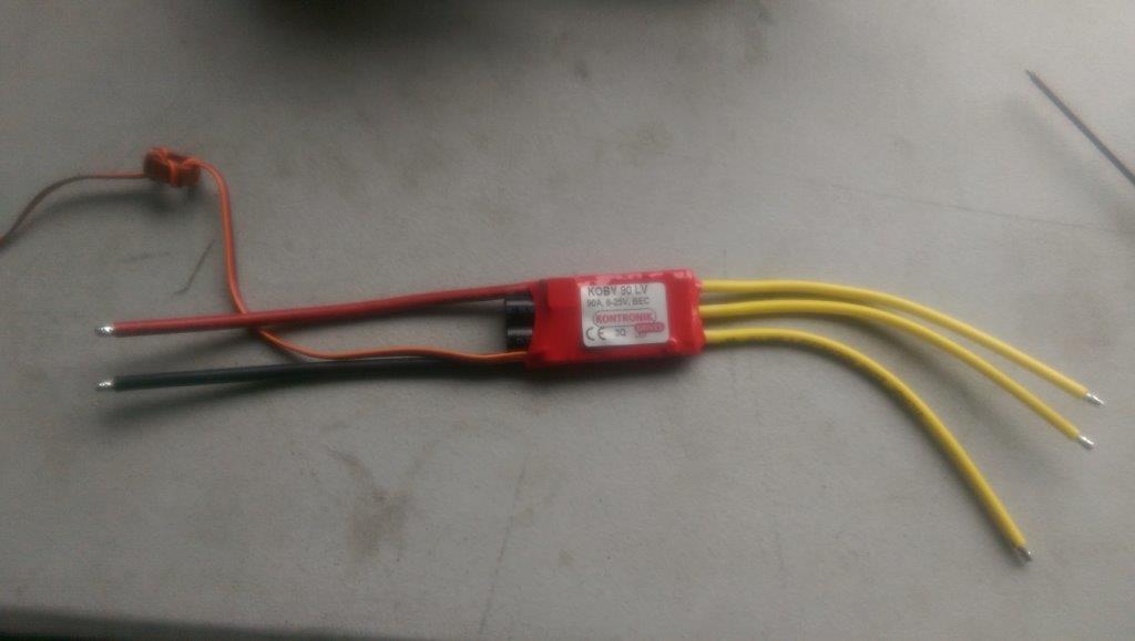

      The KOBY Speed controller and Tareq XNOVA motor. NICE... Drool drool

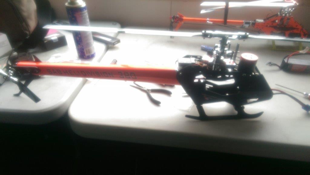

      Starting to look like a helicopter... need more coffee

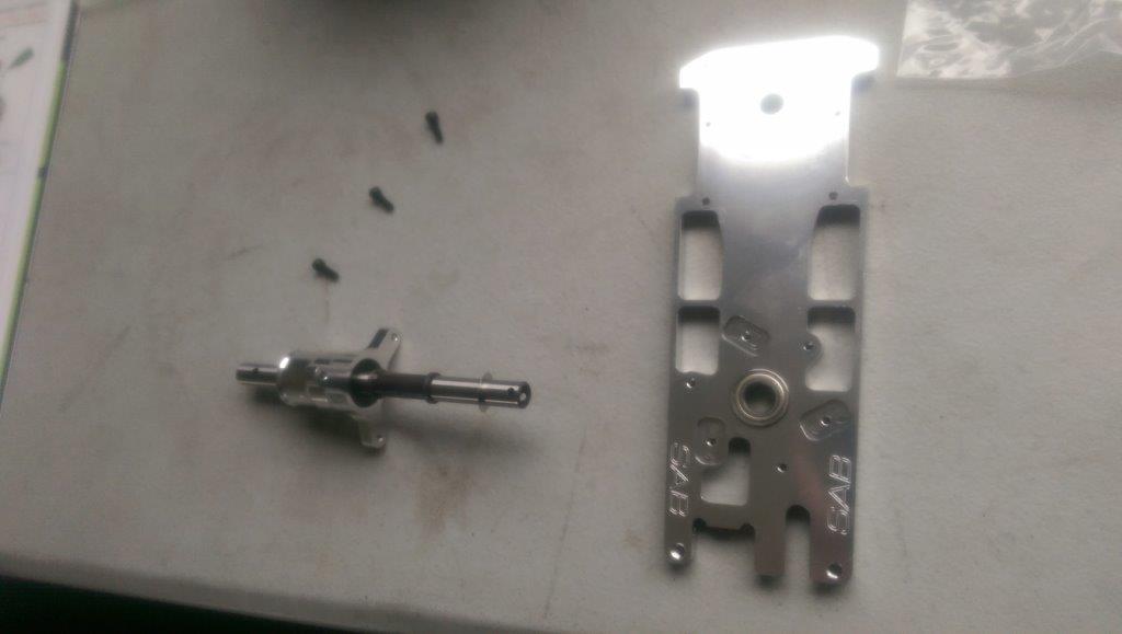

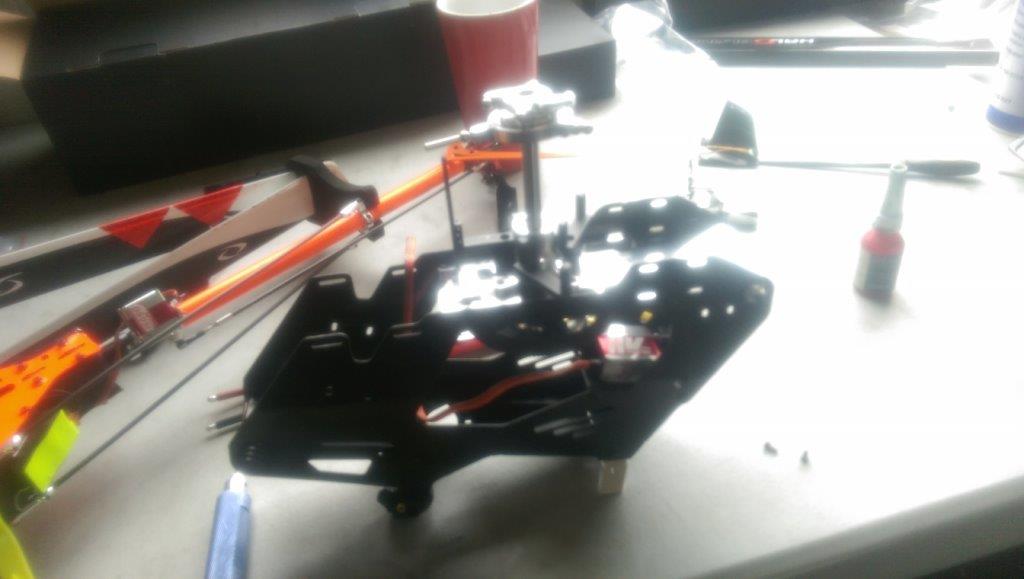

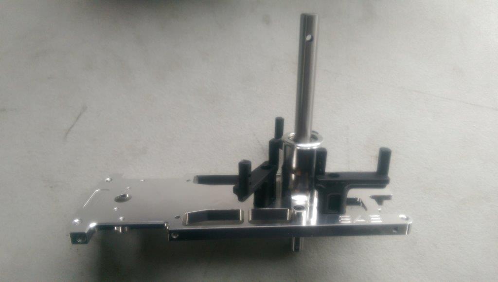

      Installing main plate....very simple once again...

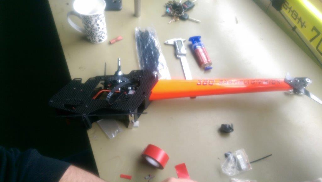

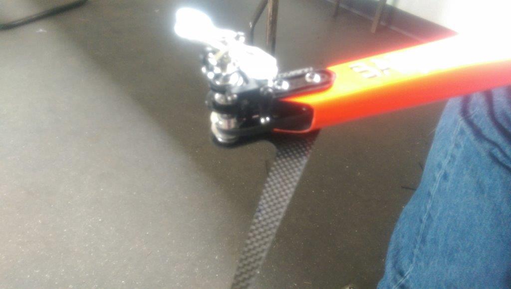

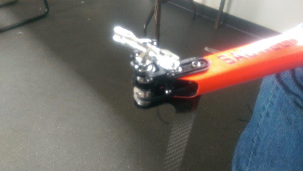

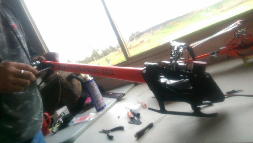

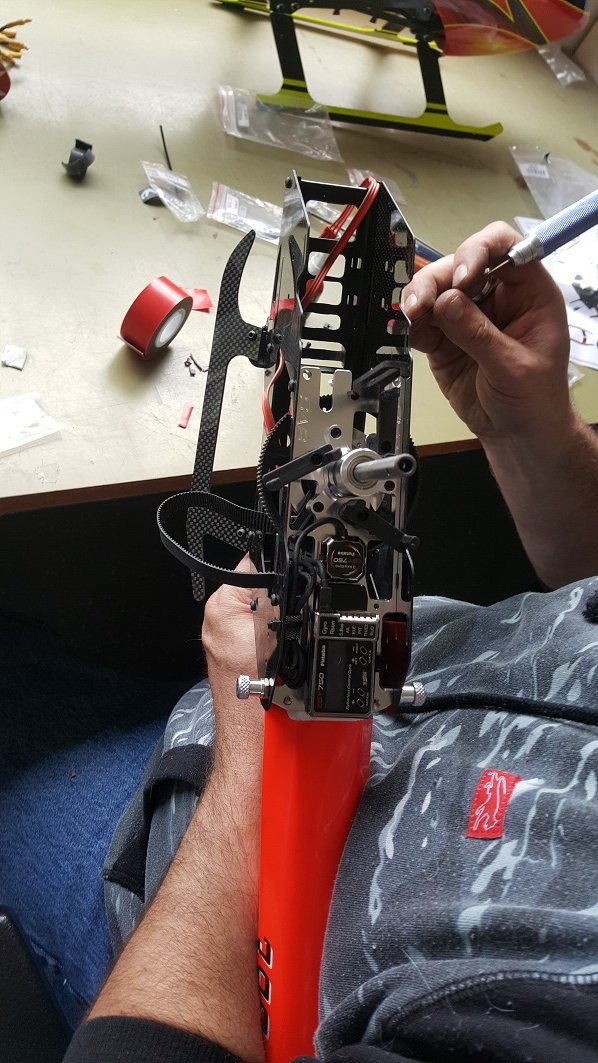

      Tail being installed by @The Dude You should pay special attention to the mounting of the tail as i had an issue with the tail on the first maiden. MAKE SURE THE BOOM IS SEATED PROPERLY USING THE NYLON NUT. Mine wasnt. On my second flight the belt flipped off and broke a blade and servo horn. No damage to the model.

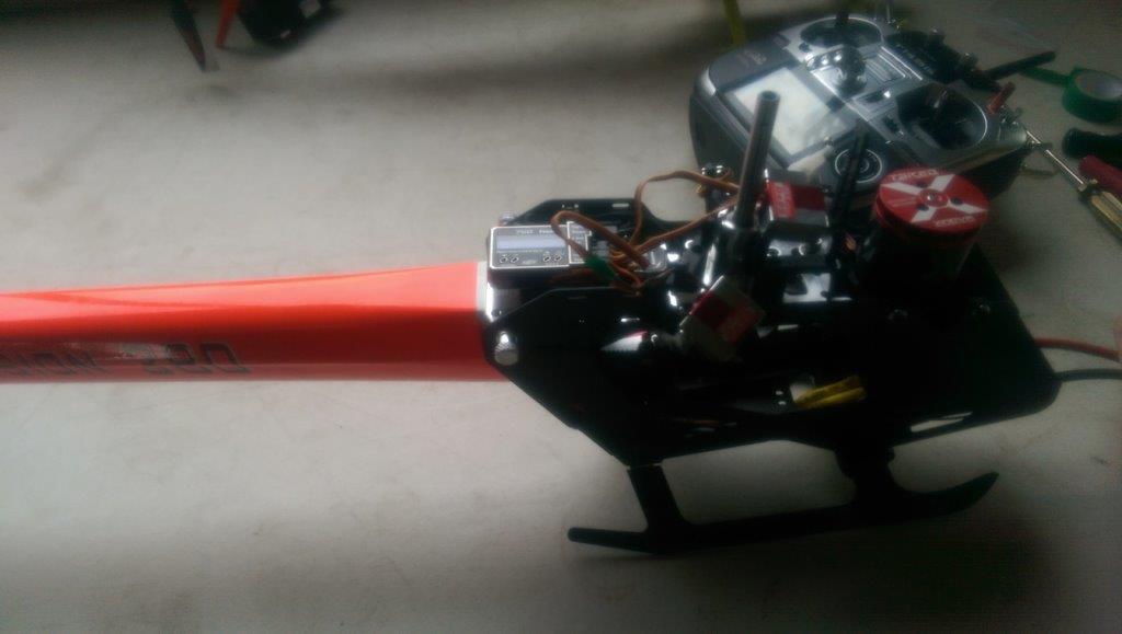

      Pay special attention to the tail box. Currently we are into 3.5 hours of the build.

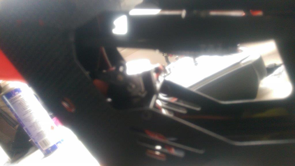

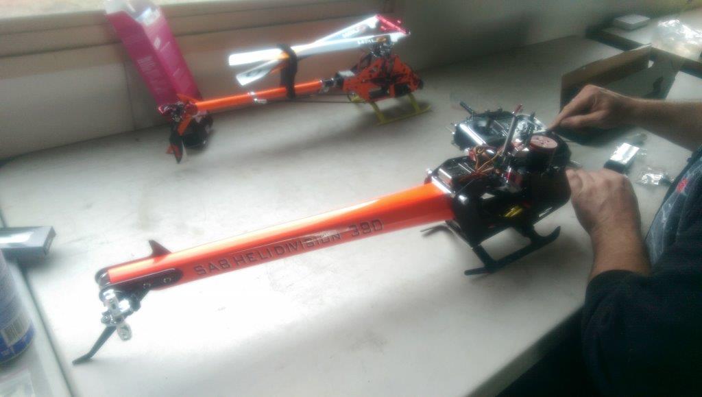

      Putting in the electronics now... We can see the finish line.
      Using the MKS servos from my minip.

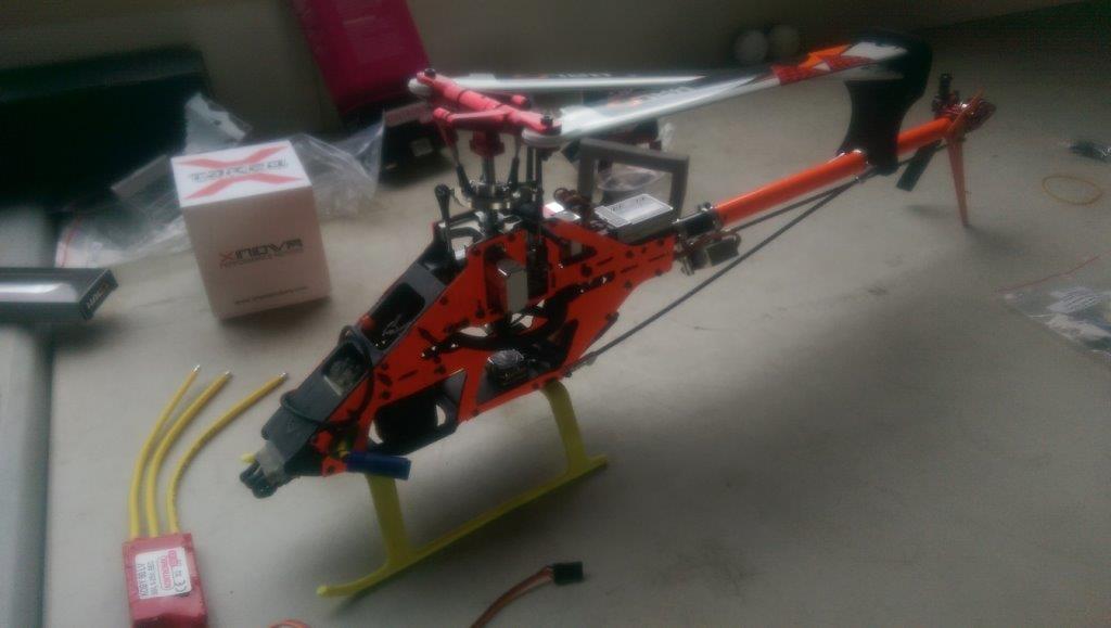

      Adjusting the tail again. Setting up the gyro and some final adjustments......
      OK we are ready to maiden Official time is 4 hours and 29 minutes.
