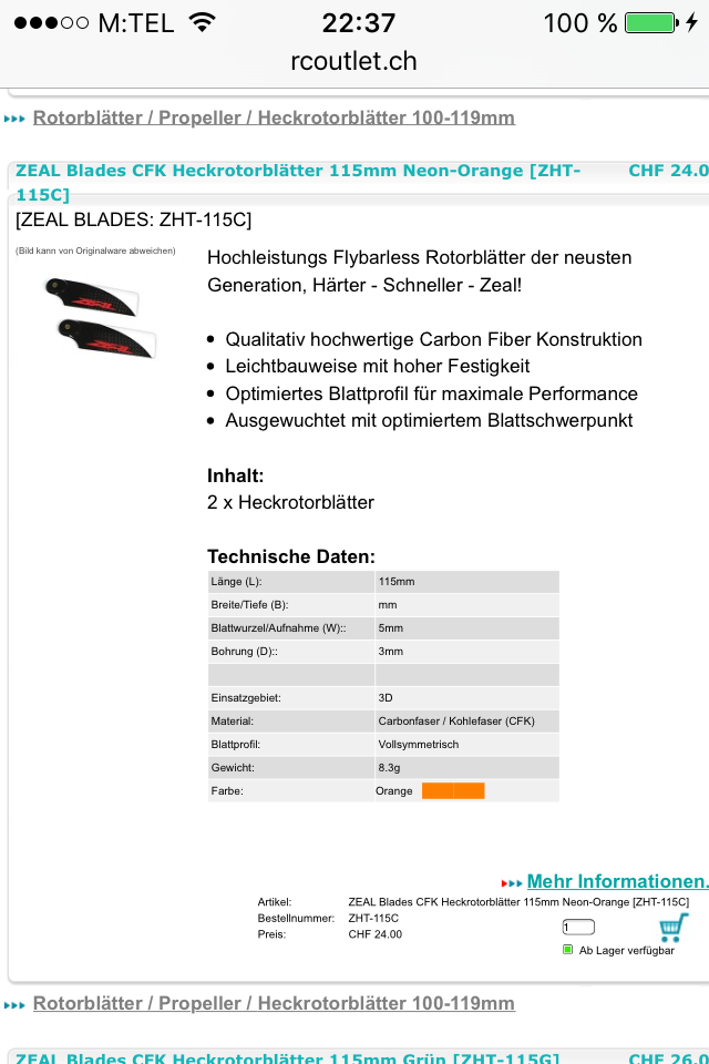

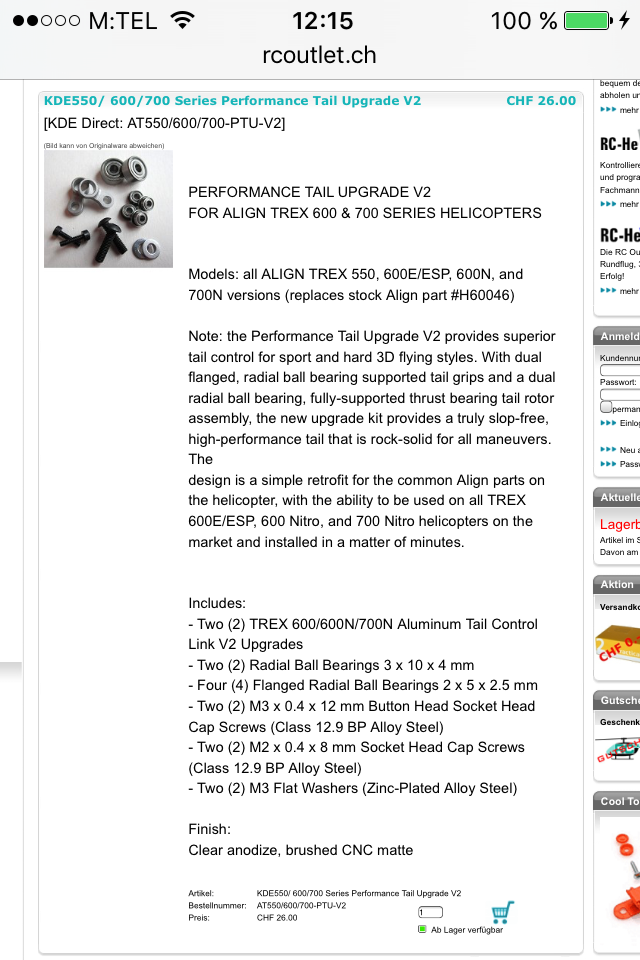

      I will get some bigger blades by the end of month. Im not sure if I should go with 110mm or 115mm. Both will fit without catching the main blades. 105mm have been in the combo. And there is a tail upgrade which makes sense (on the other hand my tail is allready running smooth):
