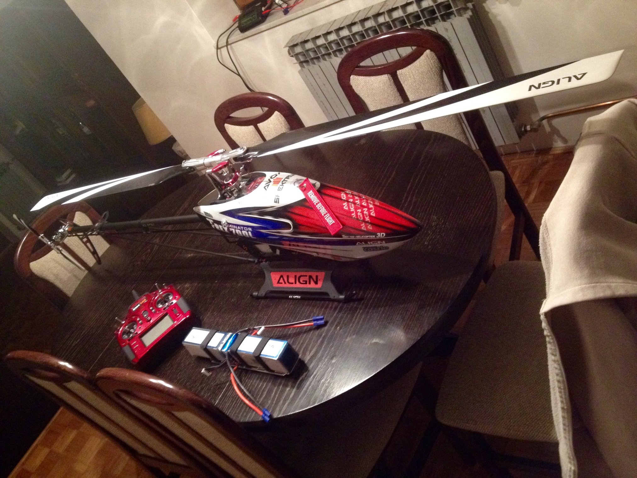

      Setup is done. I had to give more cyclic gain and response on the BeastX. Now I got that locked in feeling that I like. First time canopy on. The tail is straight. Lets say my first flight with a 700. Enjoyed it so much. Stability is great. 1950 RPM normal mode. Nothing more. :)

      AWESOME IGGY! Get out there and fly fly fly! The heli and the tranmitter combo looks GREAT!
      I know you had some issues (to say the least) with this bird, glad it's all go, enjoy my friend. Looks great. At 2150 you will love it even more...
