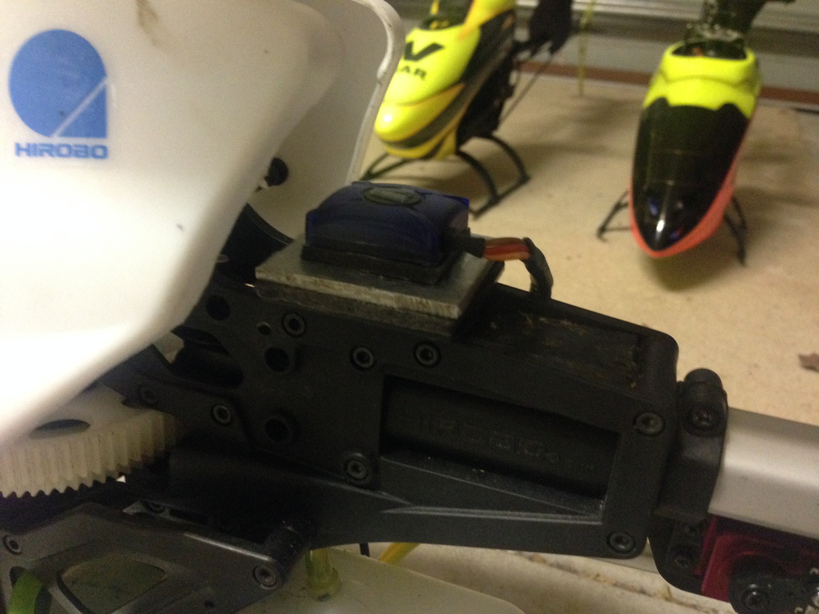

      This is what I have done with my gasser. You have most probably done this stuff, but this is for the wider audience.
      I started with the fundamentals.
      Cooling fan went onto the Dubro tru-spin. I kept making small dig outs / holes until the it spun perfectly without landing on the same spot when the cooling fan is spun on the tru-spin. In other words the cooling fan was balanced.
      The good old fashioned dial out indicator is a must. Although my helicopter manual specifies a runout of 0.05 millimeters or less, I aim for 0.02 or less. Its may seem like a pain in the bum exercise, but its fun to do once you learn how to. And you can get a cheap dial indicator and base from ebay for a cheap price.
      Also, sometimes it is possible to get a bent shaft or too big shaft out of a kit. It does happen, I once got a brand new too big diameter tail shaft from Mikado once. Nothing a bit of sand paper and spooling it up couldn't fix.
      Since its a new helicopter, it might be worth taking off the head, and tail blades, spooling the helicopter up, and see if the shafts all spin on the same spot etc. Could be faulty parts. Also what I have found, that on my internal combustion rc helicopters, the main blades have to be a bit looser than electrics otherwise they vibrate a lot.
      As for the gyro pads.
      This is what I have done.
      I went to clark rubber and bought a piece of vibration foam. Industrial stuff, and its super cheap.
      Next was the hardware shop, and I got a small piece of steel plate, 3 mm thick.
      On the helicopter, foam, metal plate, foam, gyro sensor.
