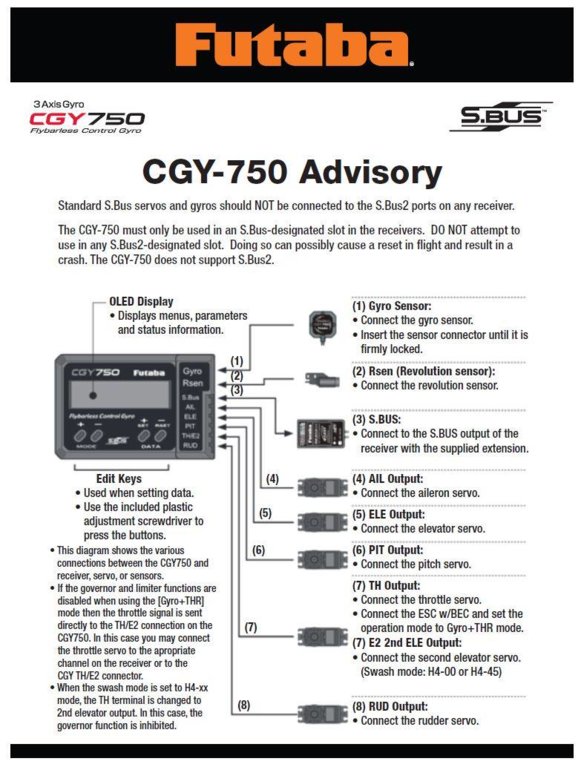

    VERY IMPORTANT INFORMATION - CHECK YOUR MODELS IF YOU HAVE A CGY750.
    Tech Notice for CGY-750 users!
    Standard S.Bus servos and gyros should NOT be connected to the S.Bus2 ports on any receiver.
    The CGY-750 must only be used in an S.Bus-designated slot in the receivers. DO NOT attempt to use in any S.Bus2-designated slot. Doing so can possibly cause a reset in flight and result in a crash. The CGY-750 does not support S.Bus2.
    If you have any questions, please email Futaba Support at support@futabarc.com.
