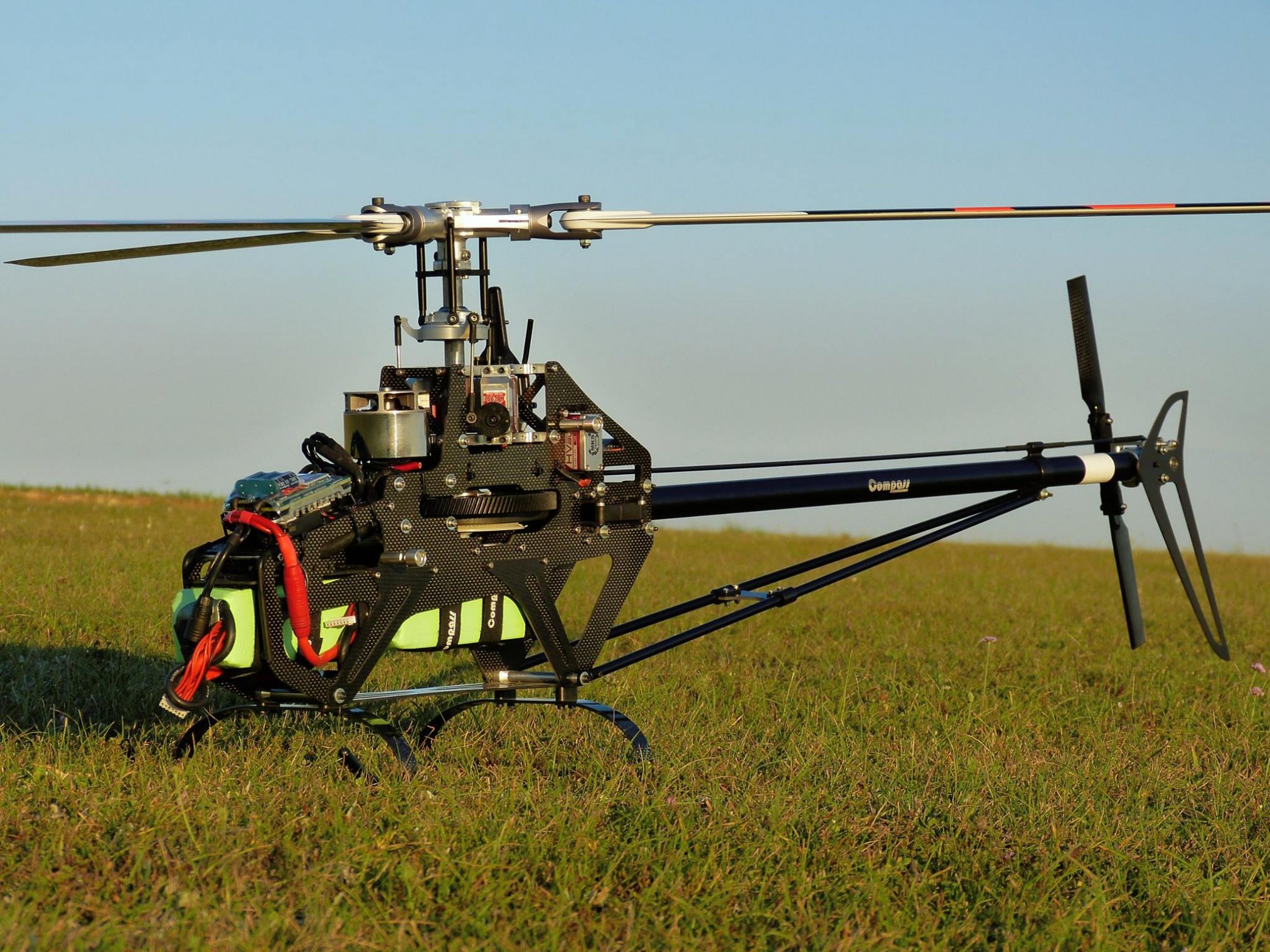

    4. ChopsyWA
      Thanks Micky,
      Couple of questions to overcome doubts:
      There is a bit of mention on Helifreak how everyone seams to be running 690 size blades instead of 710+, and that 715mm blades is a general no go. I have plenty of 711 and 715 blades, so would want these to be suitable - will 105mm tails hold with these mains and have safety room? Or are the comments on HF coming from safety sissies that speculate without really knowing from experimentation...
      The manual mentions it will go higher, but they recommend a safe max of 2200rpm... Are you consistently running higher? At least 2300rpm?
      Spares seam a bit pricey for an Asian manufactured heli, like the $56 main gear, without crashing is it relatively cheap on the consumables (dampeners, thrust bearings etc.)? I know I got expensive helis, but this would be a 700 size beater.
      I am already running 14s on Banshee and the new helis coming, so would set a Chronos up on 14s too. Though, after looking at some 12s setups on HF - it is sounding bloody heavy to go 14s. How do you think your Chronos would go with the extra weight of 14s packs, kosmik 200 and a 4535 motor? Alternatively I have a pyro 800 Dekker re-wind as my smallest motor on the shelf ;)
      Any word of a future boom wrap for it, an option to get the visibility up?
      I know the industry is shiz ATM, but the kit price is getting up there @ $1299. Do you know if @Dean has room to move for a deal?
      Cheers for now ;)
    5. MickyD
      MickyD Well-Known Member
      292
      Thanks Micky,
      685mm-716mm and 105mm with no issues what so ever in hard flying.
      Its there as safety as most blades cannot handle more. So check your blades specs. I mostly run at 2100-2150 but flew for the first time at 2200rpm. The heli is super super agile at that rpm, had to lower pitch. Most run 2150 and it a monster.
      Spares seam a bit pricey for an Asian manufactured heli, like the $56 main gear, without crashing is it relatively cheap on the consumables (dampeners, thrust bearings etc.)? I know I got expensive helis, but this would be a 700 size beater.Its a full derlin machined gear, it wont strip in flight unlike some and if you have trigger finger it wont strip in a crash. Adam was proof of that as he crashed his on sat. hehe. It's still cheaper than any other machined gear. In addition you wont have to replace any other gear in the drive train since its a belt drive.
      I have no experience with a 14s setup. I have seen some flights on youtube, looks super light in the air. It lighter than Mikado 700 extreme.
      Not sure on that one. Was talk to make a stretch for it. You can talk directly to the German designer on messenger.
      I'm sure dean will look after you, give him a buzz ;):cool: dude 0448 014 795
      P.S If using it as a beater some points to consider;
      easy to work on! Can remove main gear without touching boom and belt.
      Can remove tail assembly without touching boom tension
      Split frames, cheaper to replace frame $59.99 compared to $100+ Has four parts to frame :)
      Designed to protect expensive electronics and lipos in a mishap.
      cheers :p
