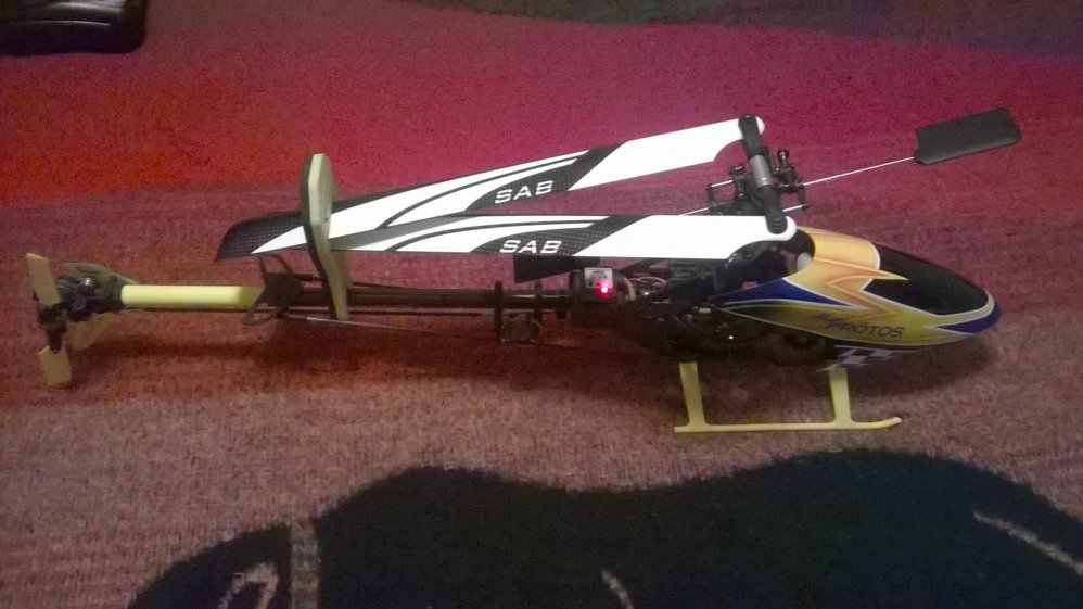

    Done deal! I finalized payment on my stretched Mini Protos airframe..... my first real non-clone heli, and only $150 with SAB blades, and some aluminum upgrade parts! It should ship tomorrow. I've already been reading up on things and looking for parts at various online sites. This bird won't be in the air immediately as I plan to get better quality electronics for the thing, which may take a few weeks or so.
    Next stop- download the manual and do more reading. :D:D 20160806_181311.jpg thumb-20160806_181329.jpg thumb-20160806_181404.jpg thumb-20160806_181416.jpg

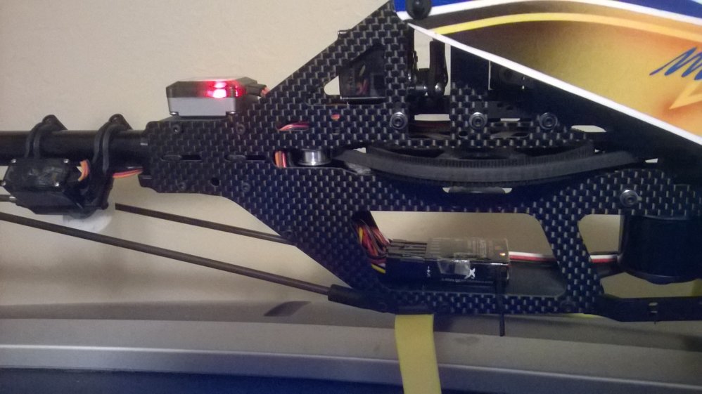

      It's in one piece again.... finally. I put the fly-bar head on it for now since it may be a few more weeks till I get a Brain (no pun intended). Thankfully, there was a complete set of parts for the fly-bar head assembly. I love that there is zero slop in any of the links.
      I did discover that 12t is the absolute smallest pinion that will work and still be able to properly set belt tension. For now I will run my best 3S motor until I get everything I need to go 6S..... mainly 6S packs and a new full function charging station so I can properly maintain the packs.
      I have yet to fit servos, Rx, and ESC, but will probably get that done this evening. :D
      Wow.... learn something new everyday. I didn't notice that the motor mount plate was adjustable and that belt tension is set at both the motor and tail. Go MSH! :D
      Yes, this belt tension is critical... not too tight, not too loose. The slack (around 5mm deviation pushing in from front of belt and rear) shoud be roughly the same.
      Yeah, I figured that out @smakmeharder . There has to be equal tension at each side of the main gear (fore/aft) or it loads the belt incorrectly and makes excess friction.
      ..... otherwise, bird is ready to fly. I'm impressed with how clean the thing looks. Even the wiring practically fell into place due to the arrangement of the frame. :D WP_20160902_002.jpg WP_20160902_003.jpg
