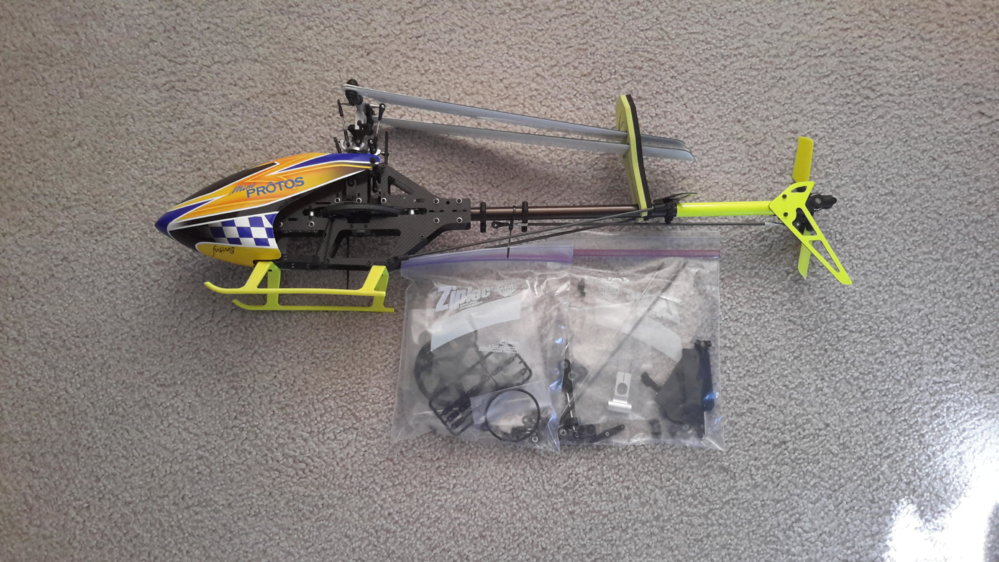

    Done deal! I finalized payment on my stretched Mini Protos airframe..... my first real non-clone heli, and only $150 with SAB blades, and some aluminum upgrade parts! It should ship tomorrow. I've already been reading up on things and looking for parts at various online sites. This bird won't be in the air immediately as I plan to get better quality electronics for the thing, which may take a few weeks or so.
    Next stop- download the manual and do more reading. :D:D 20160806_181311.jpg thumb-20160806_181329.jpg thumb-20160806_181404.jpg thumb-20160806_181416.jpg

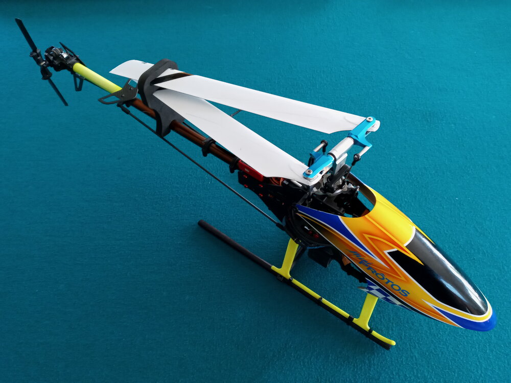

      This bird is back in the air. I finally killed the plank I'd been flying daily for the last month, so I decided to take a break and go back to heli for a minute.
      I had to use Align 450se style aluminum blade grips, the original plastics perished in the (first/last) crash. The rest of the bird is mostly original aside from electronics and blades. I thought the Ikon 1 Fbl went to brick, but was able to revive it with a firmware reboot.... good thing, as I didnt want to use a K-bar on it. I've been unsettled on power system first few flights since re-fit. I'm currently running 3S/4S on 3500Kv/ 600w/ 45A Esc/ 11/120 main. I have separate radio profiles for 3s and 4s with throttle curves dialed-in accordingly to keep head speed reasonable, and have been getting over 6 minute flights.

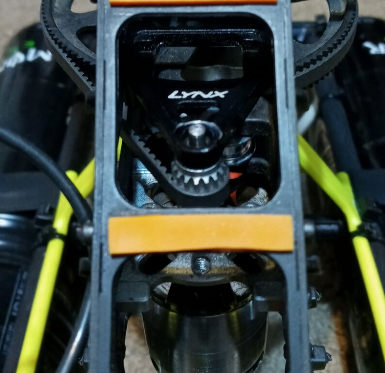

      6s is next on the list pending a replacement shaft for the msh/scorpion 1300kv. That motor will swing an 8×4.5 prop at 4S with no problem, did the math, cant wait to get it back in service on the MiniP.
    14. Beaver
      As if fate had intended, I stumbled upon some 4mm hardened rod stock in the form of an old broken screwdriver. With some creative engineering, I was able to machine a new shaft for my 6S MSH motor, that which I acquired from a reputable member of this forum.
      Of course the motor is assembled and tested in the Mini almost immediately, with perfect results. All bearings are interference fit even up to the shaft support.... like new.
      11 minutes at 4S/3200mAh at a flying weight of 1170 grams (~2.5 lbs) with pontoons and camera installed. Not bad for endurance, but head speed seems to be a bit lower than calculated at nominal voltage.

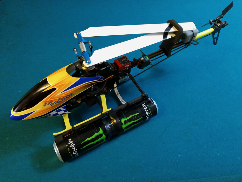

      Very quiet and practically no vibration showing in the video. 20201105_005144~2.jpg 20201105_010206.jpg
    15. Beaver
      Pontoons removed, point proven, don't like the weight
      Camera relocated back to undercarriage.
      1300Kv motor working perfectly.
      3S power test, 13 minutes... Low head speed but smooth. good for video and lazy flying.
      4S power test 11 minutes... Good enough for everything else... for now.
      Timer set to 8 minutes, safe flight envelope established per current power system.
