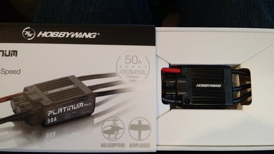

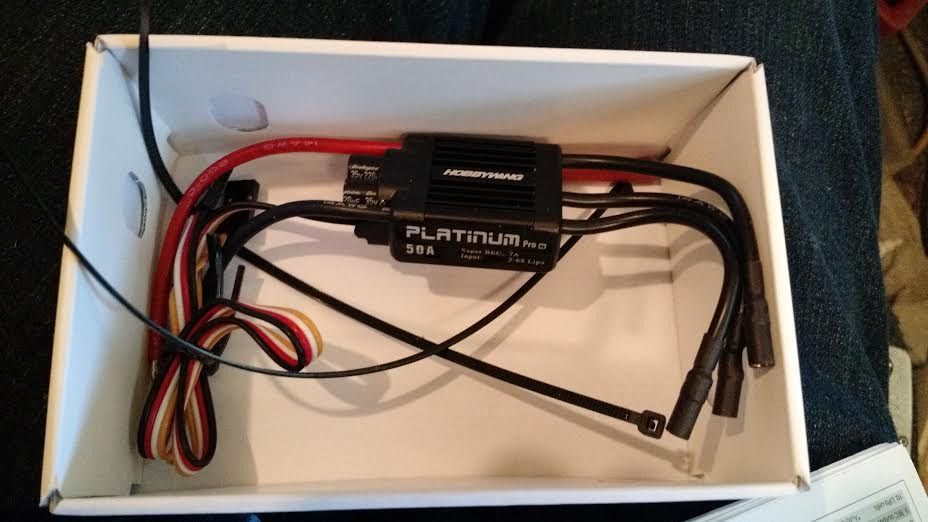

      309.png Well, I got my HobbyWing Platinum 50AMP ESC in today. Very nice looking ESC to me. Plenty of air ventilation on the underside and on one side of it. Comes with a very large a drawn out manual, 2 heat shrink tubes, and 2 zip ties. And some Chinese newspaper if you want to read the news in China.
