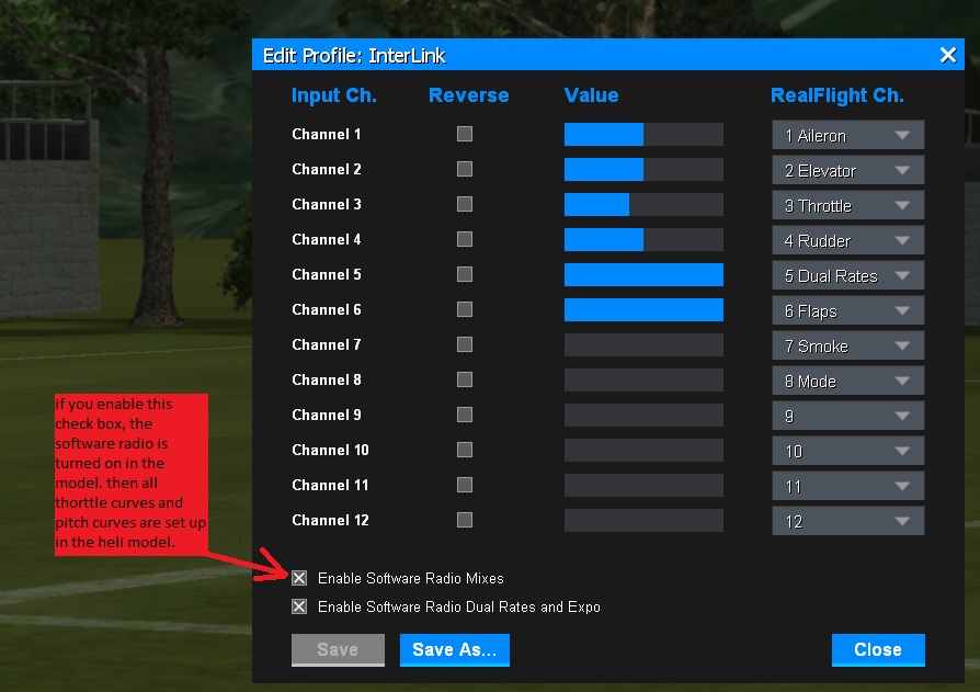

    Hi all,
    I have recently changed over from Phoenix to real flight 7. I have the version with the interlink elite controller and for the life of me I cannot work out how to adjust the expo on the sticks.
    Your help would be greatly appreciated.
    Cheers and thanks in advance.
    MickeyZ

      Expo can be adjusted in real flight. each model has a "software radio". in it you can adjust expo, curves, dual rates and what not. in RF7, you can also disable the software radio and its expo from the controller selection screen..

      I finally got around to adjusting the settings this afternoon.
      Much happier how the heli's are flying now that I have a little bit more expo on Aileron & Elevator.
      Thanks Heaps Mate.

      i use my actual transmitter for reallflight and adjust all expo dual rates pitch curves etc from my transmitter
      You should check that there is no expo in the sim as well, otherwise you will have an expo + an expo giving an un-natural feel...
