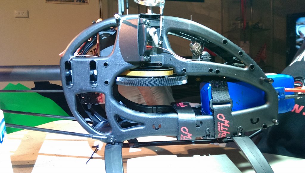

    Another project I'm in the process of creating I have cyclic servos and tail servo
    motor is going to be a scorpion/Mikado motor out of a friends old logo 600
    Just need a speedy might be a CC120 hv need to find out suitable pinion as I'm not sure.
    Here is where I'm at so far looking forward to flying this baby.

    3. 5Fidy
      Think it's Goin to turn out to be my favorite to mate. Also thanks for the advice about the pinion mesh
      I was very very efficient with my F's and C ' after the mesh was finally done. Just one more thing squigs
      with the herringbone how much back lash should I have or should it be no back Lash?
    4. mr_squiggle
      Find the tightest point around the maingear & set that for about 3/5 of 5/8 of f£#k all i.e. the tiniest amount of backlash & you'll be good to go.
    5. Min
      Min Well-Known Member
      324
      249
      The logo maingear isnt perfectly round. there should be no backlash in the tight areas and a little in the loose parts
    6. William
      William Active Member
      May 14, 2014
      278
      241
      Is that the KDE pinion bearing support thing?
    7. 5Fidy
      Yes I think it is
    8. Min
      324
      249
      looks like a mikado one to me
