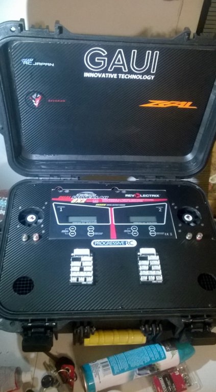

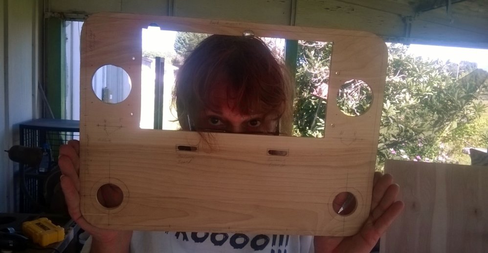

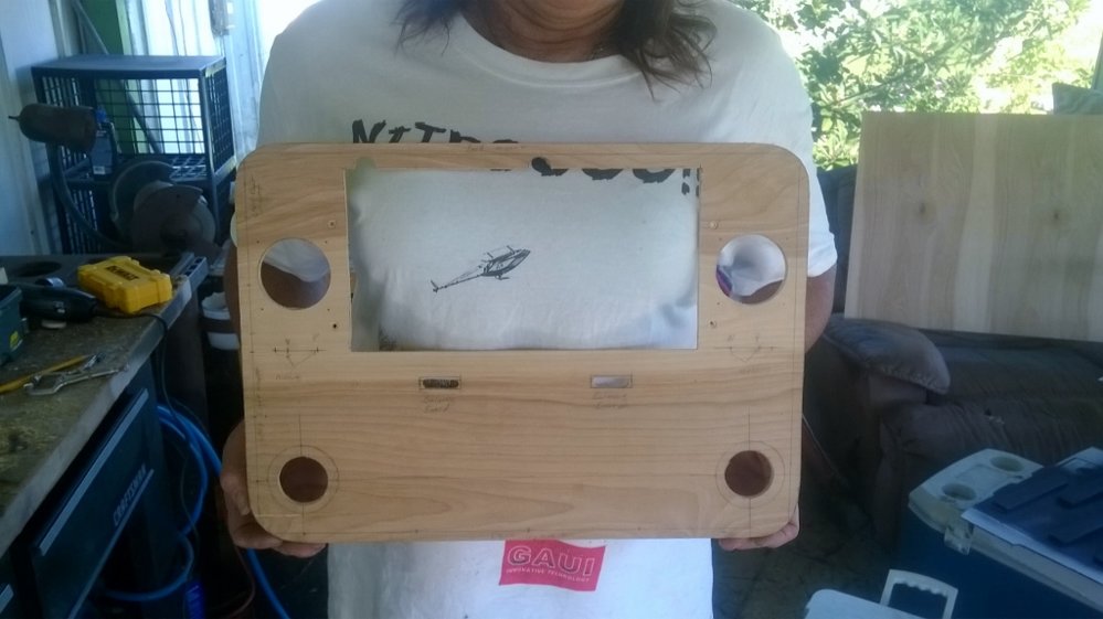

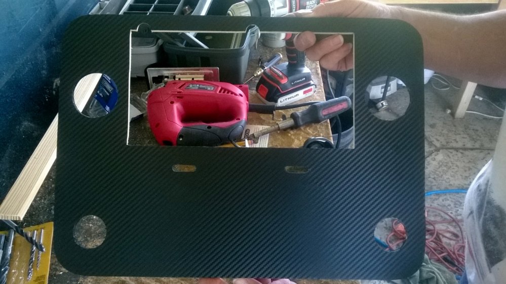

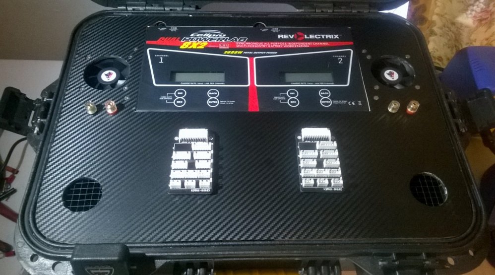

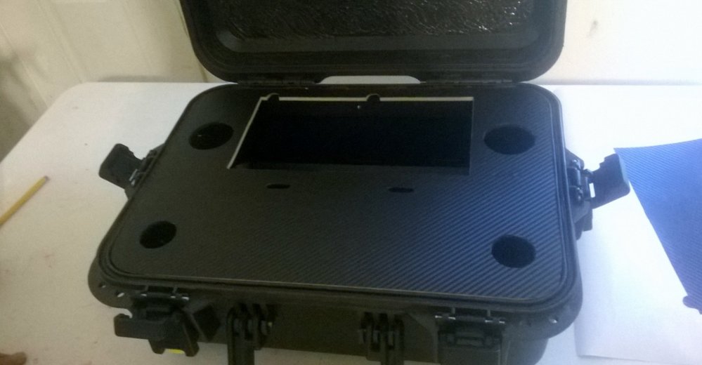

      Recently, my charger (a Dynamite Passport Ultra Duo) decided it has had enough. So I purchased an FMA PowerLab 8X2, and all the goodies and gadgets I needed to build a charging case. This is my very first ever attempt at building a charging case, but I think it turned out ok. Here are some photos from the start of the build until it was finished. I do have a couple of fan guards coming, and they should be here in a few days. :)
      WP_20161002_001 (1024x575).jpg WP_20161002_002 (1024x531).jpg WP_20161002_003 (1024x575).jpg WP_20161002_007 (1024x533).jpg WP_20161002_021 (1024x568).jpg
    8. simon
      Nice @Geena, nice
      What's the covering over the wood?
    9. Geena
      Thanks Simon. The covering is a self adhesive vinyl sheet that looks like carbon fiber. $7.99 for a 2' X 5' roll on Amazon. :)
      Well done @Geena! That looks very professional. How does the mains connect? IE is there a lead coming out the case or is there a plug to connect the mains to?
    11. Geena
      Thank you @smakmeharder. I`m really happy with how it turned out. The leads are soldered into those little nubbins sticking up from the deck, and just plugged into the charger with banana plugs. I thought about soldering the into the charger too, but I was worried about warranty voiding if I did that. I tested it last night, buy doing a couple of charge/discharge cycles on a set of 5200mAh 6s packs and all went well.

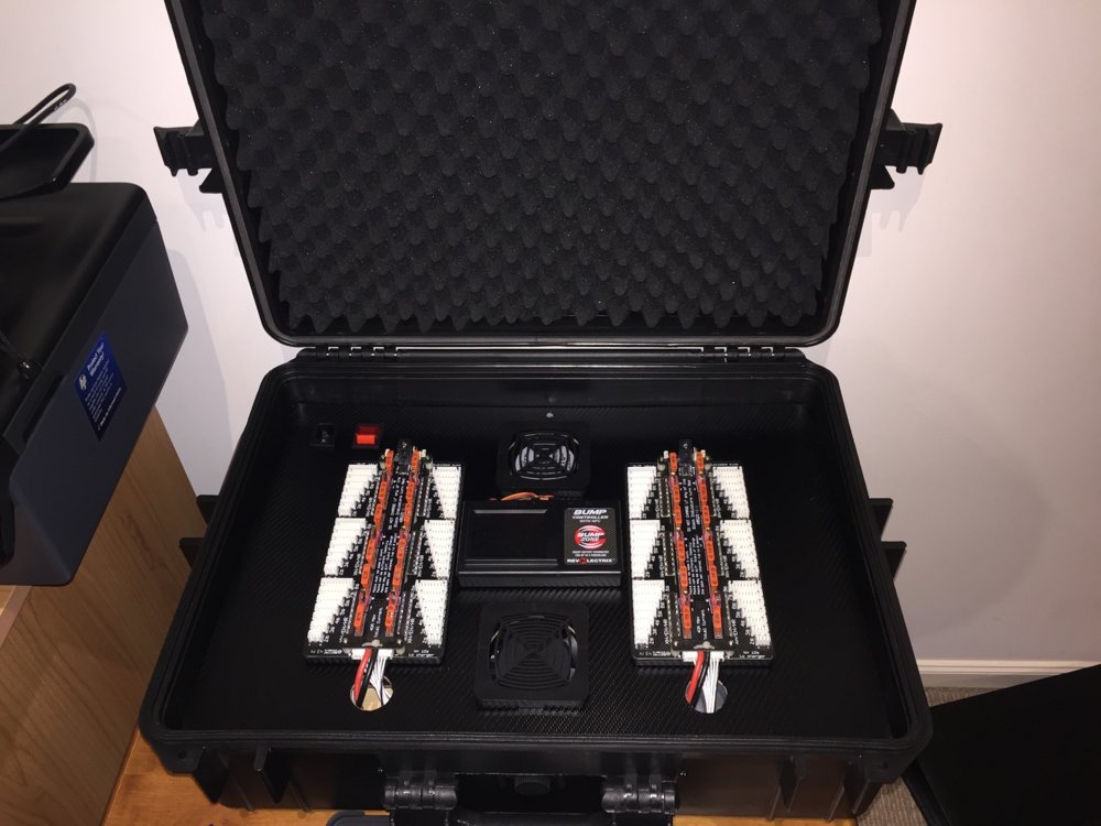

      Your case looks great Geena - appears you went down a very similar route to me.
      I've only just finished building my own case, using the following components.
      - Dual Powerlab 8x2
      - Bump controller
      - Dual MPA's
      - Meanwell RSP-3000-48
      - Cheap Bunnings case
    13. Geena
