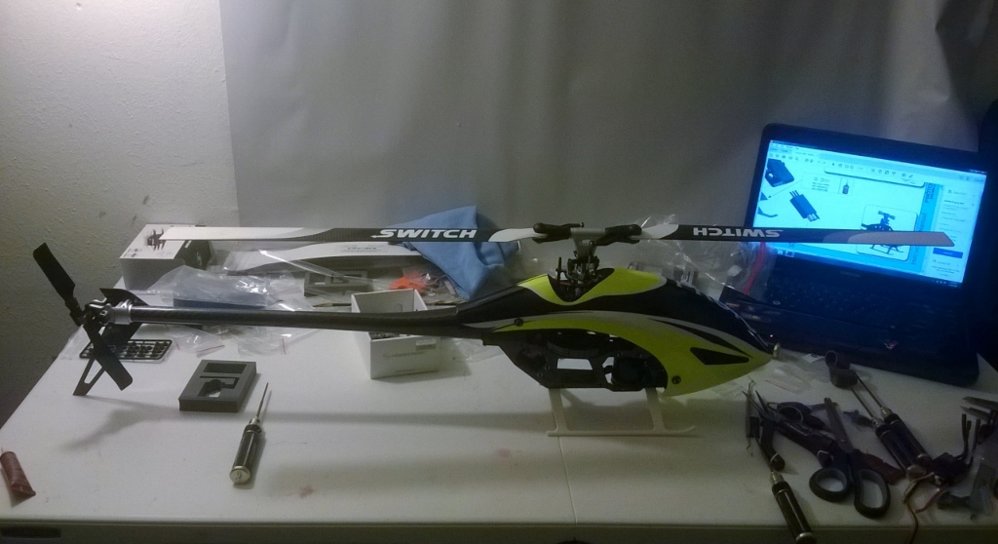

    Hi guys. I have been given the task by one of my sponsors, to build another helicopter for them. This one is the Protos 380. This little helicopter is really nice, and the quality is right on par with its big brother, the Protos Max V2.
    The fit and finish of the parts is fantastic, and the airframe went together quickly and without issue. The parts count on this little guy is low too, which means fewer things breaking in a crash...( sorry @Crash Heligod ).

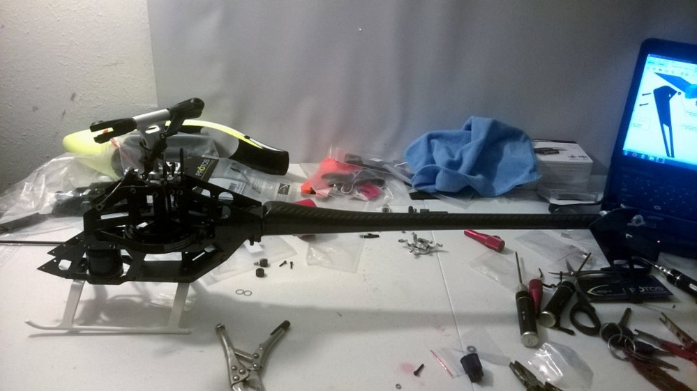

    All-in-all, I really like the Protos 380, but there IS one gripe I have with it. The mounting for servo 1 and servo 2 could have been thought out a little better. The both mount right behind the main shaft (just like the V2 Max).
    But on a helicopter this tiny, getting to the bottom servo mounting screws is impossible with the tail boom in place. So in order to remove servos 1 and 2 for servicing, the tail box has to come off to free the belt so the tail boom can be removed to access the bottom servo screws.
    Not that huge of a deal, but it means removing quite a bit of hardware, which could easily be lost if one were doing repairs in the field.
    Anyway, I have the airframe completed now, and the servos are installed. I just have to solder the Jeti MUI sensor, and battery connectors onto the ESC, update and install the mini brain, and set everything up.
    I should have it ready to maiden before this coming weekend, so be on the lookout for the maiden flight video.

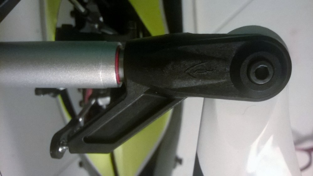

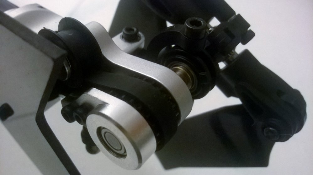

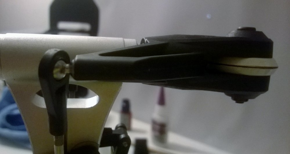

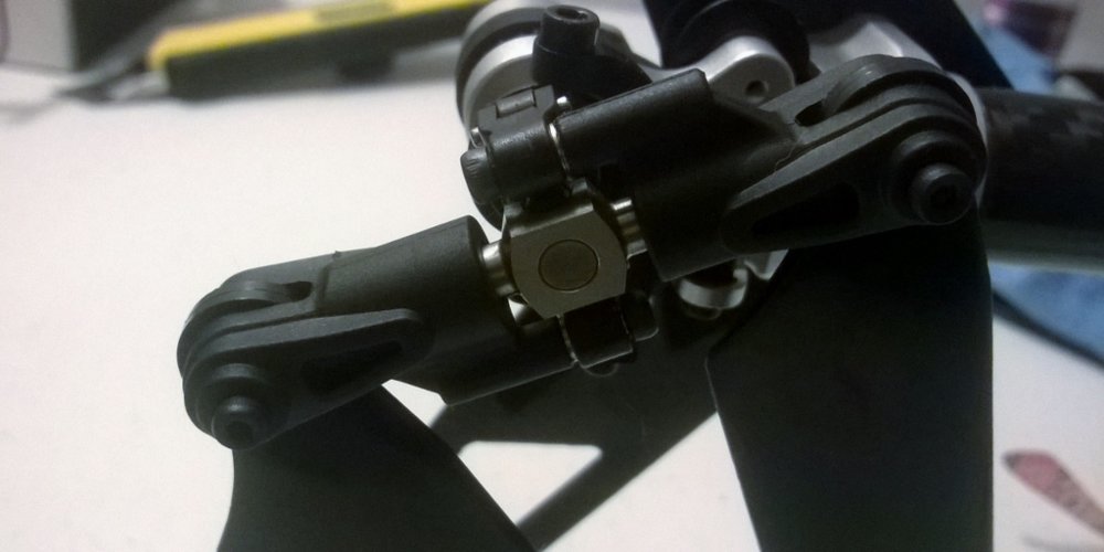

      Thank you @Geena, very nice indeed! Our first 380 build thread. How bigger battery does it look to be able to hold? Does it look like it can hold a number of different battery sizes? How solid are the leaver arms onto the blade grips. Do you think there is any room for flex?
    2. Geena

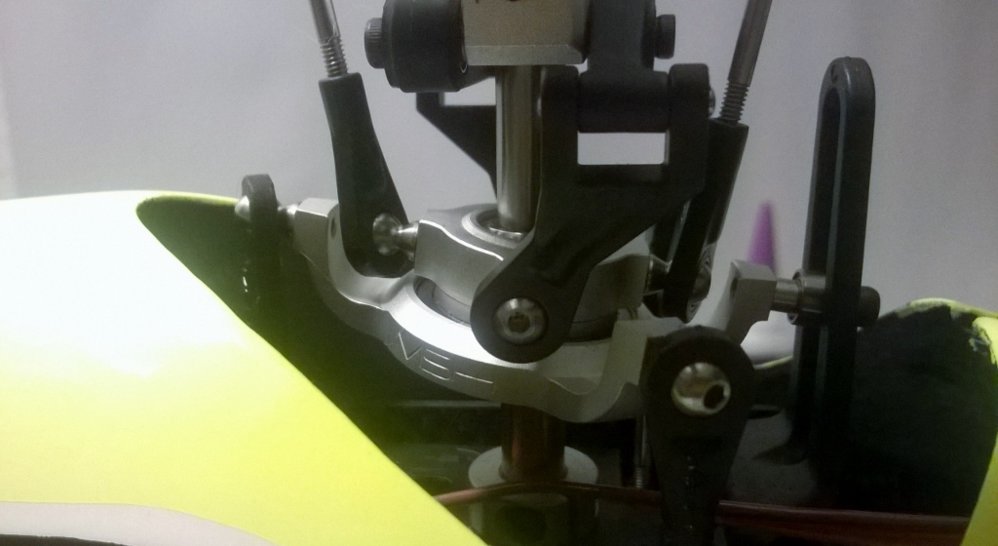

      It will handle 3-6s, and this one will be run on 6s. Probably 1800-2000mAh. I`m sure it has room for larger than 2000mAh, but it could mess with CG. He has no given the pack to me yet, so I will test it with one of the 6s 1500mAh packs I use in my Gaui X3. The pitch arms on the main grips will have zero flex. They are very stout, and should handle anything you can throw at it. Here are a few closeups of the tail box, slider, swash plate,
      WP_20160724_005 (575x1024).jpg WP_20160724_006 (1024x543).jpg WP_20160724_007 (1024x512).jpg WP_20160724_008 (1024x571).jpg WP_20160724_010 (1024x560).jpg and main grips.

      Oh thank you @Geena, that was one of my concerns with this bird. I loved the mini protos 450 but found the arms would start flexing after a while and the pogos became difficult to judge. Switching to the metal bladegrips sorted this problem out. However the plastic lever arms on the mains and tails do look to be capable. The quality looks to be nice - the drive belt looks to be quite capable to0 - similar in design to the goblin 380. Yes @Beaver having to do a comparison with some hot servos and high powered motor in both would be fun no doubt!

      I`m sure that metal blade grips will not be required on this little model. There is nothing weak about it at all, and it is super light at 900 grams. That`s with all electronics installed, but minus the battery. I won`t know actual flying weight until I get the flight packs from the owner of the helicopter.

      Oh.... one more thing. @smakmeharder....I beat the Protos like a redheaded step child, and those plastic blade grips showed NO signs of surrender. No worries there. :)
