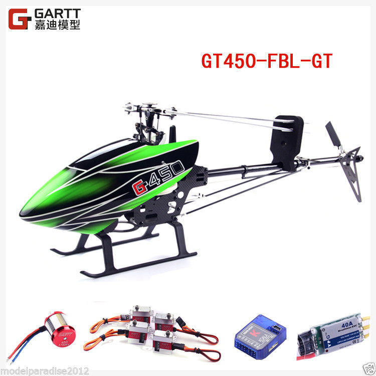

      Trigger pulled, it's not Assault though.... I couldn't resist for the price though. $35.99+ shipping.... Dammit EBay!! o_O Clone.JPG
      ..... now to start shopping for Tx, Sat Rx, 3S LiPo, etc. :D
      Wow! Congratulations and welcome to the 450 club! Well done, you gotta take a video when you fly please!!!
    16. Stuart
      Did you say $36 bucks for a fly able 450 heli.. That's insane.. Get 10 of em and just throw them away after a crash..
      Congratulations .. Keen to hear how it flies..

      Hmmmmm this looks very very tasty @Beaver!

      It's supposed to be in kit form with KST metal servos, blue Kbar FBL, generic motor and ESC. Ended up being $55.98 with shipping from China. I just got lucky to find this deal.... I'll see exactly how luck holds out when I lay eyes on it. Still need 6-channel Tx/Rx, LiPo, and a few Align parts to make sure its reliable.
