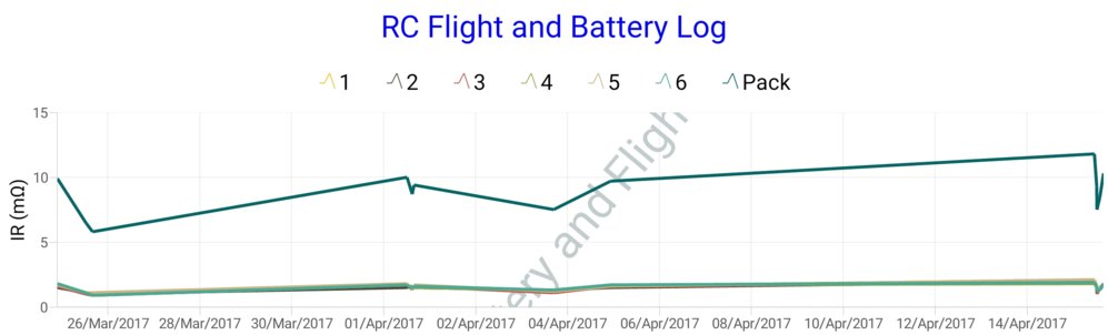

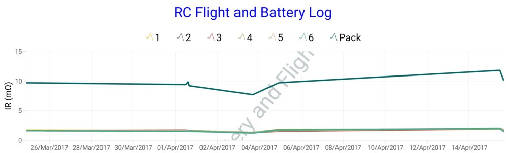

    A snapshot of internal resistance (IR) per cell and total calculated Battery resistance readings graphed are presented below for each of the two packs.
    Battery 1 - Graph
    Battery 2 Graph
    *most recorded ir readings were conducted after batteries were warmed up after 1 flight, slight deviations as per graph above in individual cell and total pack readings are due to occasion readings being undertaken during first charge cycle (typically IR readings in this condition are slightly higher.
    As you can see over the duration of use thus far 12 individual ir readings evenly spread (typically 2-3 readings per week) have been taken with the last reading corresponding with my 35th cycle of each pack. IRs have remained thus far consistently very very low at between 1mohm and 1.8mohm during charging and 1.6moh and 2.5mohm during discharge cycles. Slight variations between charge and discharge cycles is quite typical.

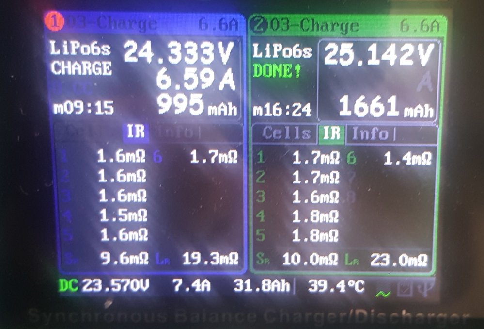

    Here is a shot of actual cell IR values following the 34th flight and during 35th charge cycle:
    Batteries are naturally charging up perfectly balanced after 35 cycles also.
