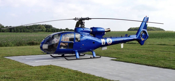

    Full Size Helicopters
    With the full size, if you attempted to lift a Heli by its blades they would fail – the outward pull from the blades when rotating is many tons and far exceeds the mass of the fuselage which is being lifted. The centrifugal force straightens the blade from the drooping position and provides the ‘strength’ for ‘lift’. It is for this reason in areas of extreme weather, parked helicopters have their blades tethered to the ground or back to the fuselage to avoid the wind lifting the blade and causing damage.
    Many tons of outward pull on blades cause them to straighten when flying and far exceeds mass that is being lifted
    Blades in Stationary position - obviously
    FULL SIZE HELICOPTER

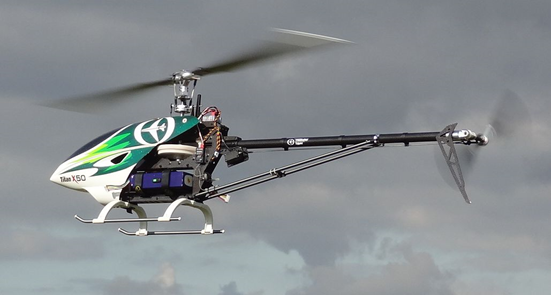

    RC Model Helicopters
    The description above for full size Helis equally applies to our models. With the blades stationary and even though rare these days, if you lifted a Heli with timber blades they would most likely break. With Carbon or fibreglass blades, if you were silly enough to try you would risk causing delamination within the blade.
    But when the blades are rotating, the same physics are involved as with the full size. The outward pull of a single blade on the bolt holding it to the rotor head can be as high as 200kg (more than enough to lift any one of you) and the tip speed is in the order of 190kph. Now while the maths may vary depending on model size and rotor speed etc – you get the drift.
    Without wanting to scare anyone or meaning to put you off our hobby all together, it really is like flying a chainsaw!
    Tip Speed Approx 190kph
    When flying outward pull on blade approx 200kg
    RC HELICOPTER
