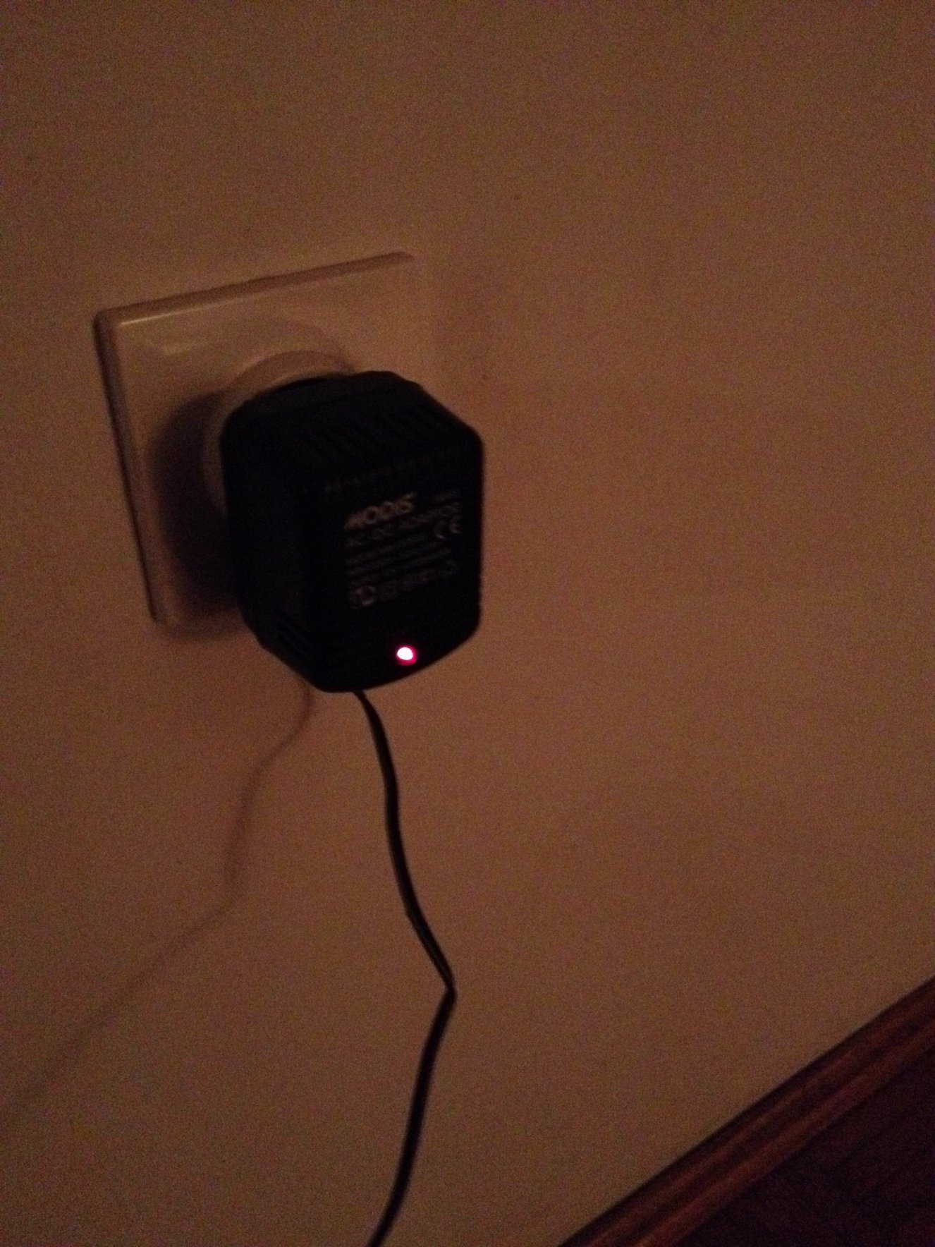

      Problem solved. I want to let you know the solution. It was up to the wall wart. We measured the voltage. It wasnt constant anymore. It gave 13-14 volts up and down all the time thats why the LED was flashing blue and charged only to 7.5V very slow. Soldered the original Jack to a 12V 0.5 amps wall wart and thats it. I almost ordered a new lipo for my DX18. Almost! :)
