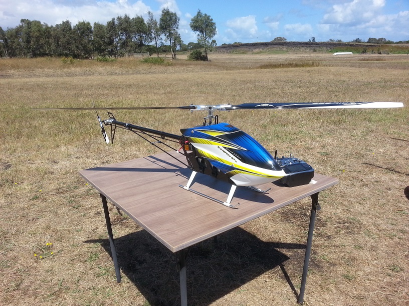

    - Ok I have flown it for a while now.. and I can say its a very nice heli to fly... handles wind nicely and with the rail blades just seems to track... it feels like a very deliberate heli, it goes where you tell it. Yes that also comes into play with how you setup your FBL, but it feels very different to the TREX I had all this on previously.. The tail at the higher ratio is awesome.. it does not miss a beat, I did a speed run backwards into 50km winds and pulled a power loop, and the tail held.. cant ask for more than that...
    This heli is not the cheapest, but goes together well, and from my personal experience flys well. The hold up in the past has been local parts supply, but it seems that Arkrc are now keeping up with the parts.. with that I would not hesitate to recommend this heli. For someone who has never built a heli, it will be daunting.. but once going appears to be rock solid.

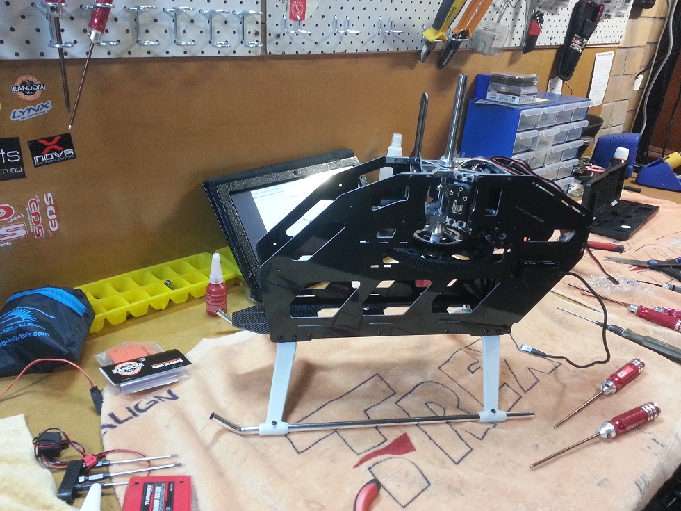

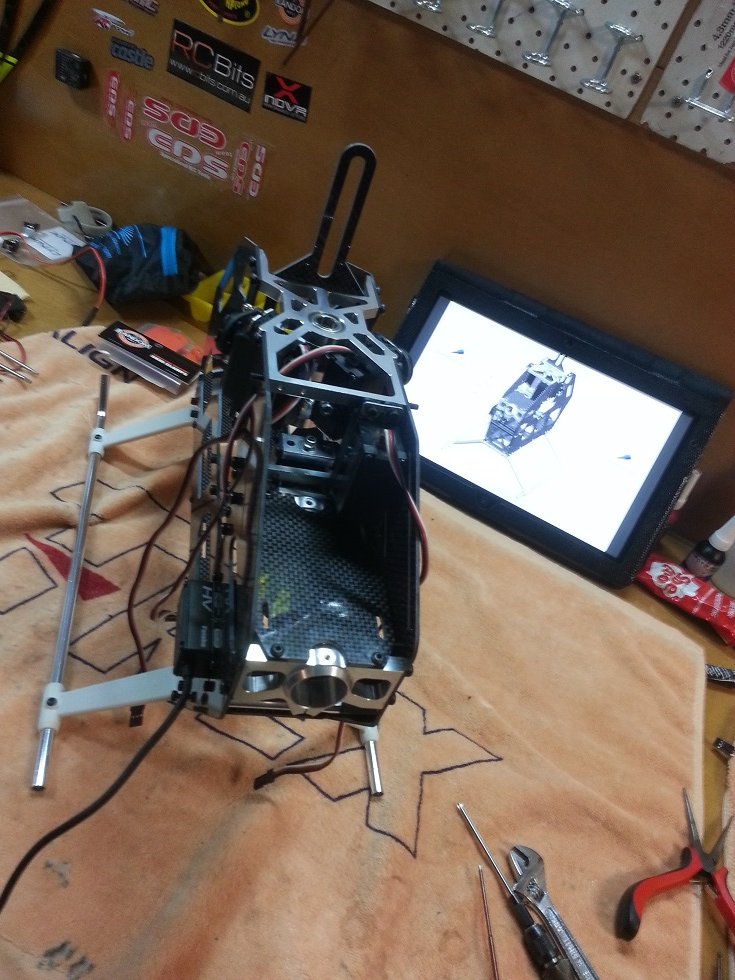

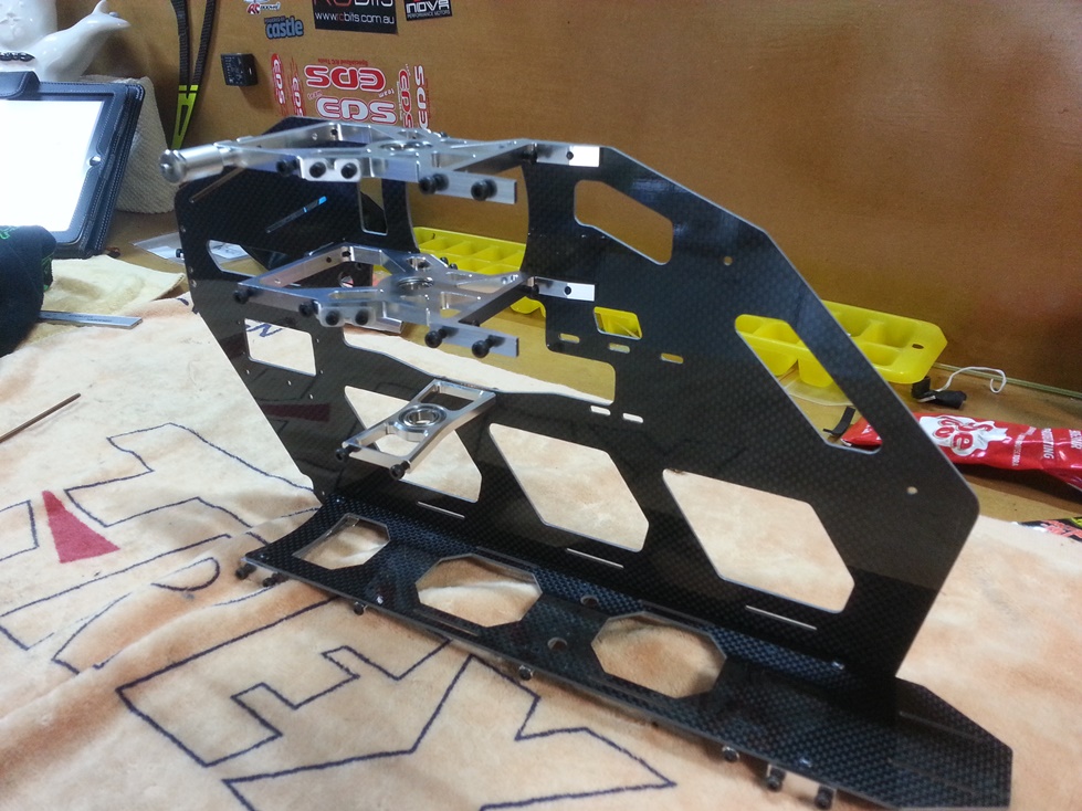

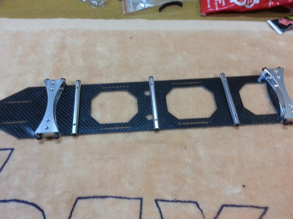

      The base plate not much to say...

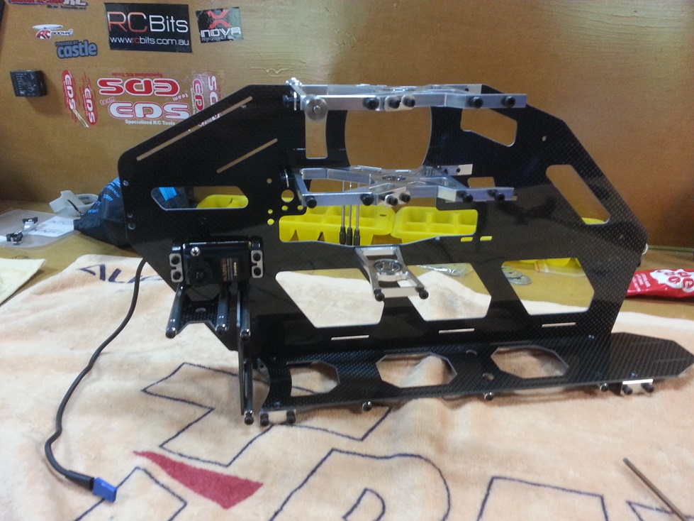

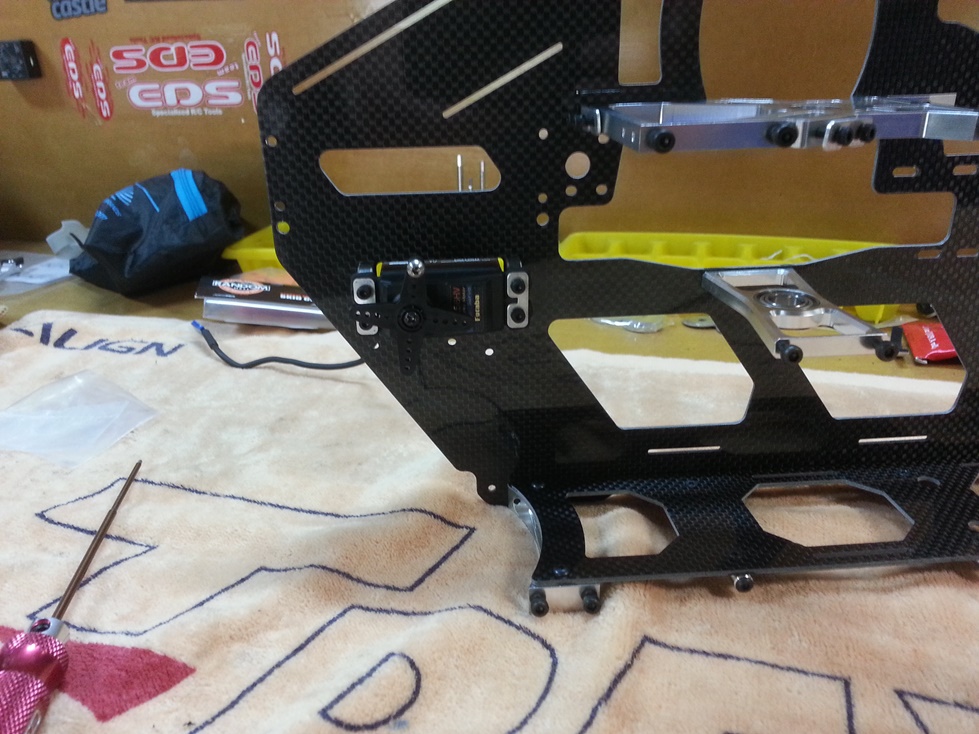

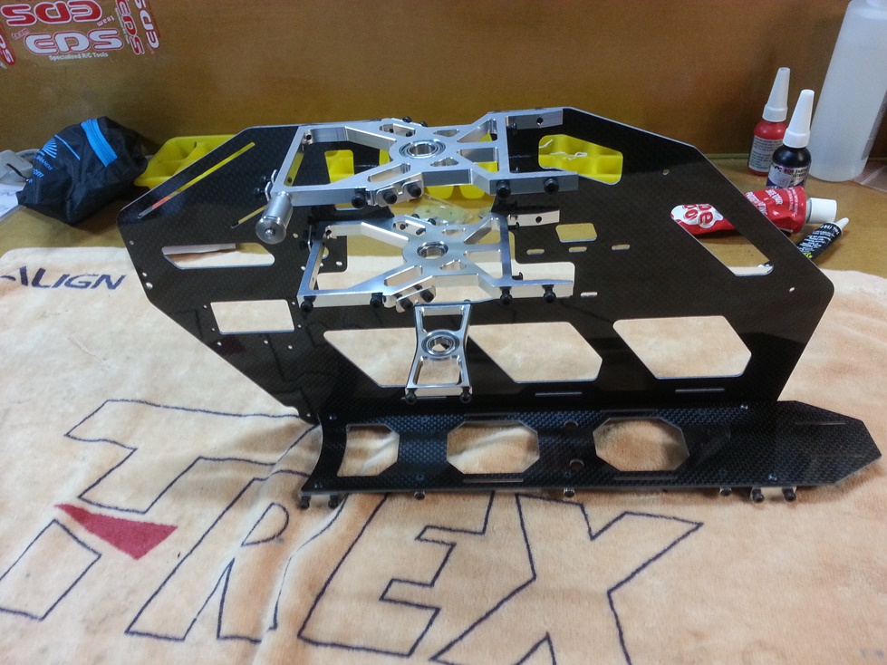

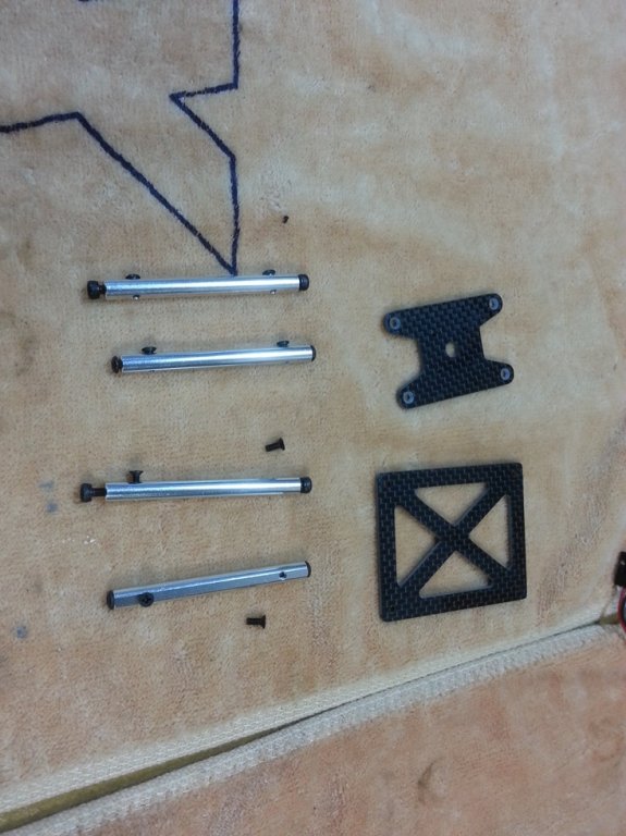

      Main frame... this goes together very easily.. and I really like having the screws already in the parts so you know exactly where everything goes... I also like the 3rd bearing is slightly elongated, so it can float a bit allowing you to get the frame straight, so the mainshaft just drops through...
      When doing the frame, dont loctite yet, leave everything a bit loose.. it will make sense later...
      With that you need to put together the sensor plates that sit at the back..

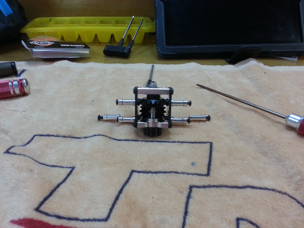

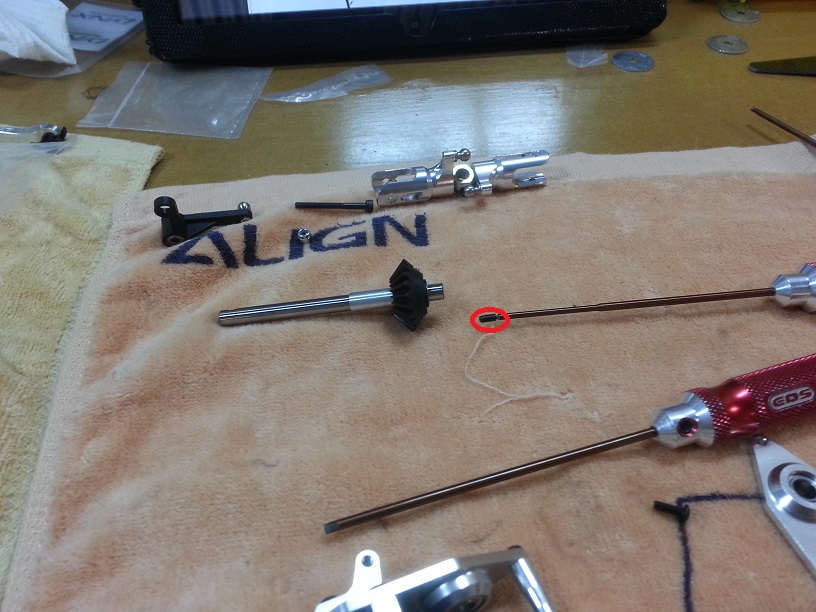

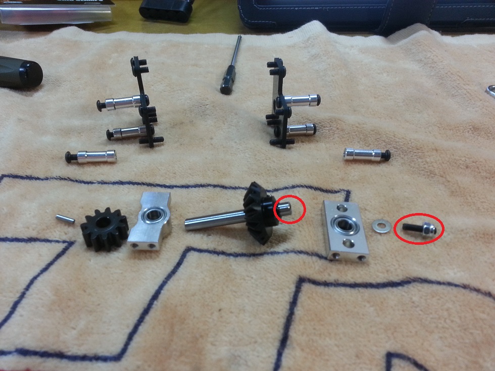

      Now for the transmision for lack of a better term.. these are all the gears for the torque tube... keep in mind you will need to pull it all apart, loctite and re-assemble.. its an easy processes.. just make you loctite the set screw, or your in for a bad day...
      Take note of the red circles.. thats the set screw, and where it goes in.. LOCTITE it...

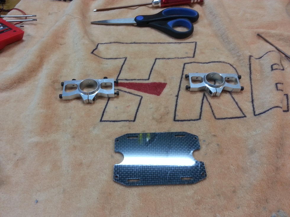

      ok.. I've kinda changed the build order from the manual a bit, mainly because I haven't soldered my motor and could not be bothered doing it last night... Also the manual just forgets to mention the anti-rotation bracket.. just appears on the pics as installed.. its not hard.. just keep an eye out for it.
      The back plate.. pretty simple...

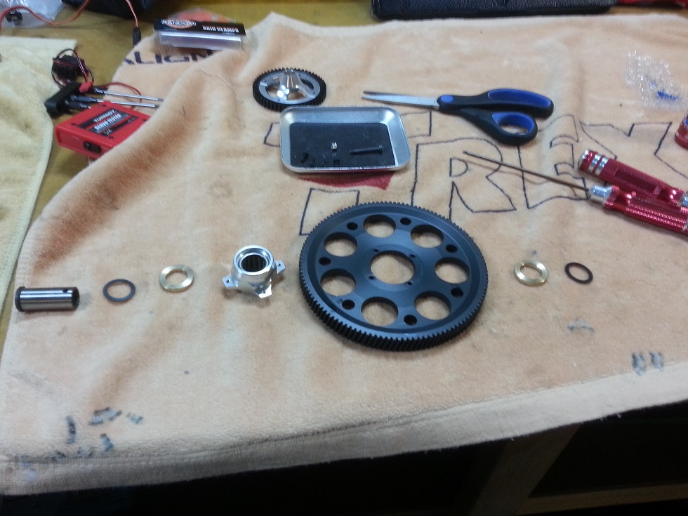

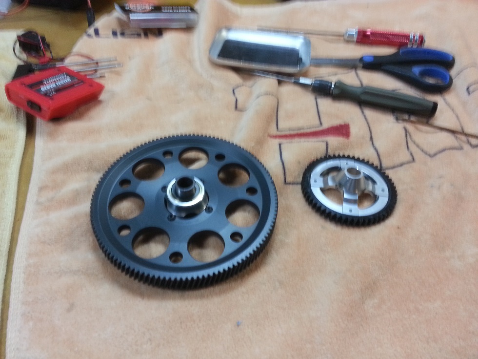

      Next I worked on the main gear... you need to pull this apart, loctite the screws.. use red/green loctite on the brushed spacers.. use oil on the one way.. not grease...
      Now put it in with there is a little spacer on the main shaft, sit it between the hub and the other collar.. should line up nice.. push down on the the collar on the top, and pull on the main shaft up so there is no up and down play...

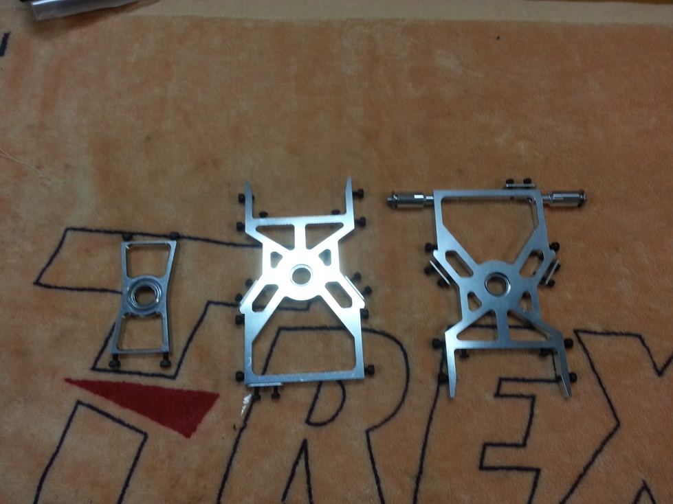

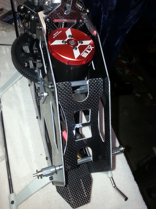

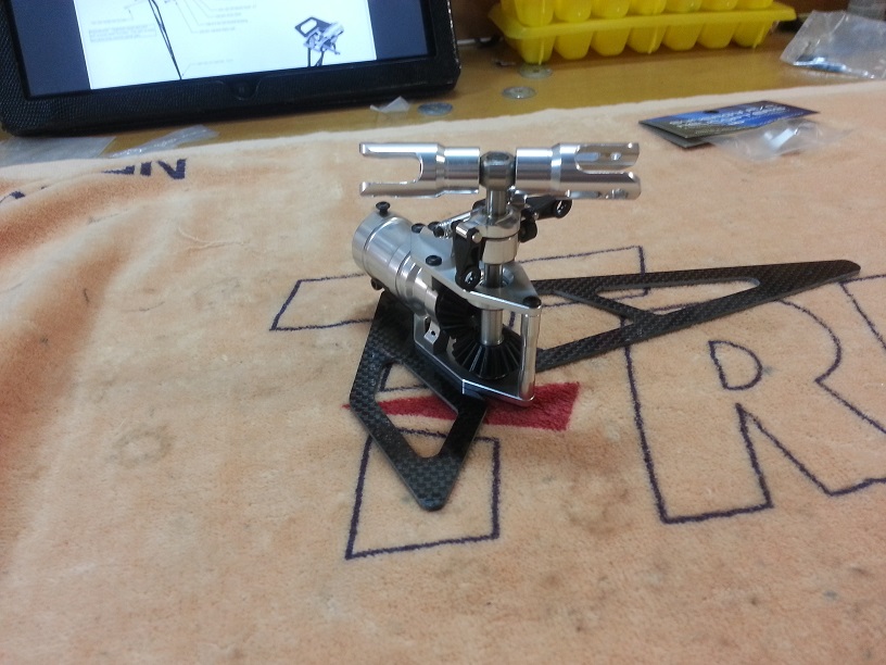

      Now you should be up installing the transmission front.. these have ever so elongated holes.. make sure to move the mount for the fore of the heli for proper meshing..

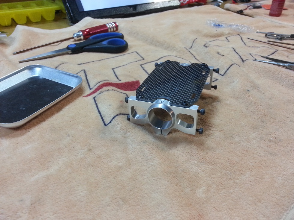

      Now build the boom mount.. no real info needed here... tho I would now mark the boom for pinning before you mount this part.. just put one of the brackets over the boom, slide it in till you see a slight ring of silver all the way round and then use a screw to mark the boom.. if you push it to close you may strip those gears..

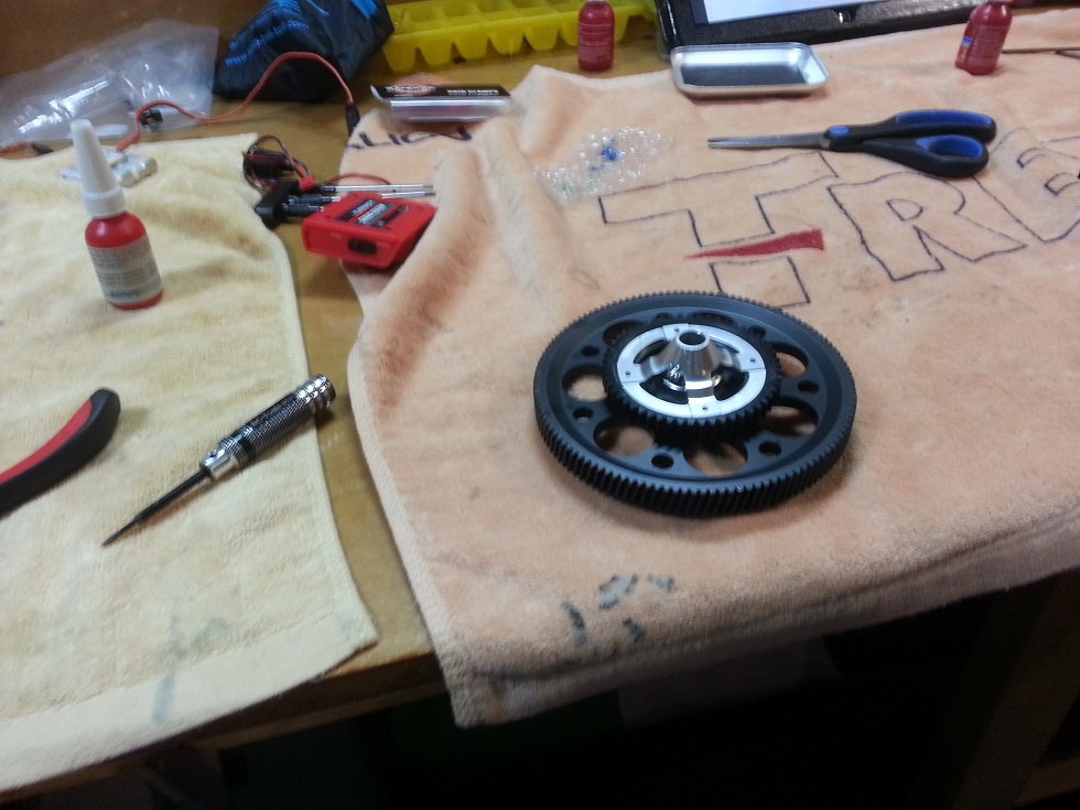

      next build the main gear, one way and auto rotation gear...

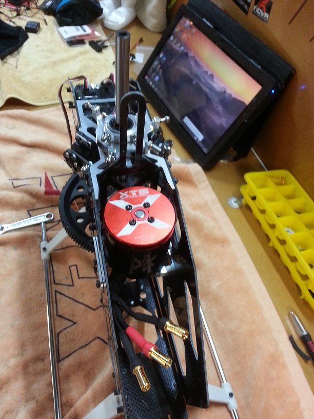

      Next mount the motor.. when mounting dont tighten the bolts just yet.. adjust the meshing.. I use a bit of paper to determine if its messhing fine... The paper should come out making the pattern of the gear mesh, but not rip or tear in anyway going through.. you should have a bit of play between them...

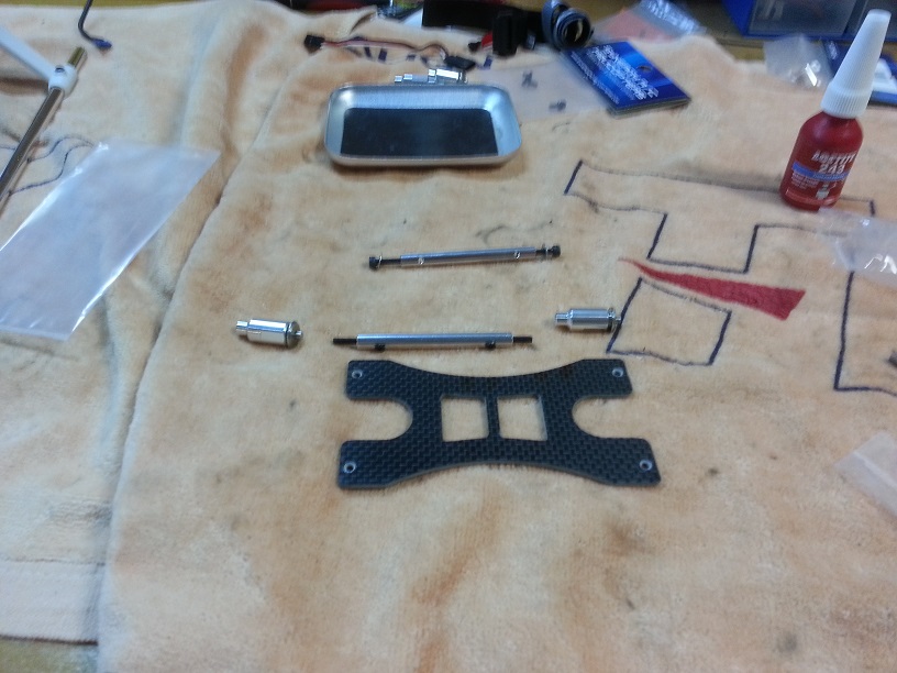

      Now make up the ESC plate and mount in the frame

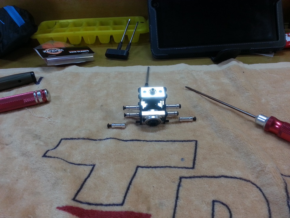

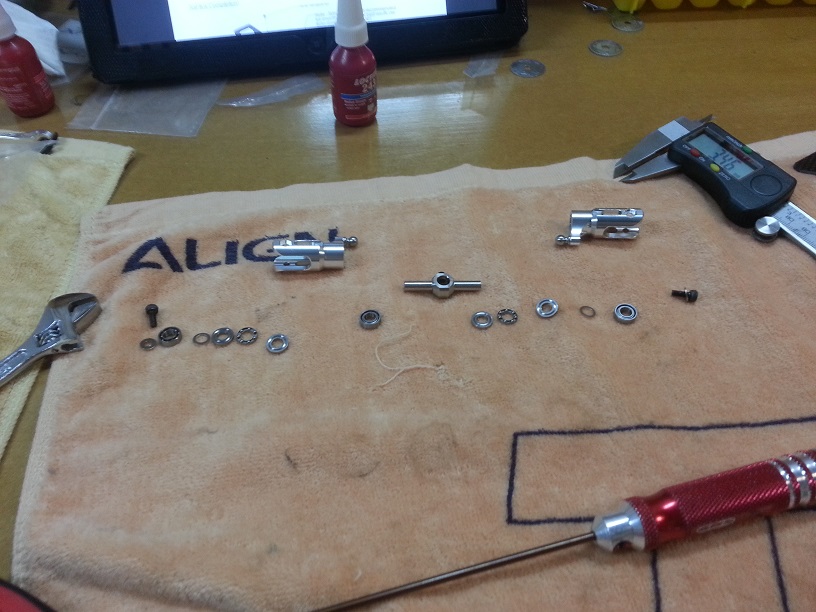

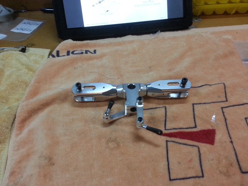

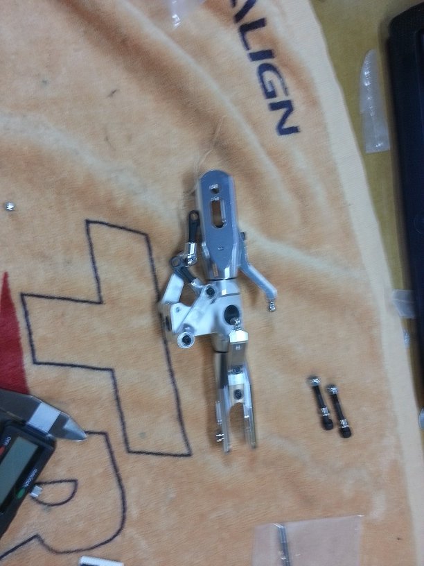

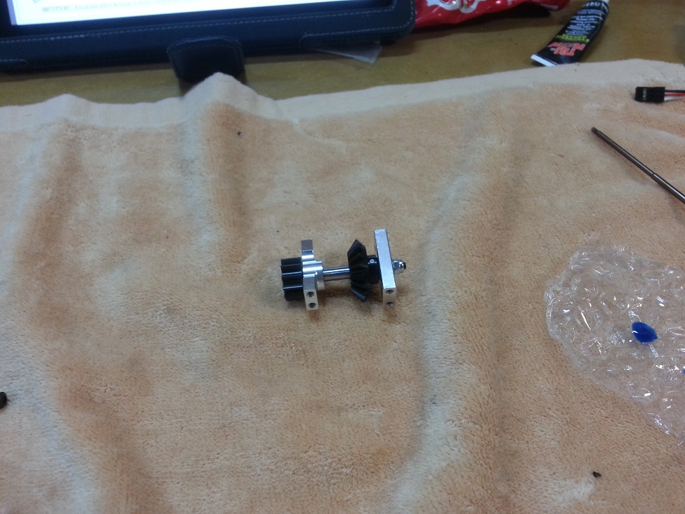

      Now build the head.. its the pretty standard.. just make sure you mount the arms to the LEADING EDGE of the blade grips...

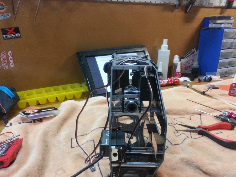

      now assemble the tail... make sure that you take out and LOCTITE THE SET SCREW THAT HOLDS THE TAIL GEAR PIN IN...

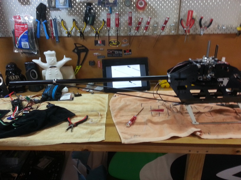

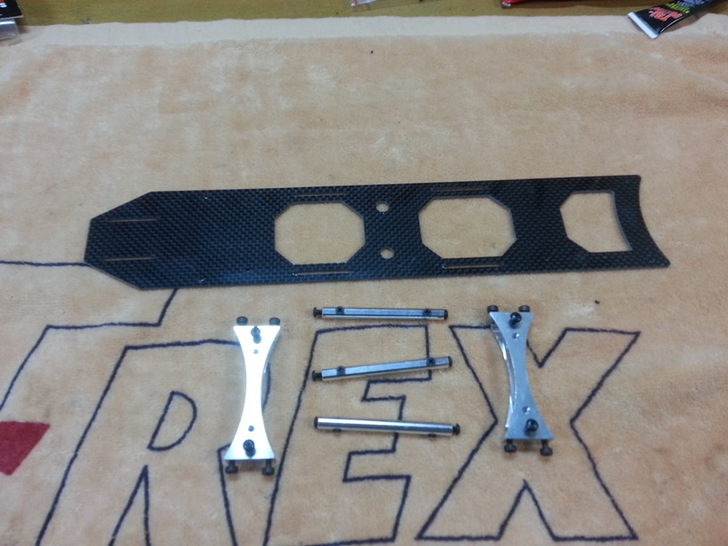

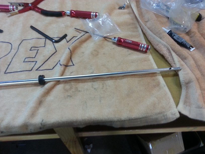

      now make up the torque tube.. make sure to not make the spacing symetrical or you may cause vibrations... also to help get it in the boom, grease the rubber case, and I put silicon spray down the tube.. slides in very easily..

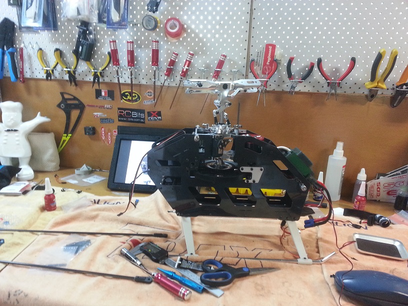

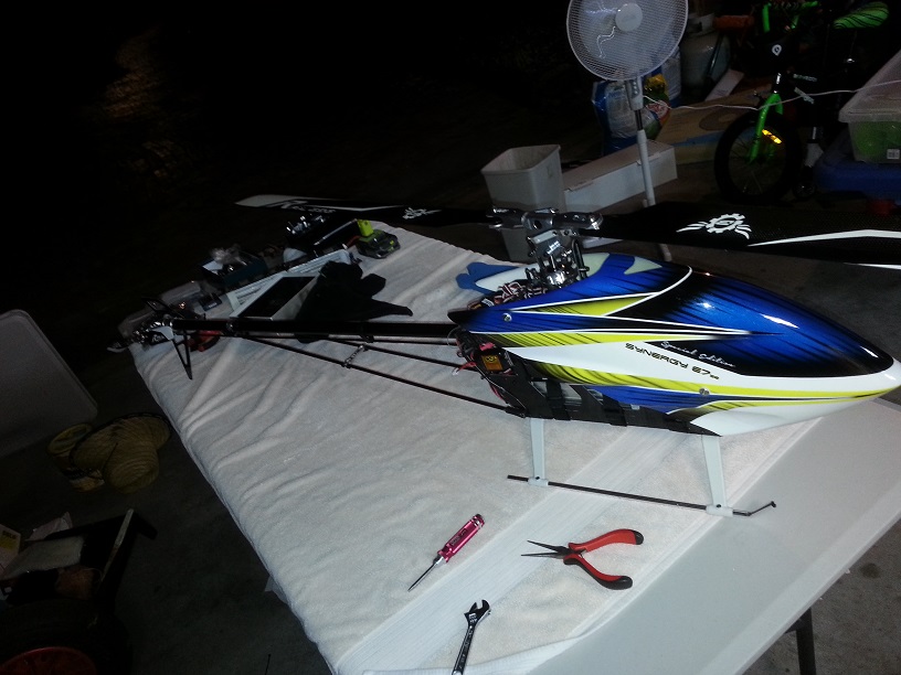

      Now mount the tail.. make sure to line up the tail case straight... pin the boom again, and your pretty much done...

      Maiden went well.. very smooth.. however I did have the boom to tight against the front gears and wore the gears down.. once I meshed them right.. it has been a very nice heli to fly.. handles the wind well... and is very stable.. yes.. has to the with the FBL as well..
      generally I am very happy with it...
