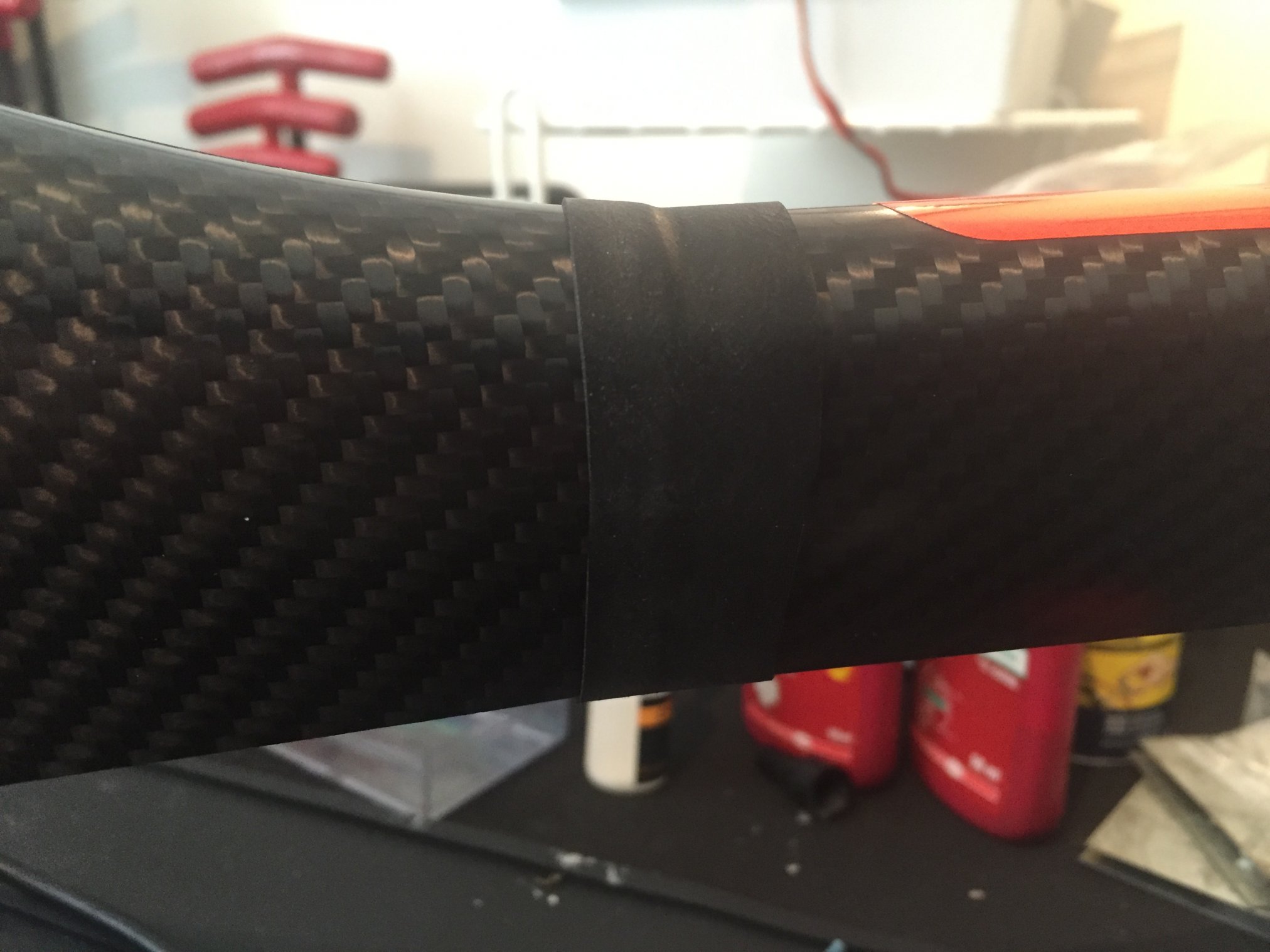

      As promised, pic of the purpose of the bicycle tube. Covers the canopy edge, holding the canopy to the boom (see manual page 79).

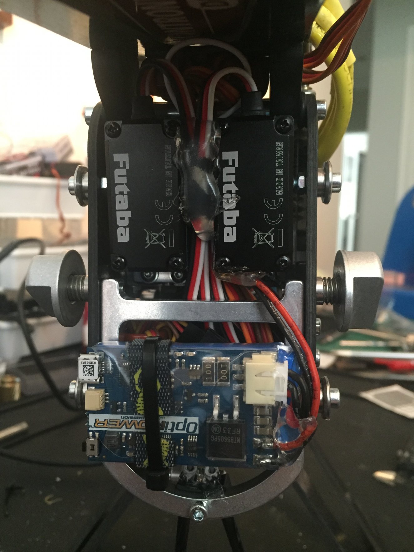

    2. ChopsyWA
      Electronics pretty much done now, so damn tight, no room anywhere! I hate using hot-glue, but easiest way to get her done at the moment...
      Retractable mechanism fitted to heli so I don't have to redo wiring later, but have the fixed skids fitted until the heli is flying well, then will fit the retractable skid plates.

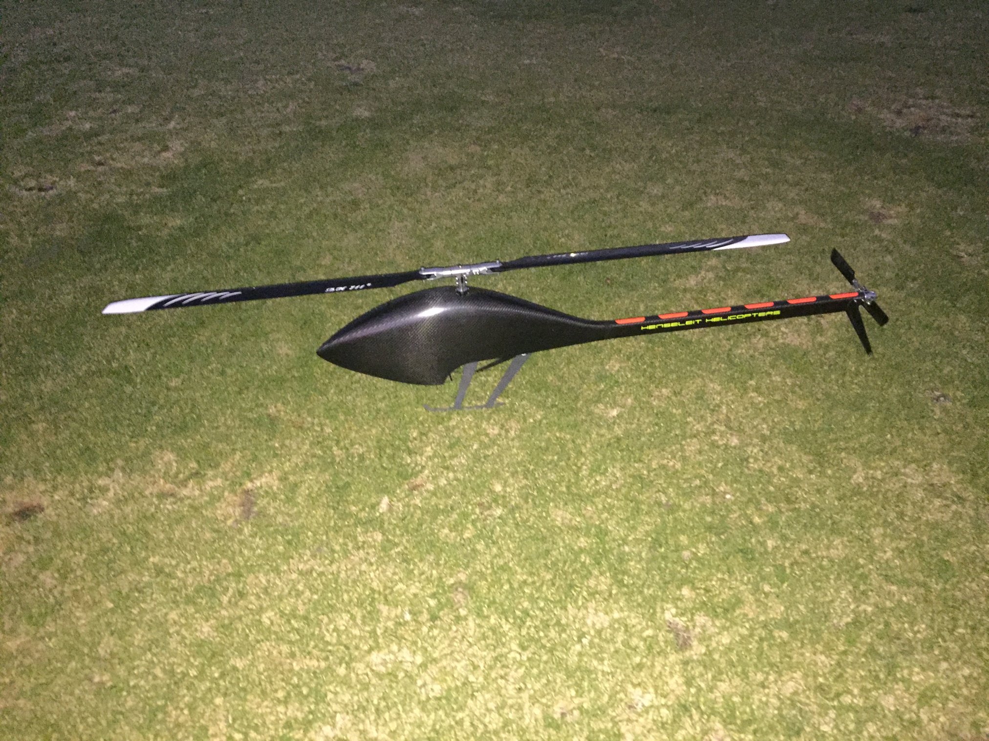

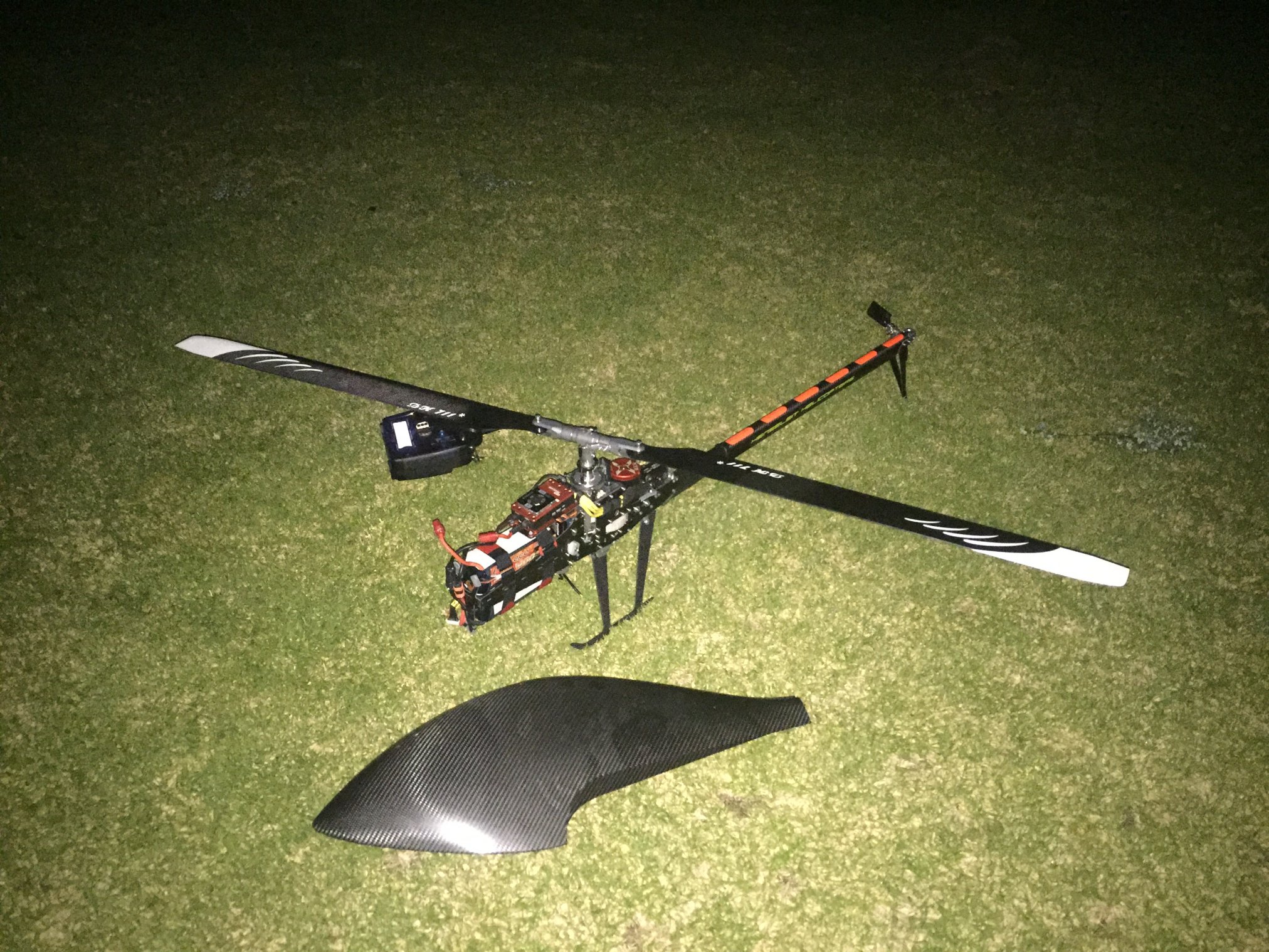

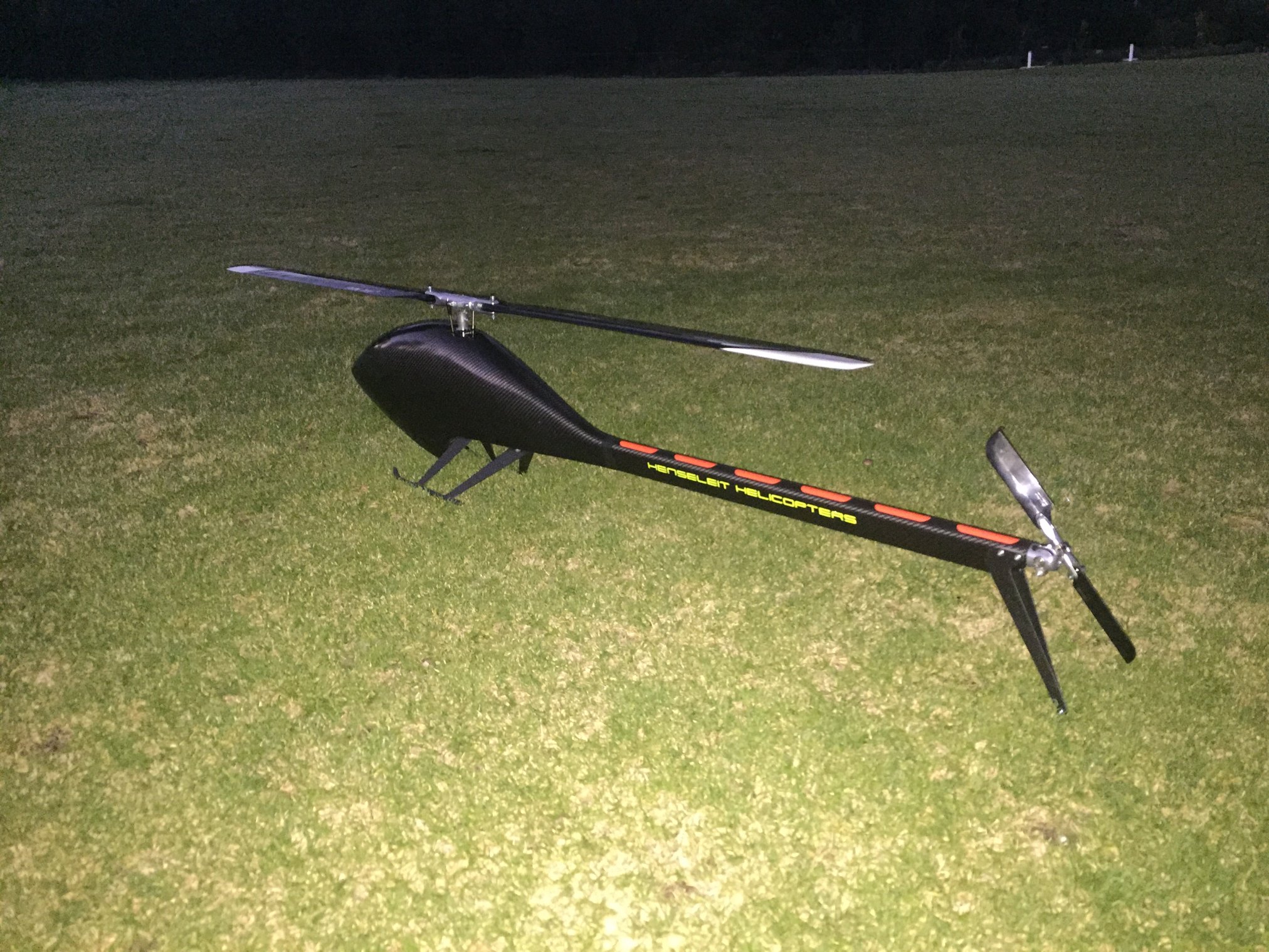

    3. ChopsyWA
      Well, with flying north for work tomorrow morning, it was a mad rush to get this bloody thing ready for at least a hover!
      The last couple hours I have learn't about RC-Pro-Plus connectors, soldered them to batteries, made up ESC leads, made up charge leads and charged batteries.
      Then spooled up on bench, vibes at 100 max in bank 1 (bank 2 @ 36, bank 3 @ 90).
      Then I skipped any swash or head setup, and took her across the road to the small park (maybe 50m diameter surrounded by trees).... :p:eek::rolleyes:o_O
      It was 6pm and a bit bloody dark! :rolleyes: But I can't let that stop me, being so close to finishing!
      I still have the canopy decals to apply when I get back, touch up a few things, and Soko the head.
      Non eventful, tail wagging, but not much time to tune, plus I got interrupted by dog walkers.
      Felt good, she is pretty quiet, now that I have the taste I'll be pining the next couple of weeks to come back, tune it, and crank it hard!

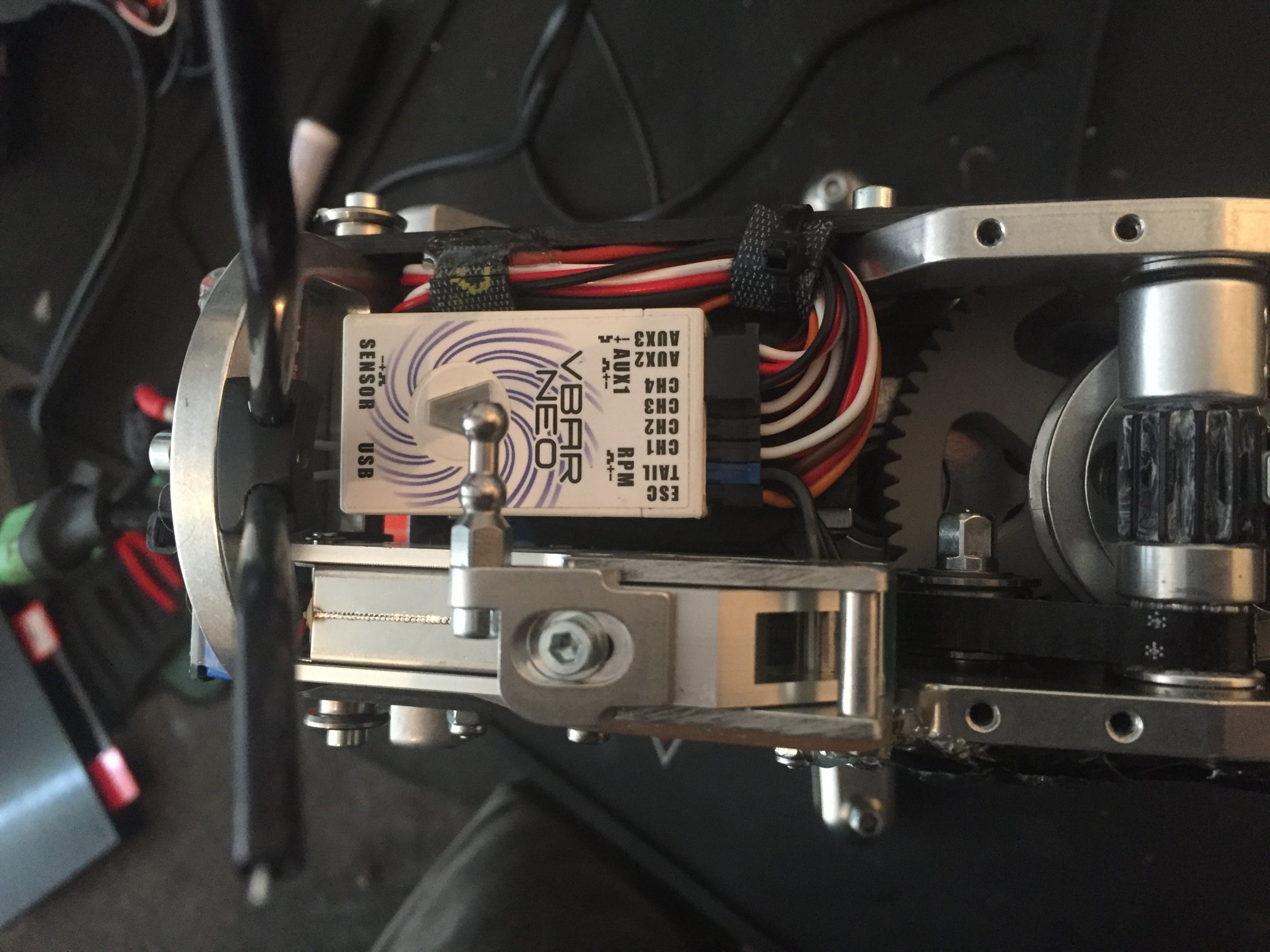

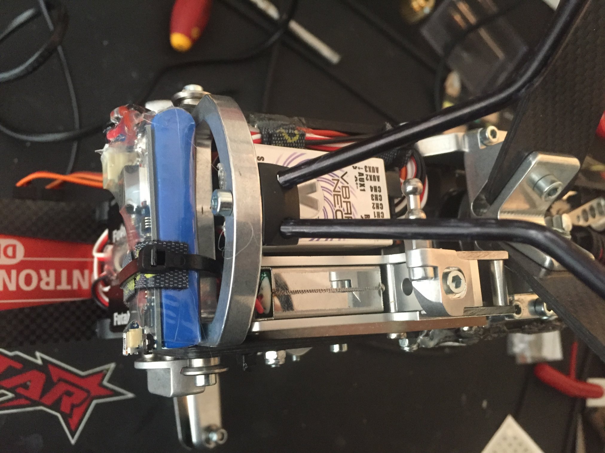

    8. ChopsyWA
      Today was the day to put on the canopy decals - and it turned out to be the PITA task that I remember from doing the decals on my Banshee and old TDR. I'm pretty average at decals the first time round with a new heli, will have to get another canopy one day and use this one as my beater...
      I then charged up batteries and went to the park to tune her in. Got thru the first pack, working on the tail stop settings, was getting there. Chucked on the 2nd pack, and all went south... The bloody neo has an IMU sensor failure..... Seems to be a common thing with the recent batches of Neo's, now I gotta pull the bloody thing out and send it to Germany :(
      Lucky I have a spare older blue Neo on the shelf, but hell I just want to get it dialed and flying!

    10. ChopsyWA
      Cheers Simon :)
      Got the blue neo installed and setup file copied in, ready for tomorrow!
