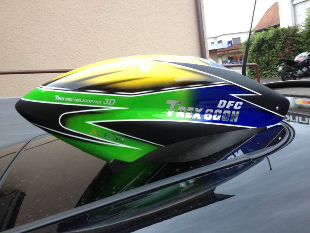

      I will go to the field tomorrow and find the proper setup. I have always a glow plug with me and will have an eye on that for sure. But hey.. you guys know me as the paint man right? :) hahahah have a look! - The canopy designer from Align must really be drunk all the time. The boring grey surfaces are black matt now! The skids too. Like it?
