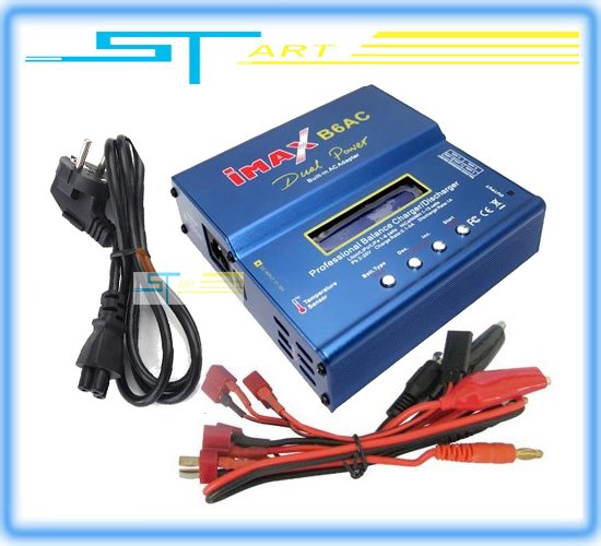

      Okay.... I tried to keep my 7 or so packs at "storage" voltage..... but damn if most of them seem to be lacking of capacity. What is the best way to re-cycle them back to correct? I have a digital charge/discharge/balance unit now, but not sure if I can save the packs (1000mAh/2S) if they aren't already damaged. Thoughts??.......
      4,819
      3,093
      Ok.. so how old are the packs? You can try a deep cycle charge-discharge to try and breathe new life into them. This should be a feature on your charger - depending on the model. It slowly discharges the pack to a very low percentage - then charges them up to a high percentage. It takes a while to perform this operation but has been reported to work.
      Also sometimes if packs are new but have been sitting around for a while - running a few cycles through them might bring them back to life. But alas - sometimes things get old (the chemicals inside the battery are not as good as they used to be) and sometimes you just cant revive them no matter what you do.
      2,200
      I been avoiding the discharge cycle on my charger, it takes the voltage down to 3.0 volts per cell.... is that normal?? It's one of those cheaper IMAX units, but seems to have all the necessary features.
      4,819
      3,093
      Well the charger does it GENTLY - so the slow-discharge and slow charge is intentional. The minimum "safe" lipo voltage (with no load hardly) is 3.0 volts. Its very nerve wracking to see the voltage around 3.0 - i actually performed this cycle on new packs with no issues - they lasted just as good as all my other packs. But when the battery is in a heli/car, the load requires a bigger safety net.

      Right... when flying, amperage is greater.
      My charger actually regulates from 1 Amp down to 0.1 Amp at end of cycle, same with charge cycles.... seems to be reasonably thorough. It's one of these:
