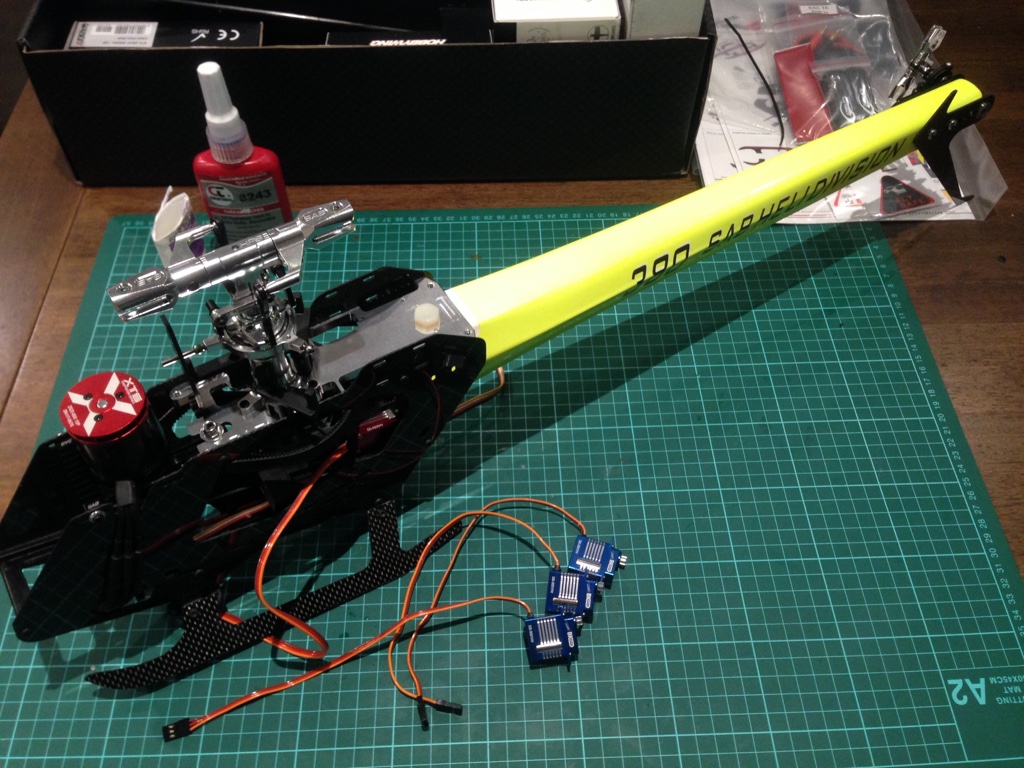

    Went to visit Mr @ZEN RC today and look what goodies he had waiting for me. :) Not the dog.

      Okay, so who used the prescribed Loctite 648 for mounting their bearings? If not then what did you use?
    2. 3dmick
      I use Blue loctite on everything
    3. 3dmick
      Yes that would be you dude :)

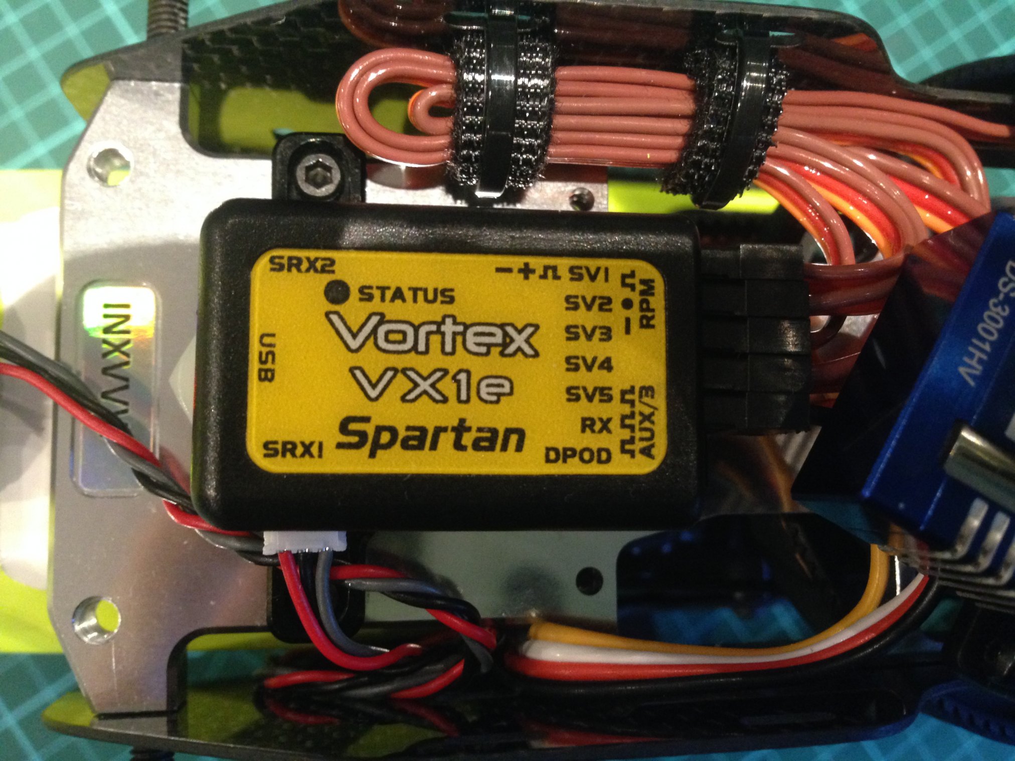

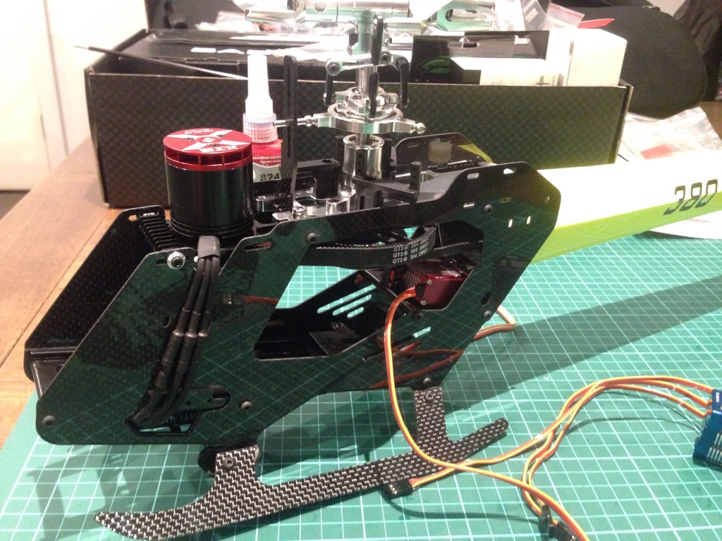

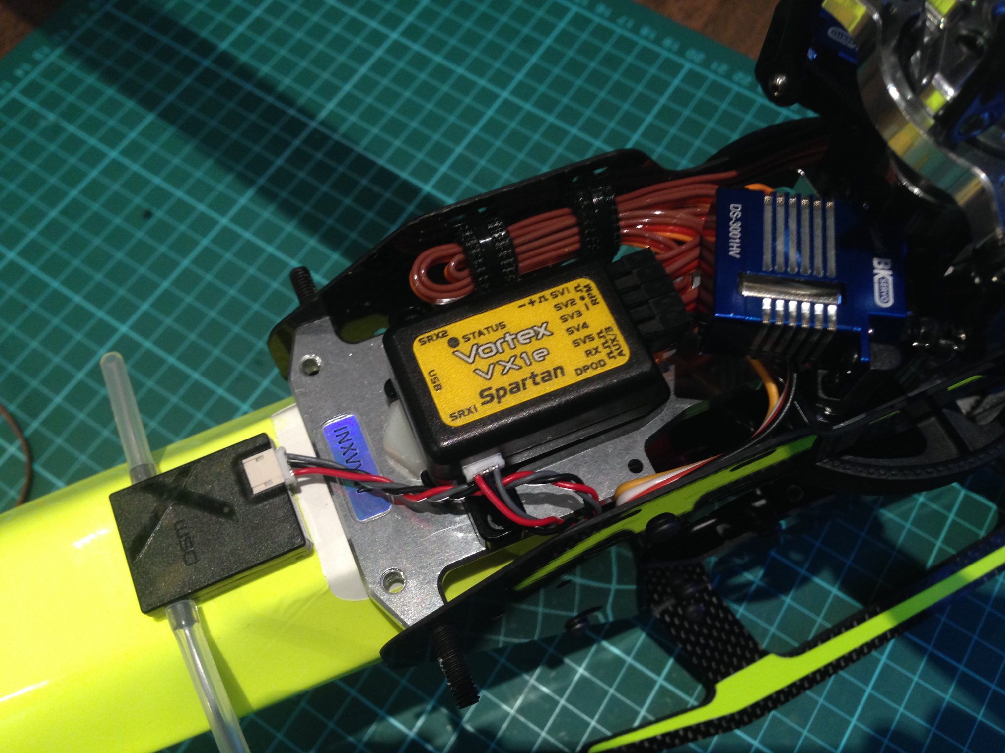

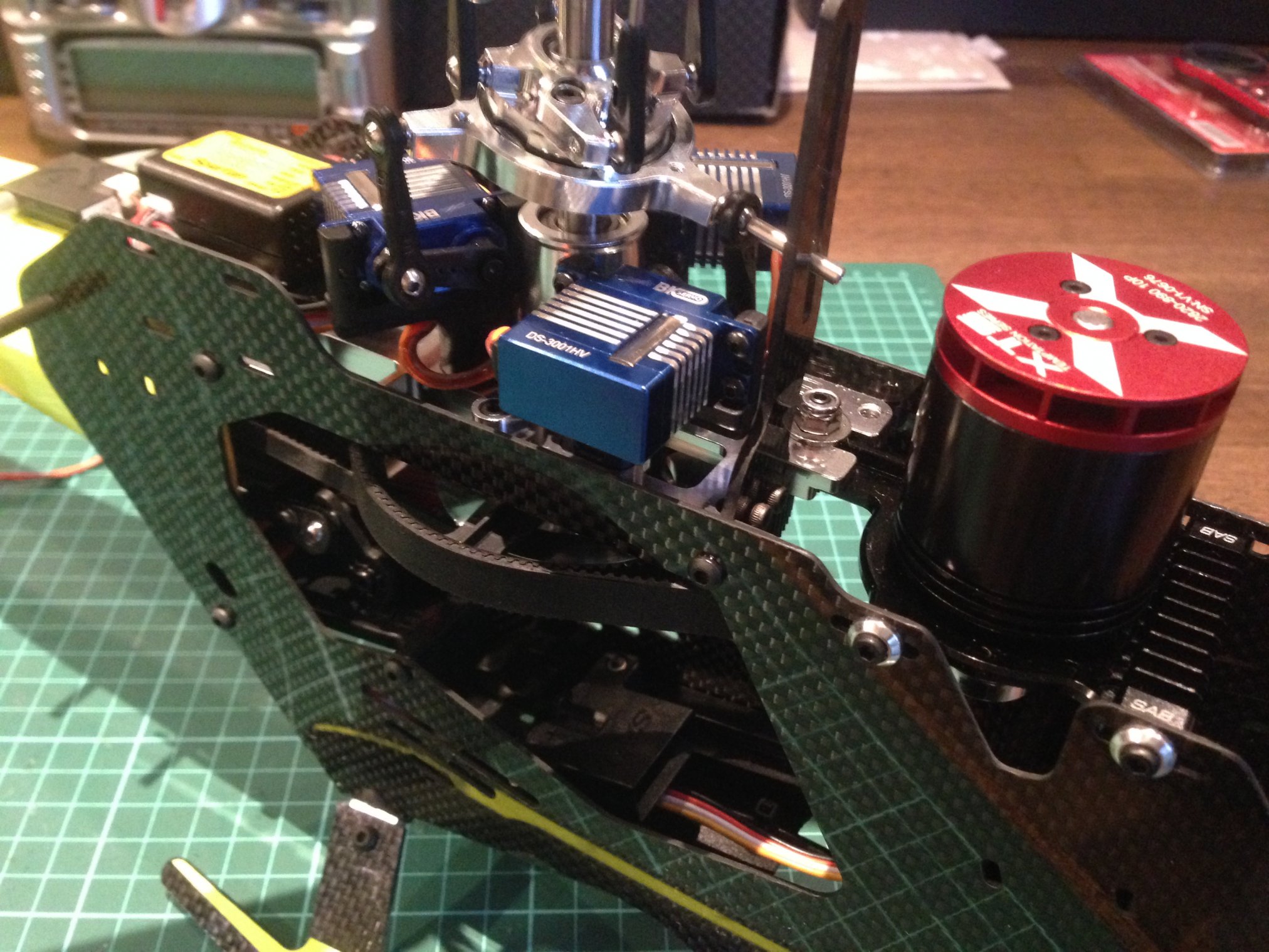

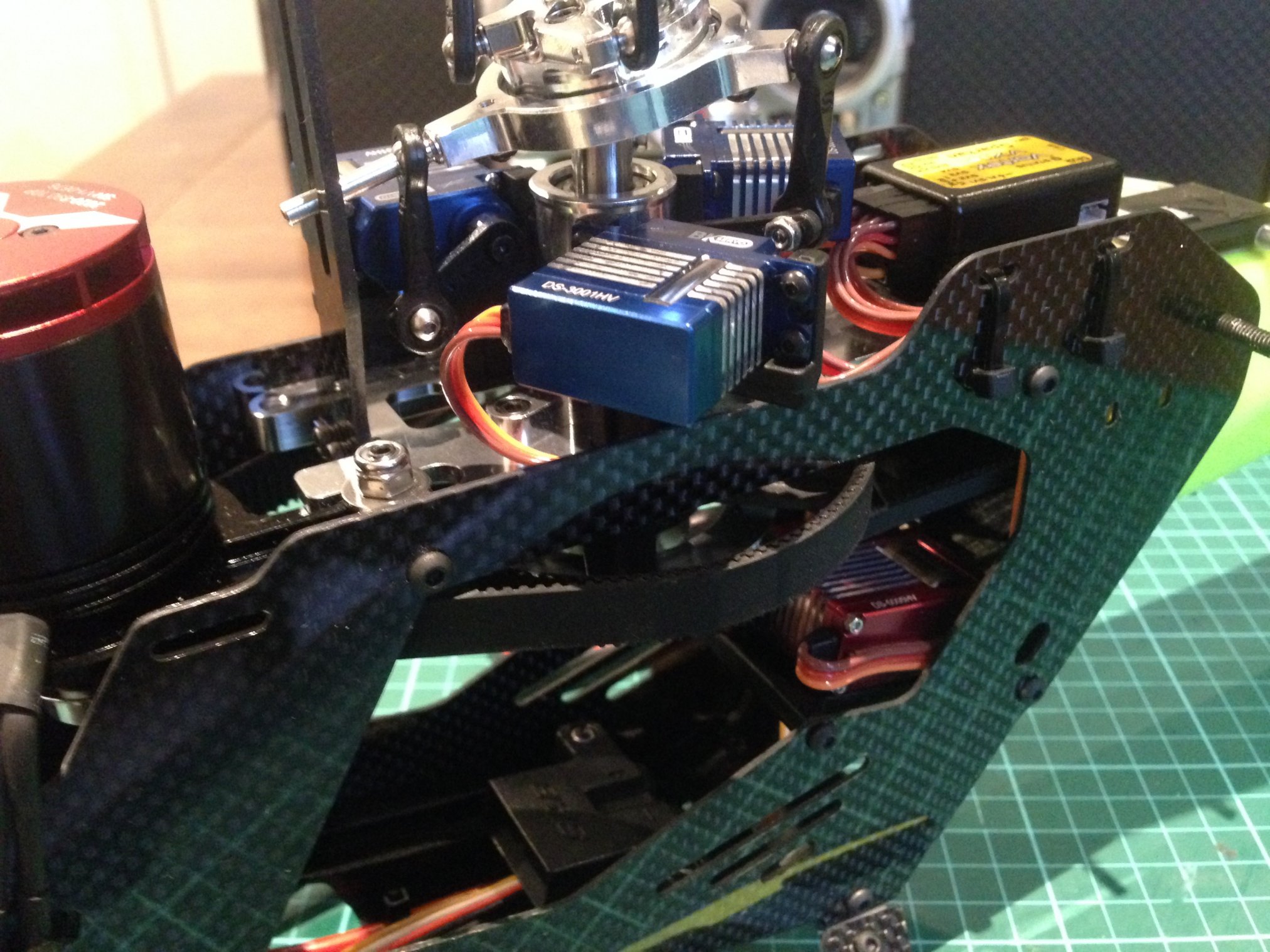

      Put a few more components on last night. Wiring and electronics setup tonight, maiden Friday.

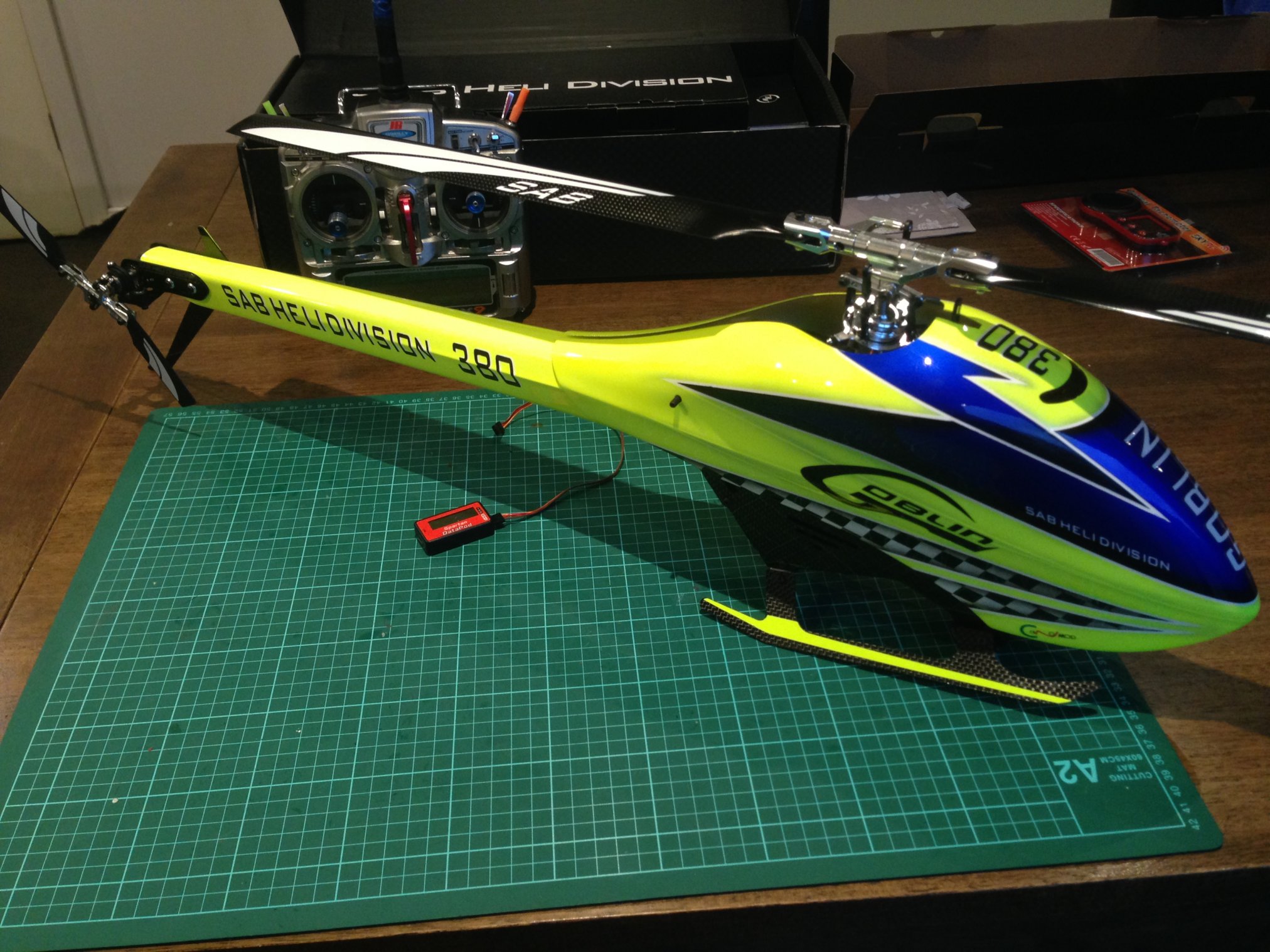

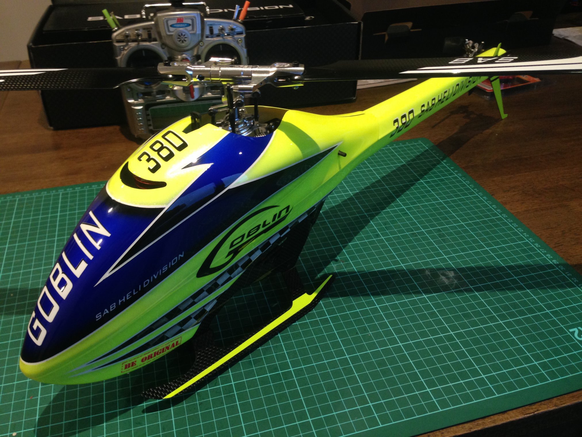

      Finally got the little gobbler ready for the fun fly tomorrow.
      Have only had a test hover in the back yard just on dusk tonight, so will need to do some tuning and gov setup tomorrow. Can't freakin' wait!
