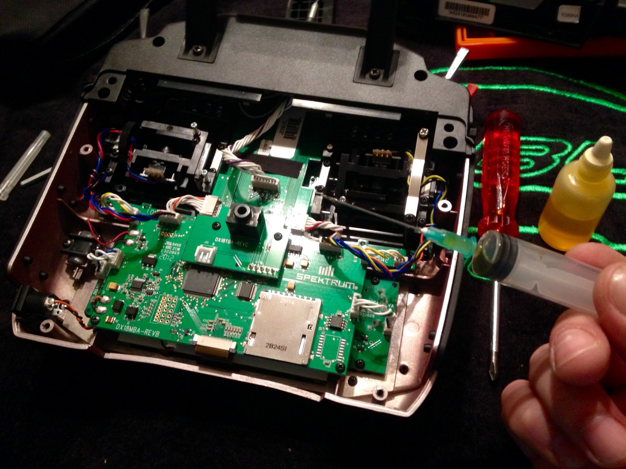

    Are your sticks smooth enough? - I decided to clean and regrease the bearings and pitch brace of my DX18. Its a huge difference!
    Once you've opened the transmitter remove the pitch brace. You will find some old dirty black grease.. (Dust and plastic micro particles) This can not run smooth! Clean that mess up with some alcohol and put on some fresh synthethic grease, the same you use for your thrust bearings. Then go ahead with your gimball bearings. Add a drop of bearing oil on every bearing and move the sticks so it can be absorbed. Keep your work clean, keep the oil away from your sensors and the other electronics. Thats it! You are done.
    Enjoy the new smooth feeling of your sticks. I bet it will feel better then a new one just out of the box! :D

    1. iggy
      I shot four packs today with the cleaned and greased gimballs and I can tell you, its much more precise. The dirty pitch brace was the biggest problem as the pitch stick was stopping in some positions. Im talking about milimeters but in 3D flight it means meters!
      Now its much easier to hit the zero pitch area and I can really give just one to two degrees more collective in funnels if needed. Rudder, ailron and elevator are smoother as well.
      Its worth to do that little service for sure even if your tx is almost new. There will be much plastic micro particles on your pitch brace, thats normal.

    2. maingeer
      maingeer Active Member
      Jan 30, 2016
      240
      80
      This is probably what I need to do with my Transmitters. Thank you, I'll give this a go, hope it helps.
    3. iggy
      Do it mate. Its not a big thing but means a lot. My DX18 is second hand and I use it much on the sim as well. Now it does the job better.
      • Thanks Thanks x 1
    4. maingeer
      Jan 30, 2016
      240
      80
      Many thanks Iggy, just done it today, smoooooth as silk :D
    5. iggy
      Fine! Dont fly to fast now! Oiled sticks are driving your bird crazy.. LOL
      • Thanks Thanks x 1

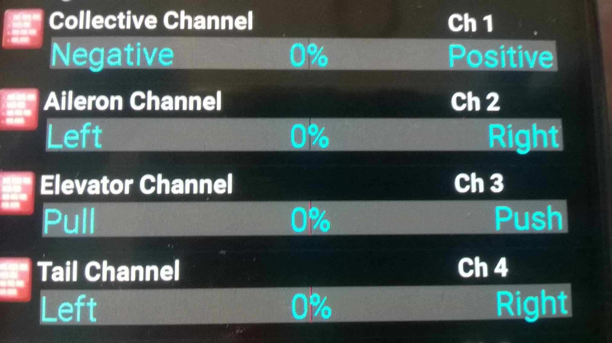

      I'm about about to go into my DX4e and straighten out the gimbals. They work fine, but the manual trim tabs aren't accurately calibrated. When I read the real-time monitors in Vstabil, I have to crank the ailieron trim almost full left to get indicated center. This will probably involve adjusting of the potentiometers in the gimbal frames or resetting shaft splines or something. I've noticed it before, but had been correcting at swash plate links on 120SR and thought the NanoCPx was just weird before I figured out the gimbal trims were off. The 450/K-Bar doesn't show it as much, but I still want it fixed!
    7. iggy
      As Im not experienced with analog trims, i cant help you there. I hope you get it fixed. Its not a must.
      It's a fairly easy job. I just have to take the time to do it. ;)
    9. Beaver
      Sonoffovich! It was worse than I thought. There was slack between the pots and the trim tabs.... trim tabs out of adjustment..... typical for cheap plastic gimbals in a DX4e I suppose.
      I calibrated and locked the pots and trim tabs per real-time monitor readings in Vstabil app.... now The sticks are way more precise. I can move the sticks around and they consistently snap back to indicated center (0%) with trims centered.
      Indoor test flight with the 450 verified the improvements with tighter response to even the smallest stick movements! I had to reset the swash links on the 120sr from being set to the mal-adjusted Tx.
      Yeah, I know... Just get a better Tx..... but this will do until I can. :D WP_20160302_001.jpg
      (Center stick readings after calibration and test movements- dead-on zero!)
