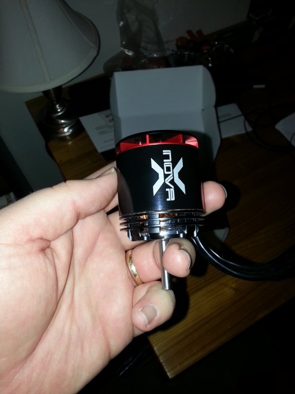

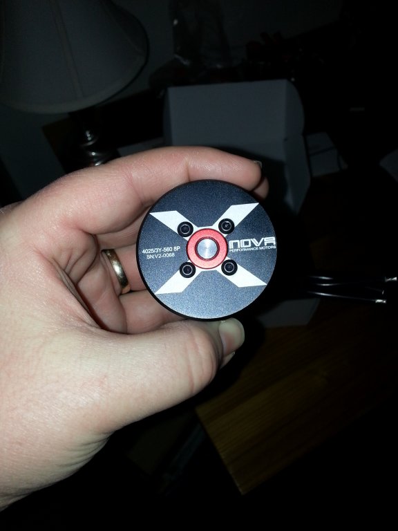

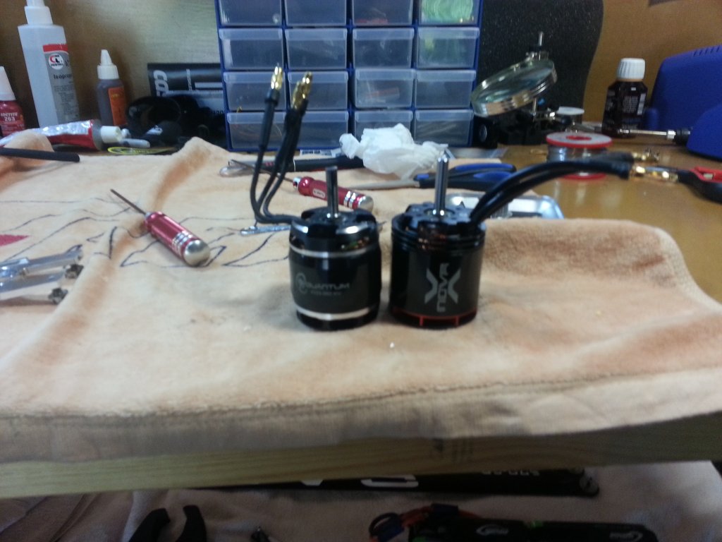

    Ok... as well debated in other threads... I have upgraded the Quantum 4125-560 to a Xnova 4025-560... So here is a basic overview of my initial impression.
    Motor itself feels like it is very high quality... the motor itself feels very solid, and the motor itself is a fair bit larger than the quantum...
    Motor felt very chunky when spinning the motor by hand.. makes no difference to power, but was a surprise... anyway installation is as you would expect.. fairly easy... The recommended ESC settings are pretty wishy washy... just don't use outrunner.. and try these settings then tinker from there.. Currently I am running it at 12khz PWM and normal timing.. I will experiment a bit to see how it impacts performance, once I'm used to how it feels in the air.

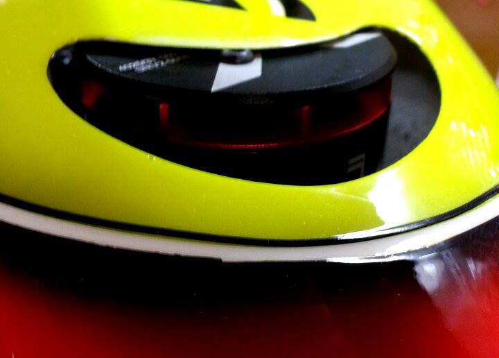

    Now word or warning.. This is very close to the maximum size that will fit in the canopy... now since apparently I have a "Its Friday I want to hit the pub" canopy, it looks like the Fiberglass is thicker than it should be, the vent at the top, not cut correctly, and looks slightly out of shape... so the motor touched the canopy... thanks to Dale at AFF who helped me trim it a bit to make it safe to fly.... so not impressed with that, but its not the motors fault, but you have been warned. It has been slightly sanded down here, and it still touches.
