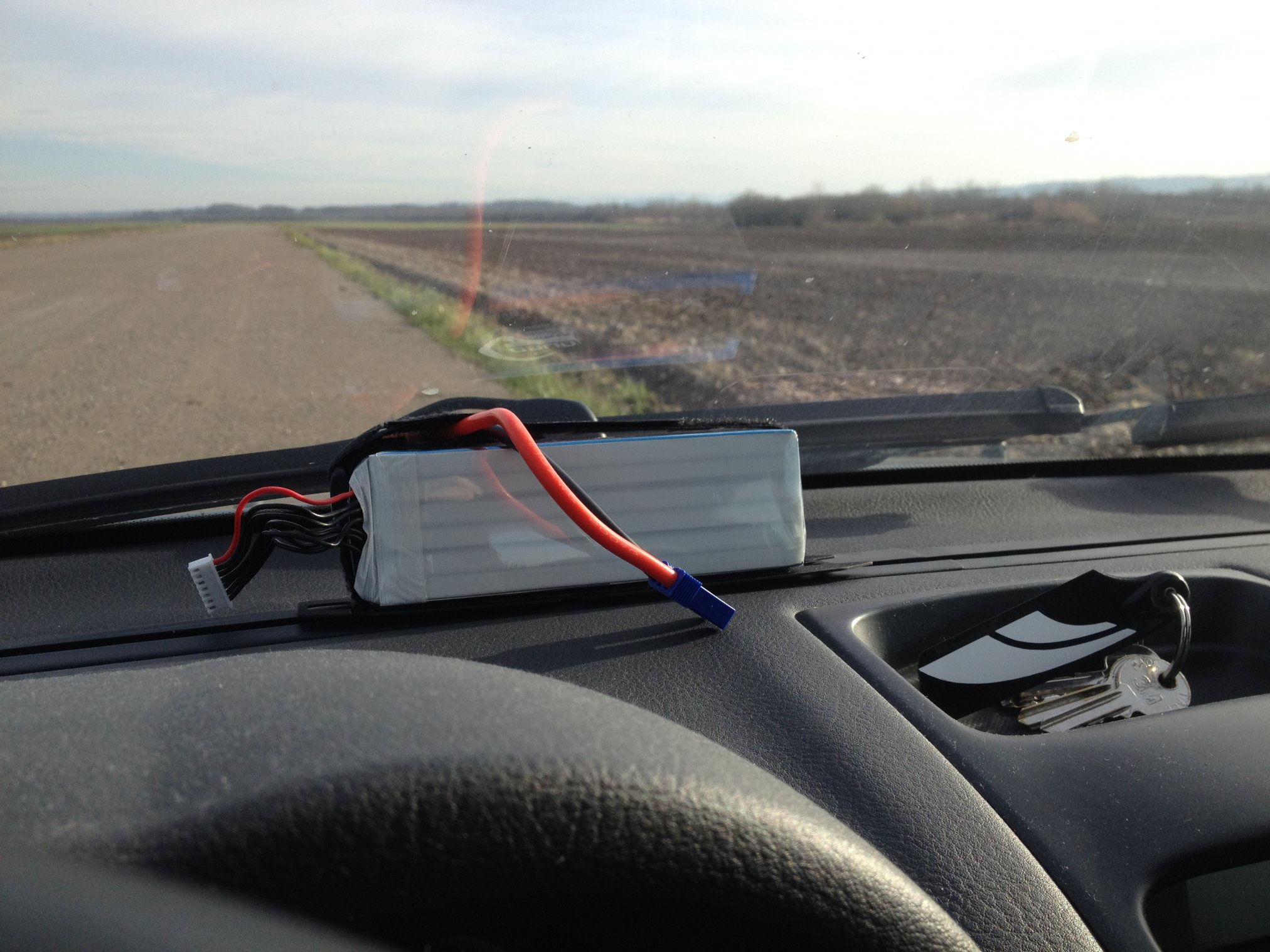

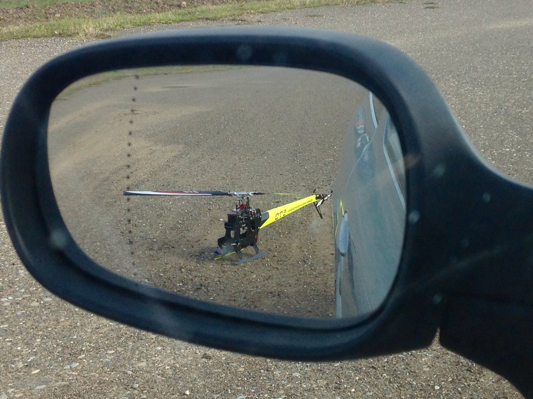

    Today I couldnt let my Gobby lay around even if we have very strong winds and cold but sunny weather. Some fingerless glowes helped me a bit and I had to warm up my ass and lipo for every flight. :) LoL
    After treating the belts with silicone spray they run a bit smoother. Im getting a feeling for the new heli very quick, looking forward to learn many tricks on this one as it flyes really great. It could be a bit bigger sometimes.. Maybe 630 or so.. ;)
