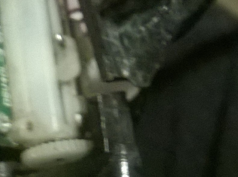

      WP_20150705_001.jpg Ach! Time for a new frame. This original one has reached it's limit, broken at the tail support. Next question: Stock frame or aftermarket? Time to visit Lynx, Rakon, and Microheli to see what's available. Will probably go back with stock frame due to cost though. I don't want to keep dumping money into this Nano when I could be saving for an Ares 300CP rtf.

      Nano patched and reinforced at the broken tail holder, holding solid again. Flying in the variable wind gusts of an approaching thunderstorm...... that's challenging and fun!!

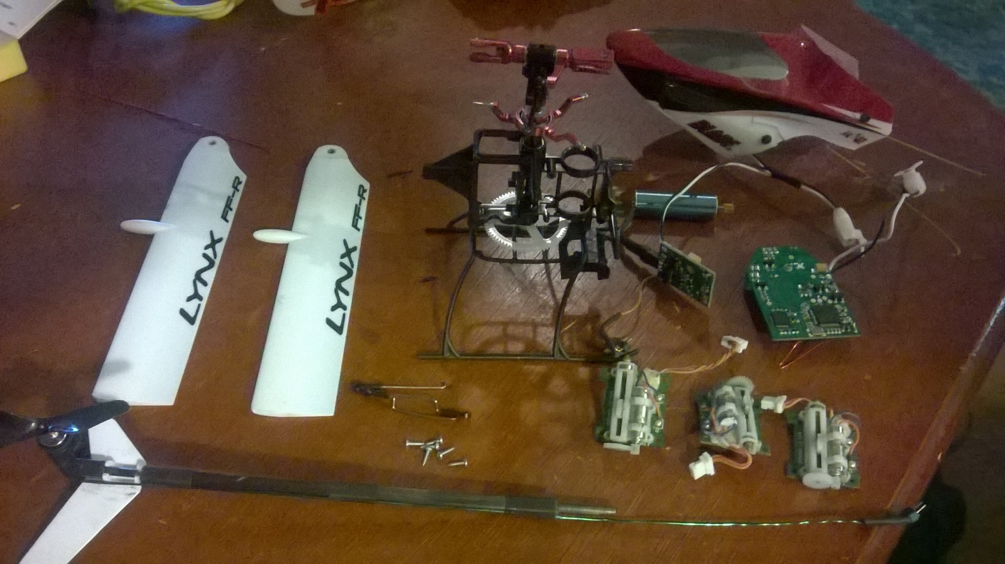

      In pieces again to replace frame. I think I'll go ahead and rewire the power system to provide better amperage to both main and ESC boards.... per earlier calculations using solid wire with any redundant lengths removed should provide less voltage drop at a higher current capability, and maybe a little less weight. WP_20150710_002.jpg

      Successful refit complete. Solid copper wire installed straight to main board, ESC power leads cut down to 3cm and soldered close to main board, and only 3cm of stock wire and battery connector. Wiring routed under port and rear servo to secure it in place. I notice an increase in power after a 3 flights, definitely more zip at the collective. No power drop-out.... and I even used the original Rx board that was giving me problems with the BL kit. The silly thing even soft-landed LVC with throttle hold on. @smakmeharder , you were right about the leads being weak. WP_20150710_003.jpg

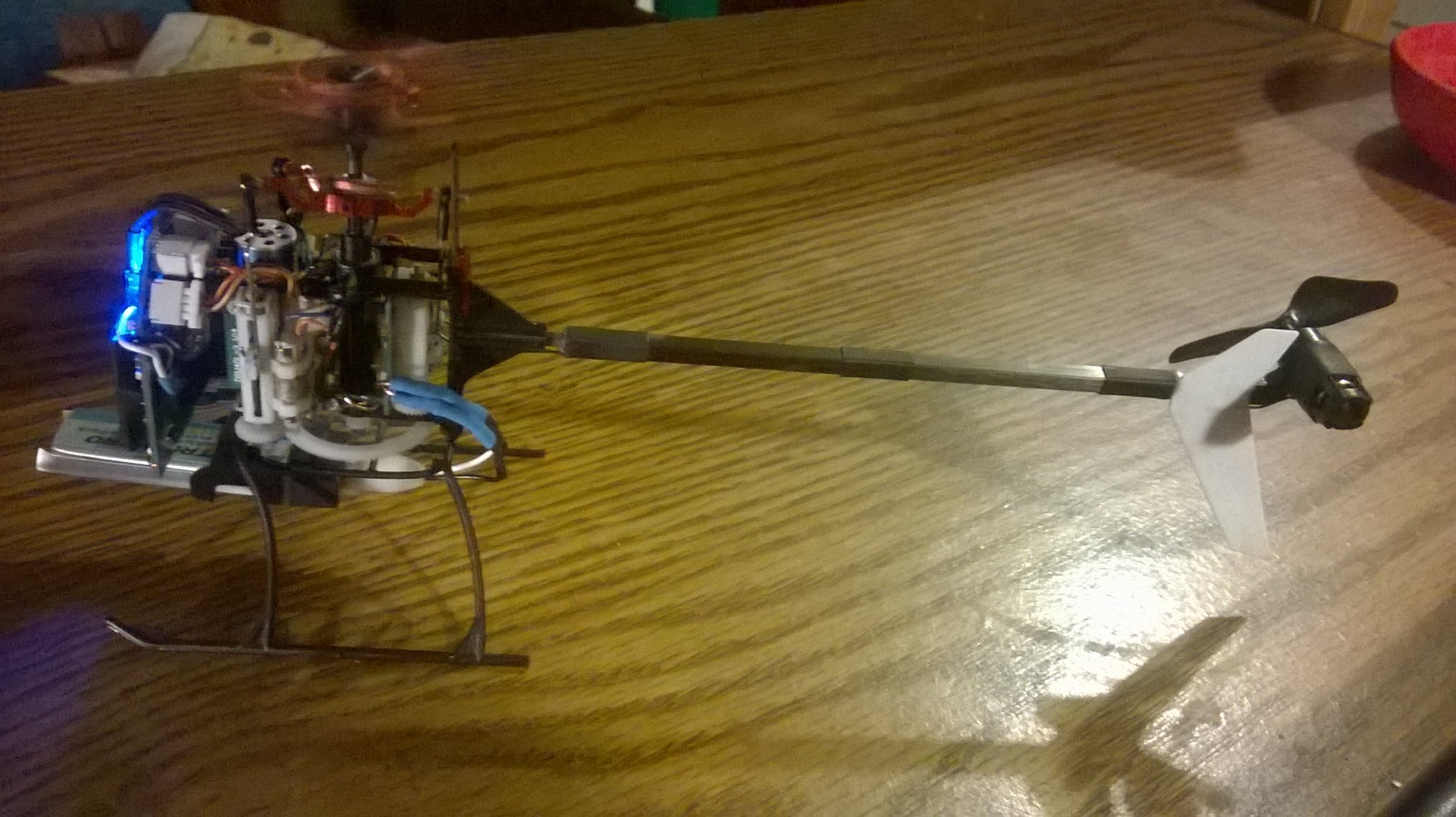

      One too many nice calm winded nights, and me without L.E.D.s on my Nano because of frame change and other work having been done to it. That is about to change. I just spent several hours working L.E.D.s onto the tail boom assy. Tomorrow: white L.E.D. backlight for the canopy, and maybe a set of NAV lights, and I'll be back to night fly capability. :D

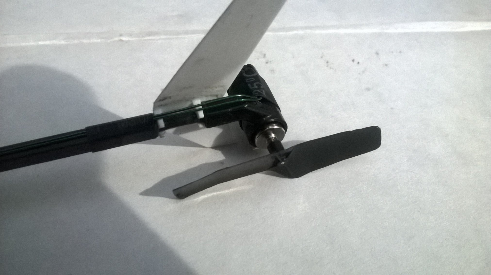

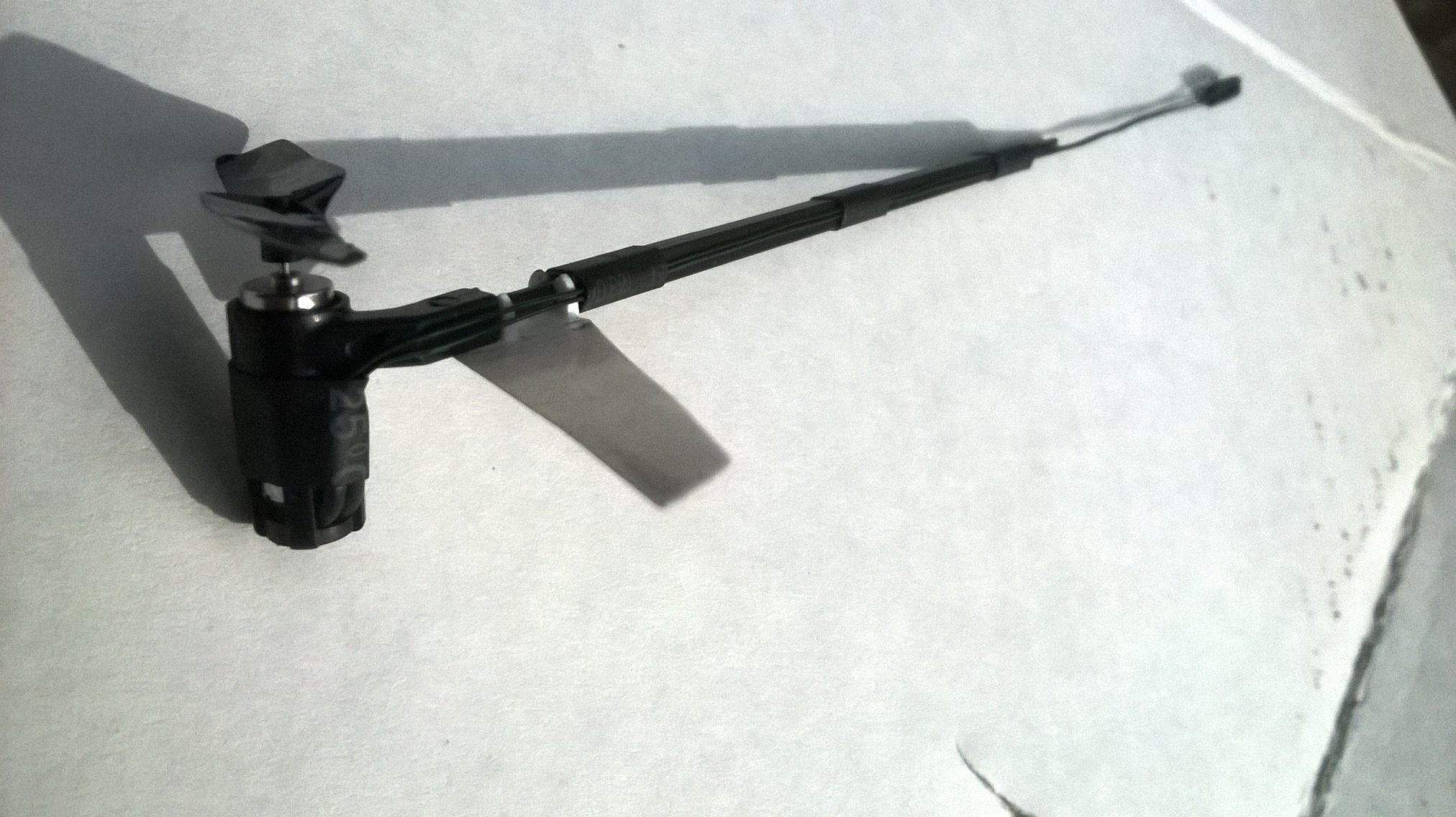

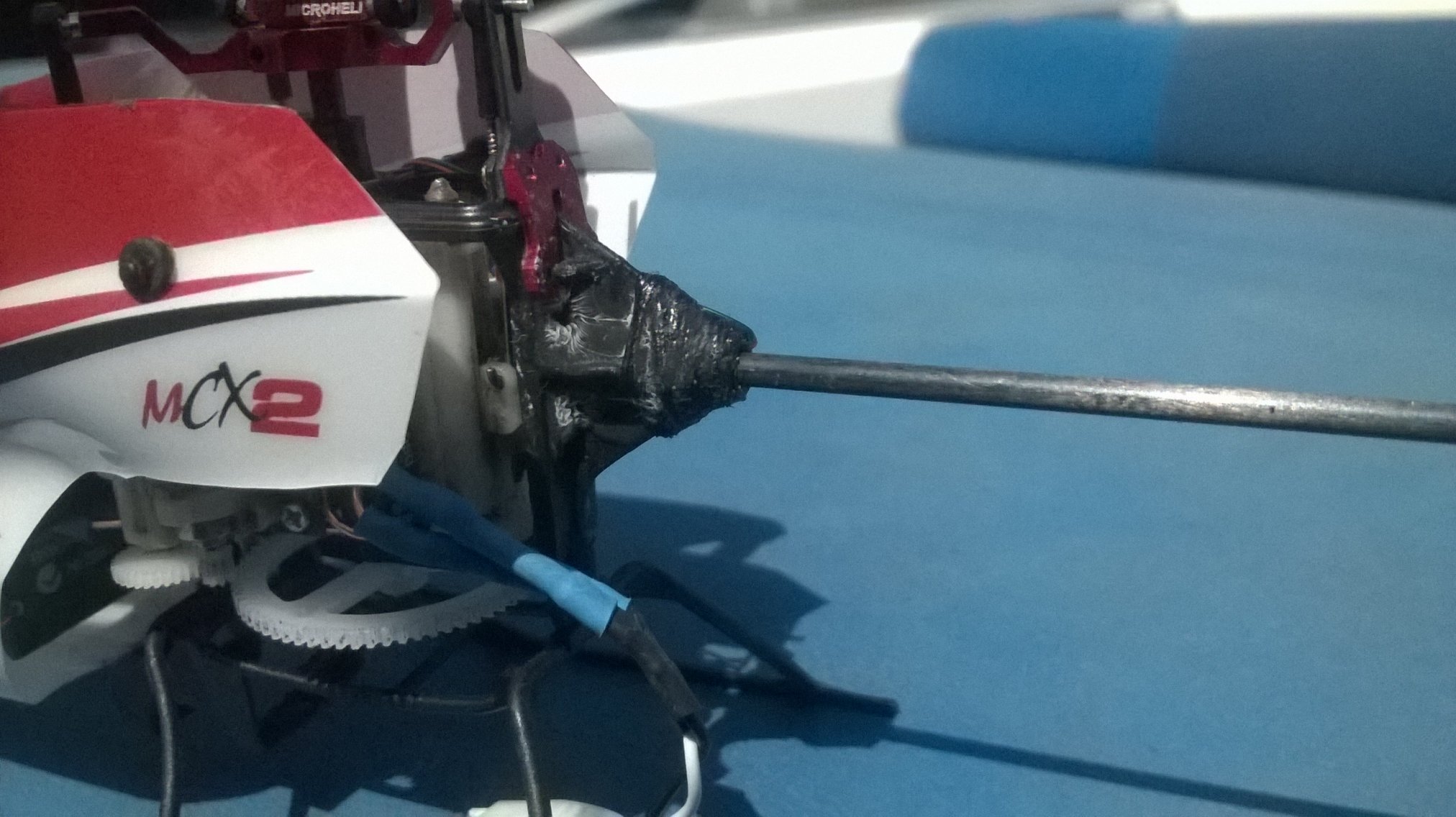

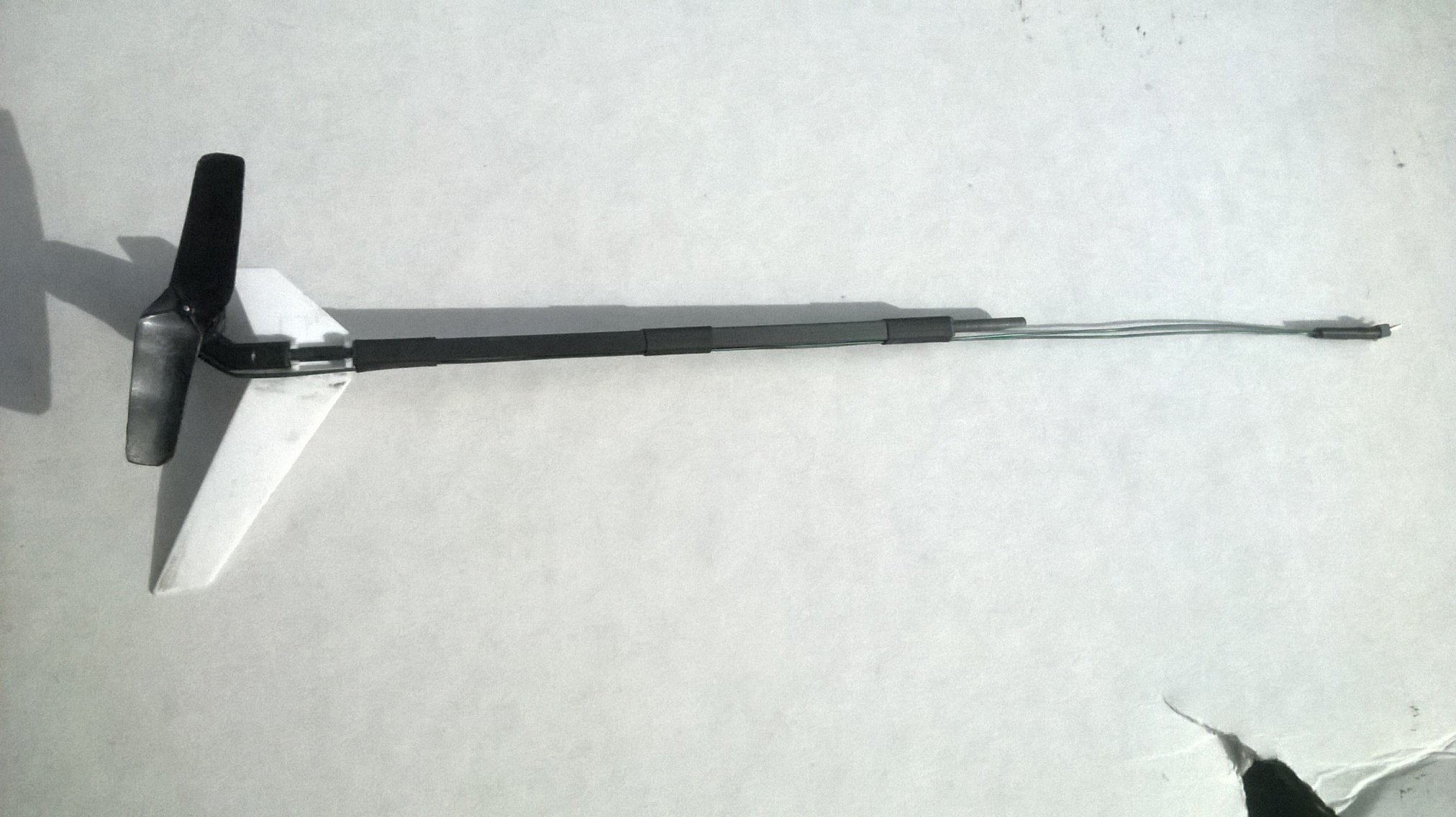

      Okay..... So much for the "indestructible tail-boom". It's indestructible alright, at the expense of the main frame. I cracked the boom socket out of the frame when I piroed into a wall last night. FortunatelyI was able to patch the frame. Back to stock tail assembly for me...... for now.
