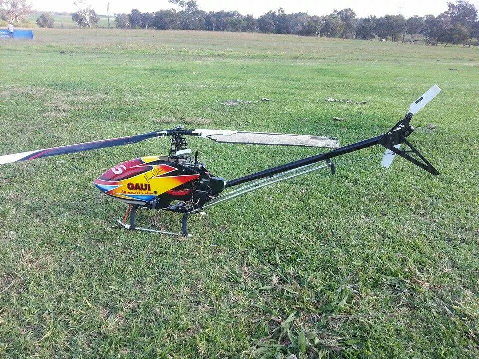

    7. feral
      @sprog s new Gaui X5 scorpion edition

    9. feral

    20. feral
      Yesterday man young sprog got cocky did a flip into a tictoc that = boom!!!!!!
