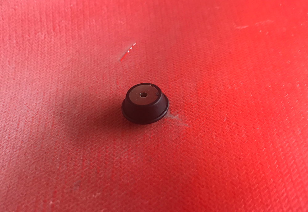

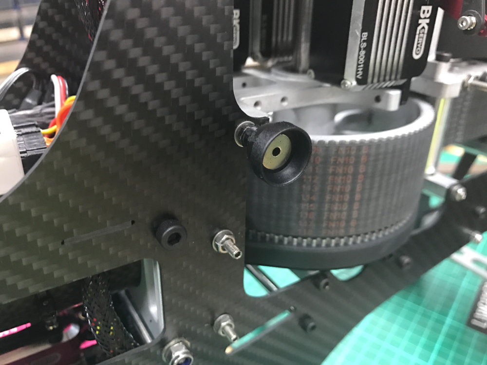

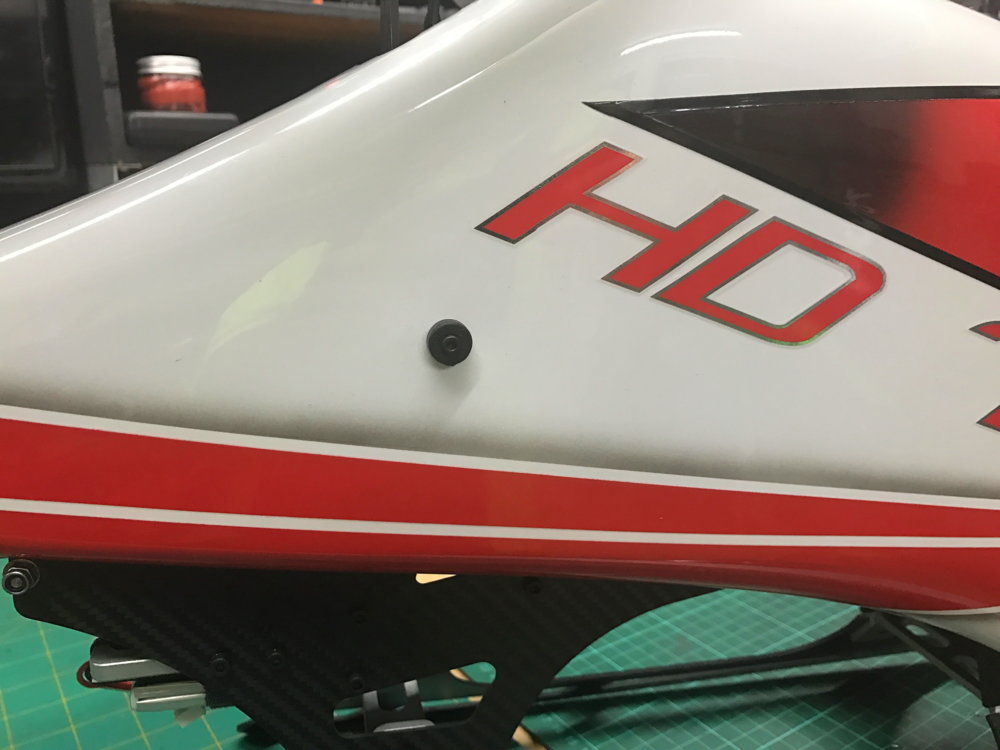

      Decided to try out some magnetic canopy mounts.... I got the Protos 700 & 380 mounts from @ZEN RC thank you Sean.....
      The 380 ones fitted the best and surprisingly very strong!! So i went with them and installed them last night. The HD canopy has 2 strong magnets mounted along the back of the canopy where the two side meet, which helps the 380 ones hold the canopy on nice and tight.... Tested it out today at AFF and they work perfectly!
      I just have to make something a little better than the thick black plastic washer im using on the canopy to hold the mount with!
