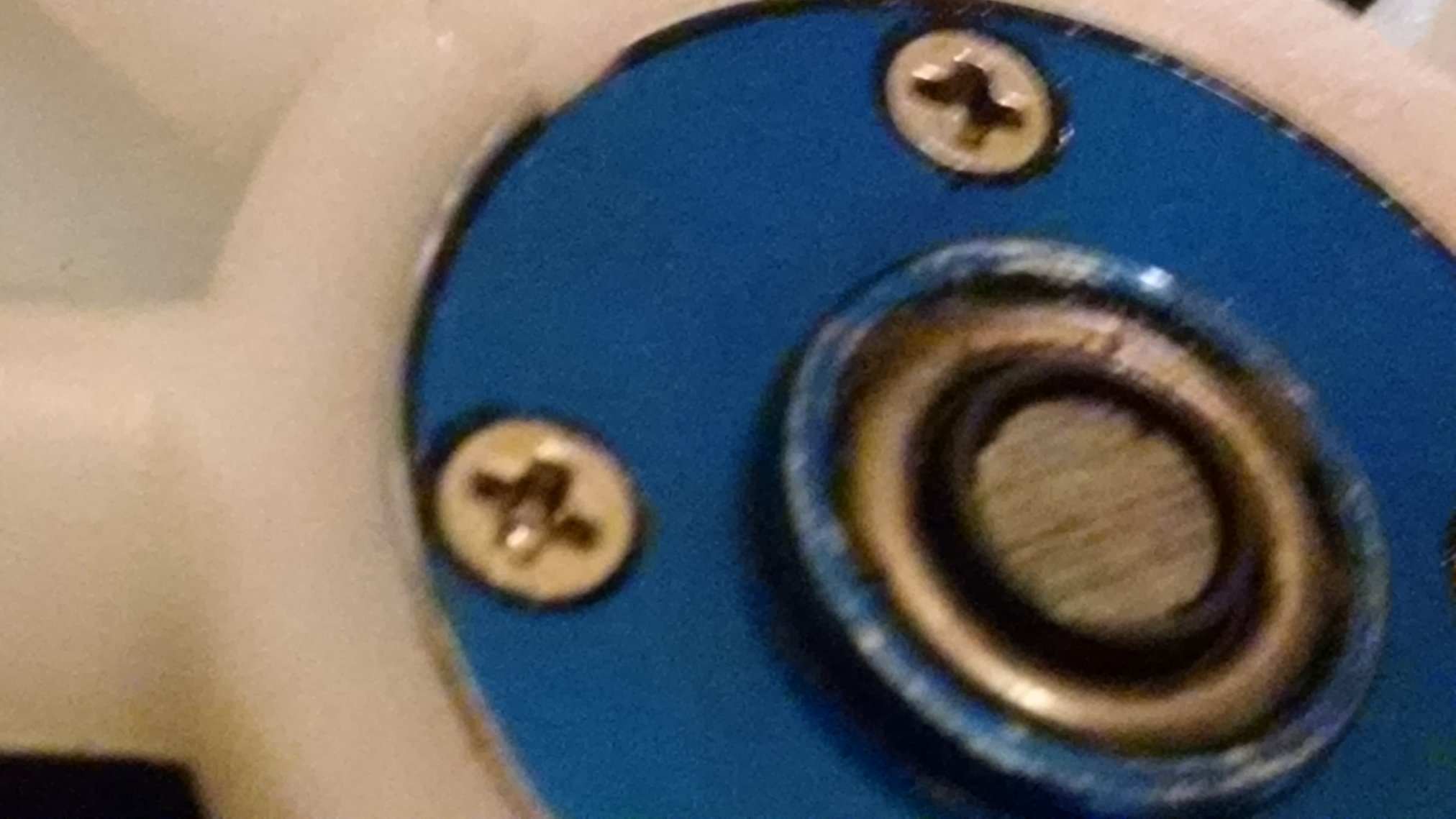

      I'll be going over the gear and hub tonight. I noticed the gear is off center at the hub, so there has to be something wrong where the gear is screwed to the hub. Fortunately the gear assembly is easy to remove. ;)
    12. Beaver
      It turns out that the screw points between the gear and hub were slightly off somehow..... possibly stretched or deformed during a recent crash. I forced concentric alignment by installing a shim in the gap between the edge of the hub and inside of the hub flange in the center of the gear and applied a bit of red Loctite to retain the shim. This will keep hub from moving off center when tightening the screws. Gear is now perfectly centered, and I can set proper pinion mesh. :D
      This is still only temporary, until I get the new helical gears. Either way, I have a new trick for maintaining absolute concentricity of main gear....... Straight or slant cut! :p IMG_20160309_193959483.jpg
