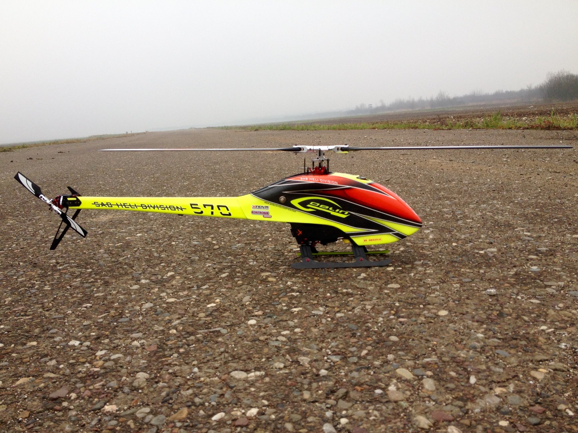

      Fog flying.. :D Damn its cold but I got to bring my skill level up asap. The sim Im destroying LoL. But at the field its still an other story.. Any TX heaters on the market?? :)
      Flying in the FOG? Wow @iggy thats gutsy! You know you can get battery powered jackets which warm when you put your hands in the pockets! @3dmick has some... everyone is jealous of him during winter..

      Oh that jacket looks good! I would pick the red one. Clever investment for sure. The fog isnt that bad @smakmeharder - as the heli is a 550 class I dont fly far away.. Today the same weather.. But the show must go on. :)

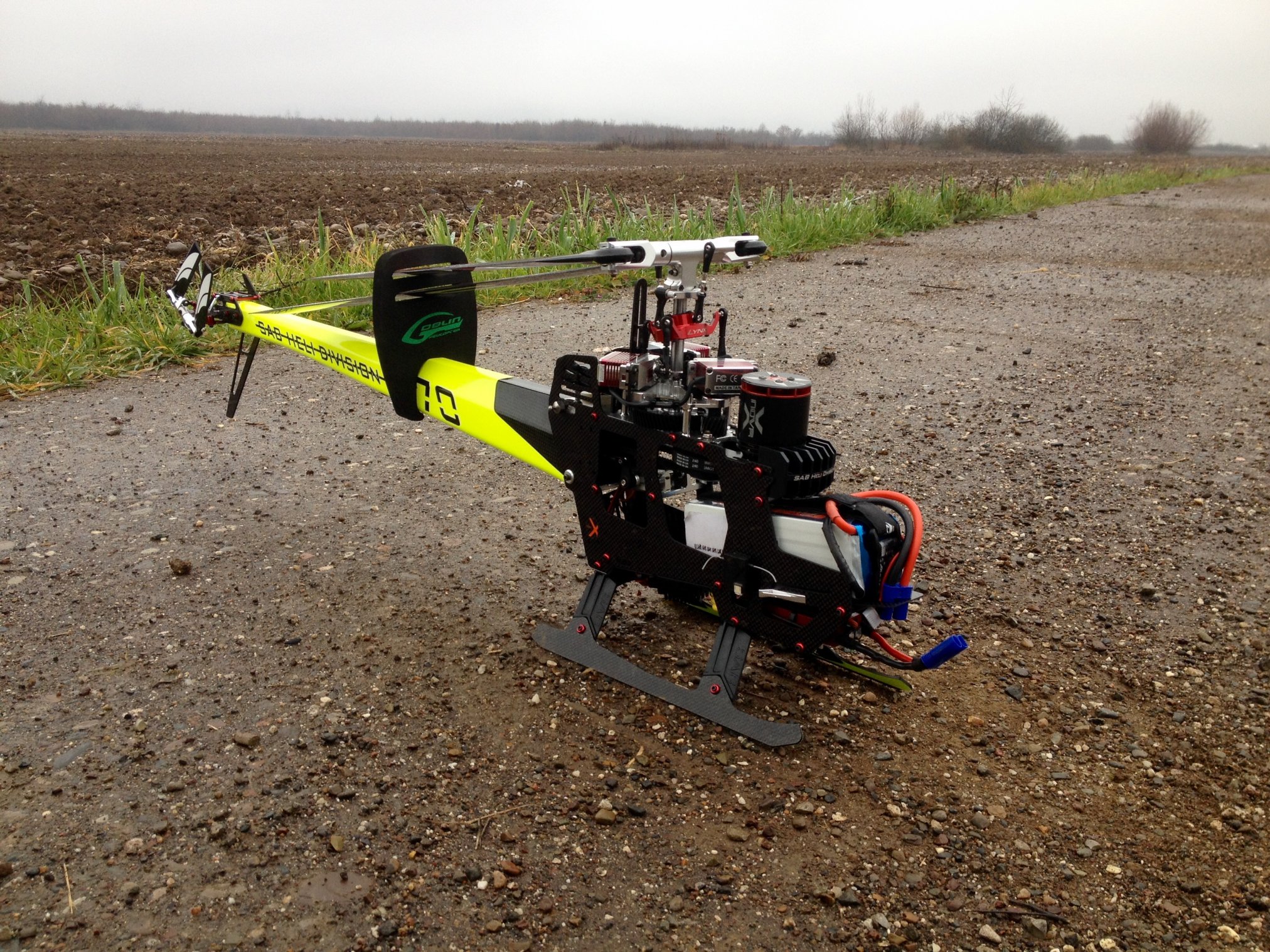

      Today:
      flying in the drizzle! The heli wasnt even wet. I gave em hard today and noticed that 3:30 minutes is to much for my 5000mah packs. First pack came down to 14%. I decided to go down to 3:10 flight time and thats it. 30% left. 12s setup should give me some more flight time...
      I noticed a tiny little wag on nick when hovering for landing. It sometimes does this at the end of a flight. @Manyc have you ever noticed this with your msh brain? It could come from the cold. Its only 3 degrees here.
      36 flights done on the new machine. Im very happy with it! :) Bad weather - good flights.
      Will do a video soon! ;)
    14. Manyc
      wag on nick? are you lower head speed to land? sometimes if you go from a higher head speed to a lower head speed with a higher tail gain you can generate a little wag for a second as the head speed drops but the tail gain is already high...
      If thats what you mean
    15. iggy
      Yeah I go down from 2300 to 1800 for landing and it takes the headspeed drop smooth, no problem.
      Its not only a second. Here is an example from a Goblin Speed. Watch from 3:35 as Hugo is hoovering over the other heli. The wag ends as he touch the blades of the other one..!
      He is also flying with msh brain. Its not that extreme on mine. Very slight. And it doesnt do it every time.
      I thought its up to the cold weather. But in the video the weather is right. Maybe I went down to much with the swashgain as Hugo told me to (because of the bad nick behavior im speed flights).. Or I have vibrations.. I dont know so I asked you if you also notice this sometimes.
    16. Manyc
      I will double check on the weekend.. but I tend to auto down so I go into throttle hold... I will try lowering my head speed and see what happens... so you bring into a stable hover got into normal and land under power?
      aah ok.. so remember.. their tail gains on speed are very low.. when you are in the lower head speed have you upped your gains in that mode?
    17. iggy
      Ok thanks. Yeah I go down to normal mode and come in for landing. I hit throttle hold when i find a clean place to land and let the heli come down smooth.
      I dont use to give more tail gain for that procedure. The little wag is on nick.. So i dont think that the tail gain has to do something with it.
      The weird thing is it doesnt wag every time. You really have to look at it to even realize the heli does this. Its that slight. I never had that on the Aligns with GPro and BeastX.
      I will try to increase my swashgain tomorrow to see if Im to low..
    18. Manyc
      what is "nick"
    19. iggy
      Sorry thats German.. Its elevator. It wags on the elevator back and forward.
