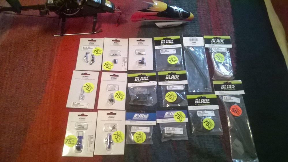

      .....and I did it again.
      $200 worth of aluminum upgrade parts for $40. Gotta love clearance sales. :D WP_20160814_001.jpg
