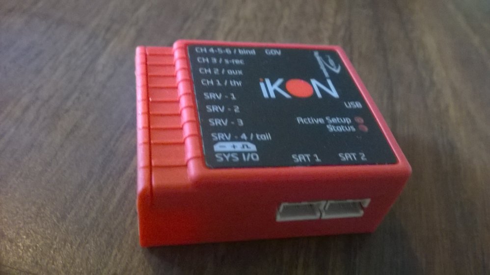

      That was the first thing I looked at. All I have to do now is put it in place of the K-Bar, download the setup software, and finish it up. :D

      So far, from running setup and a few no-blade spool-ups,
      the thing seems to have stronger gyro feedback to the servos with more movement than the K-Bar. This does make sense since the Ikon has to have full control in order to employ the rescue function, which seems to be working if the bench tests are correct. If I lean the heli one direction and engage rescue, the swash imitiately snaps in with positive collective and opposing cyclic movement. Tail lock seems solid from spool-up with tail blades.
      I do find yet again, I can only use 6 out of 8 channels, so to use rescue or self level, I have to give up adjustable tail gain or bank switching. Could this perhaps be a limitation in the Ikon or is it the DSM2/X satellite system? I have an 8-Ch Tx!
      First flight with Ikon shows smoother cyclic response, but cyclic gain might still be a little low to start with. Tail stops from piro are solid with no jitter or wag.
      An attempt at the rescue from a level hover simply added collective with no veering in any direction. I'll have to wait till I get out in open air to be able to give it a real test.

      So I finally worked up the nerve to try some inversions and rolls and what not..... as luck would have it, and wind, I found myself in enough of a compromised position to activate the rescue...... which worked as expected. There remains the default 45* bank limit after rescue cycles out, until turned off..... as I found out shortly thereafter.
      So far, no defects with the Ikon.

      If I'm not mistaken, the important part of an FBL with rescue/leveling is having the model on a level surface during power-up. That's the only step I've done other than assigning a switched channel to the rescue on AUX.
      For sake of comparison, I will say that the Ikon does feel more locked in for all 3 axis, a little less twitchy at times, and overall better quality than the K-Bar..... and yet the Ikon has already paid for itself with the successful deployment of the rescue cycle, and the successful resolution of what would have otherwise been a costly mistake.
