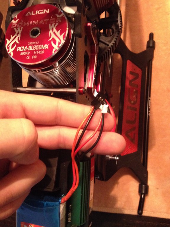

    5. iggy
      image.jpg Thanks for the tips guys.
      There are two wires coming out the RX pack but anyway the Gpro has only one input and that is the futaba plug..
