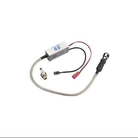

    I am transferring my O.S. GT15HZ gas engine to another airframe, and noticed that, the ignition module metal braid wire to the spark plug is worn in a few parts.
    Does anyone know where to buy some metal braid wire to patch it up?
    I dont care about aesthetics, its the RF shielding that I am worried about. Would it be enough to go to a hardware shop, and get some metal braiding of a plumbing hose fitting?
    I am guessing for EMI shielding, copper metal would be best. Maybe some copper tape from Altronics or Jaycar?

    1. mr_squiggle
      Anything metallic that provides a cover will do the job. You could use copper tape if you have it or you could also use aluminium foil (it's what is used for data cables).
    2. Fredo
      Fredo Well-Known Member
      190
      273
      I have used the braided fuel line sold at speed shops .( Just remove the rubber fuel line)
