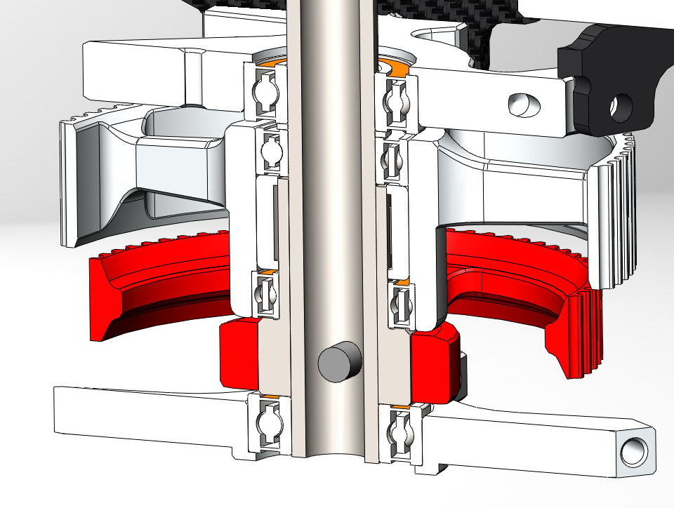

    19. mr_squiggle
      The flange on the lower bearing block should face up i.e. opposite to the top block.
    20. Glen
      Glen Active Member
      195
      107
      Bearing blocks go this way.
      The purpose of the flanges are to keep the bearings in. No locking collars needed
