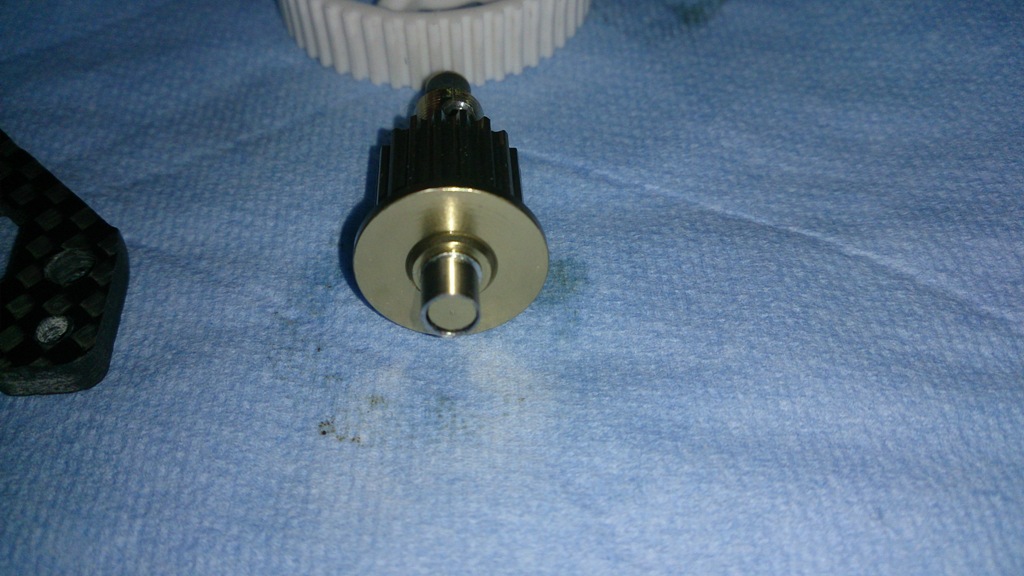

      My friend bought this heli and sadly from the beginnig had problems with it. He is good and experienced pilot. He has T-Rex 150 DFC , T-Rex 250 SC , MiniProtos 3S , T-Rex 500 PRO DFC SC ,
      Logo 600 6S , Agile 7.2 , Goblin 700 , Assault 800 , so he know a lot about heli assemble . One image is worth more then 1000 words, so this is his maiden flight
      After this accident he approve the ease of broken parts disassembly. He said that this is much easier than in t-rex 450.
      Unfortunately there is few things he is not pleased:
      1. Ball links are loose, so the heli is not precise (during for example landing), but in more like smack type flying it dont bother that much
      2. The aluminiom is worse then that used in agile 7.2 (he also has that model)
      3. Correct adjustment of belt on main gear is time absorbing and require few reassembles
      4. Stock esc's gov is not good,
      5. Reproducibility of parts is not good. New tail shaft have too deep pit (hope I use good word) for tail hub screw so the hub may get loose during flight
      6. Original swashplate had runaut, and another one during uscrewing balls brake off thread.
      7. Dont even know how too properly name this failure. Element on photo rub off in bearing, causing play that damaged belt
      8. Fighting with tail shakes, made my friend exhange all drive and tail elements with no effect, and during dynamic tail blades balancing, shakes where that big that new lynx tail blades explode.
      The design of heli is good and when it fly it fly great, but sadly it looks like kds did not use top quality materials to build it.

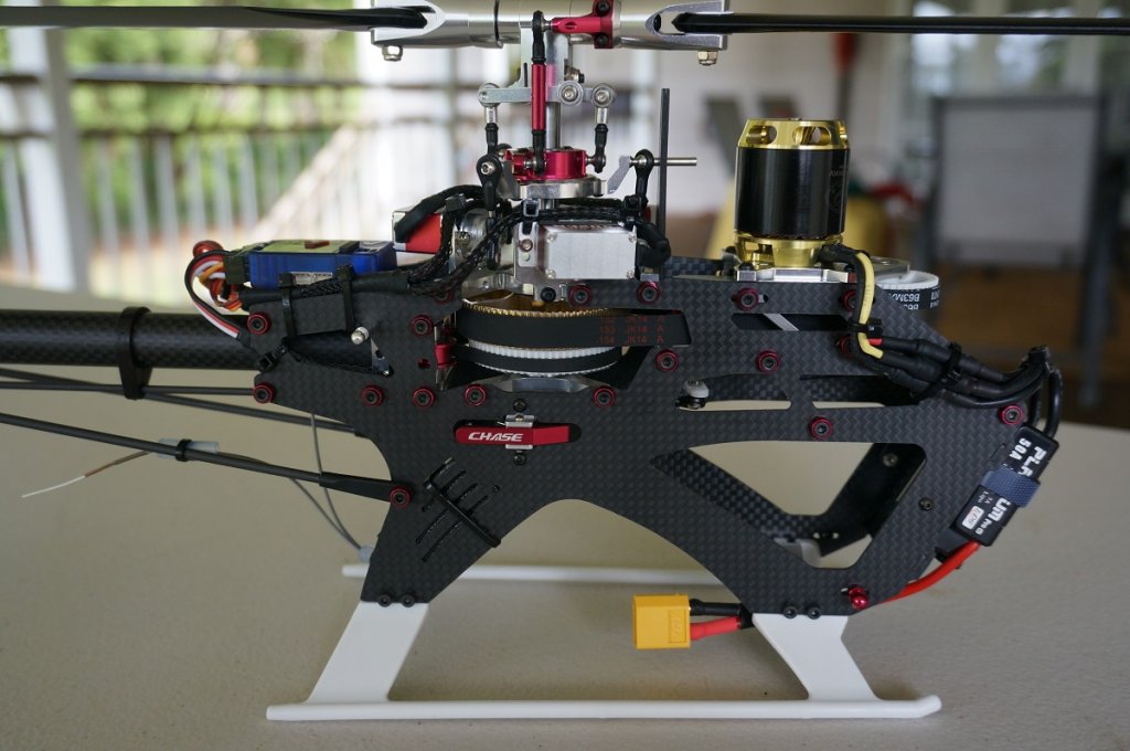

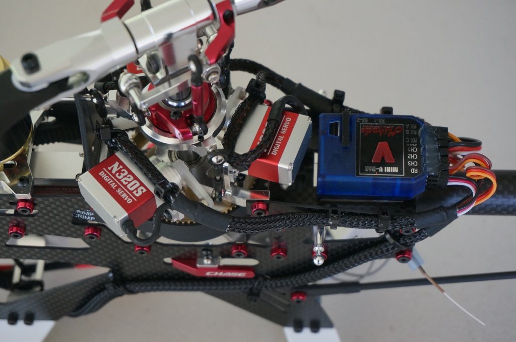

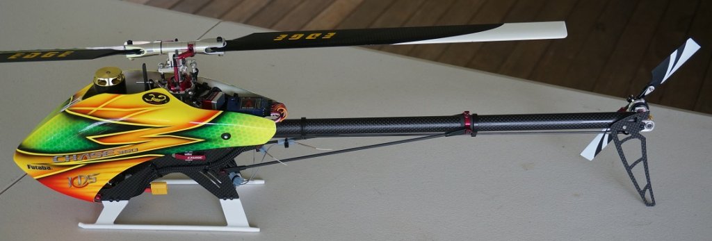

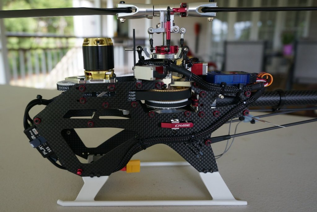

    3. mr_squiggle
      Maiden went well today with no major issues. Like others I've found the tail gain has to be quite low, mine's at 35 and it holds well. I think I found the resonance others were talking about and it occurred at 2500 rpm so I'll have a play around there to see how it goes.
      2200 rpm and 14 degrees of pitch is a bit of fun too. It's very quiet and smooth too. The VBar governor is working OK, but needs some more tuning to iron out the small tail kicks on punchouts.
      Here's what it turned out like.
      Chase360 right side small.jpg Chase360 top small.jpg Chase360 canopy left side small.jpg

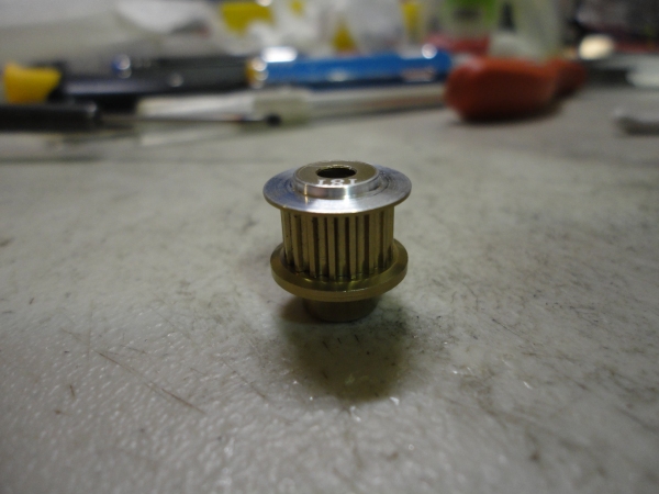

    16. Toml
      Toml New Member
      Jul 24, 2014
      5
      1
      So I've stalled my build while I go and work out how to get the motor screws to sit flush into the mounting block, so that the pinion doesn't sit too high. It seems like others have been opening up the channels in the block so that the screw heads sit lower and some have been filing down the bottom of the motor pinion to avoid them?
      I've also noticed some binding on my tail pitch slider when it's driven by the control arm. i.e. the pitch slider on the tail shaft runs nice and smooth by itself, and the lever/control arm runs smooth too - but when using the control arm to drive the pitch slider by hand it feels quite a bit tighter as it moves towards the tail case. Did anyone else notice this?
      Thanks
      Tom

    19. jockstrap
      @Toml - I put my pinion on a lathe and trimmed it down a bit..
