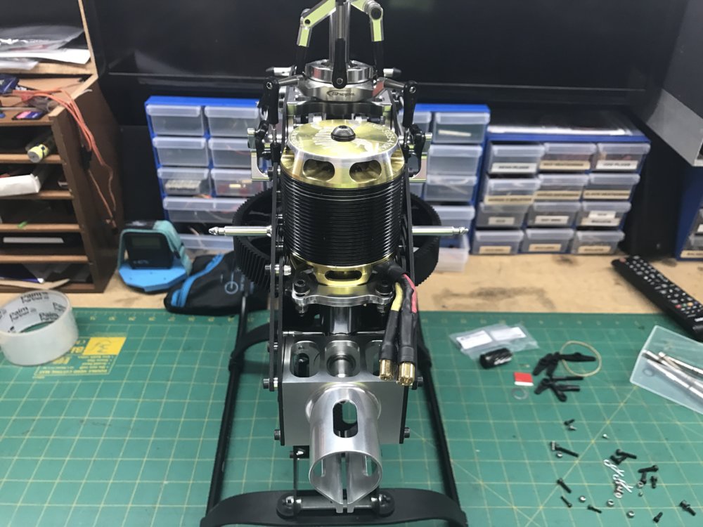

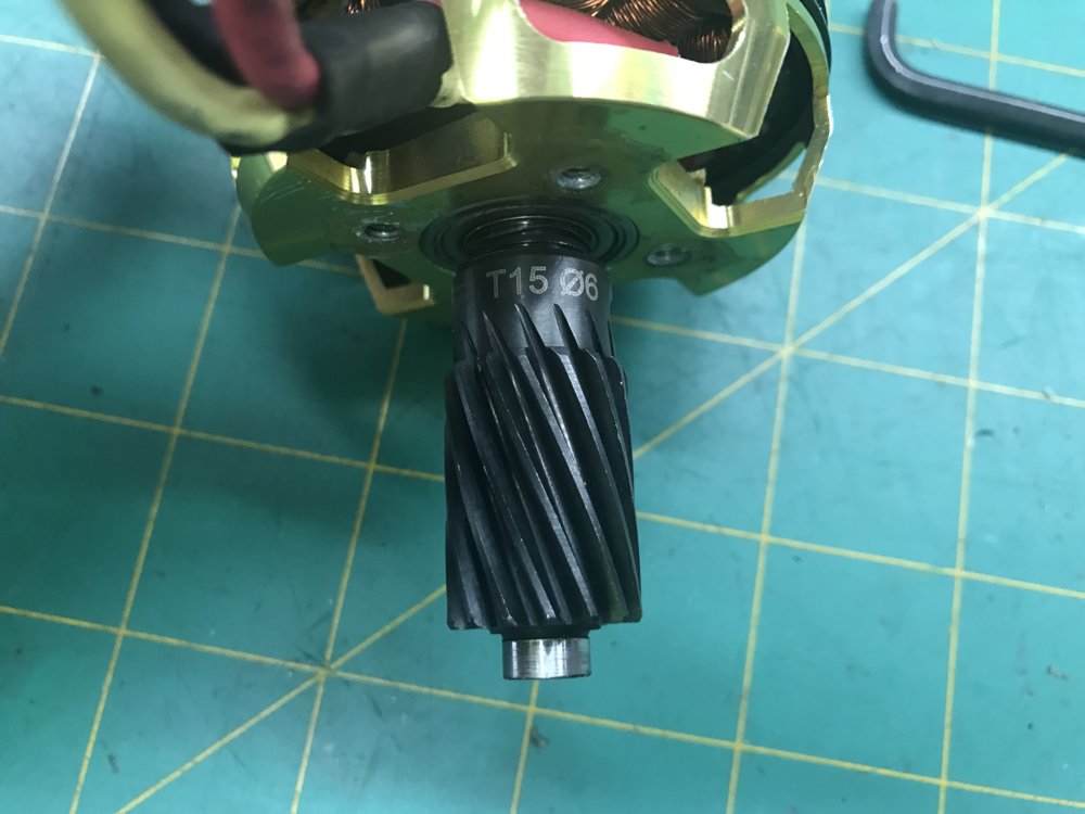

    I have had my eye on these for a while now and one came up for sale in Denmark. The bloke decided to split and was selling the Airfram with blades at a good price so I jumped....... A little over a week later she arrived.
    So this is the Shape S8 from Freakware in Germany
    Setup

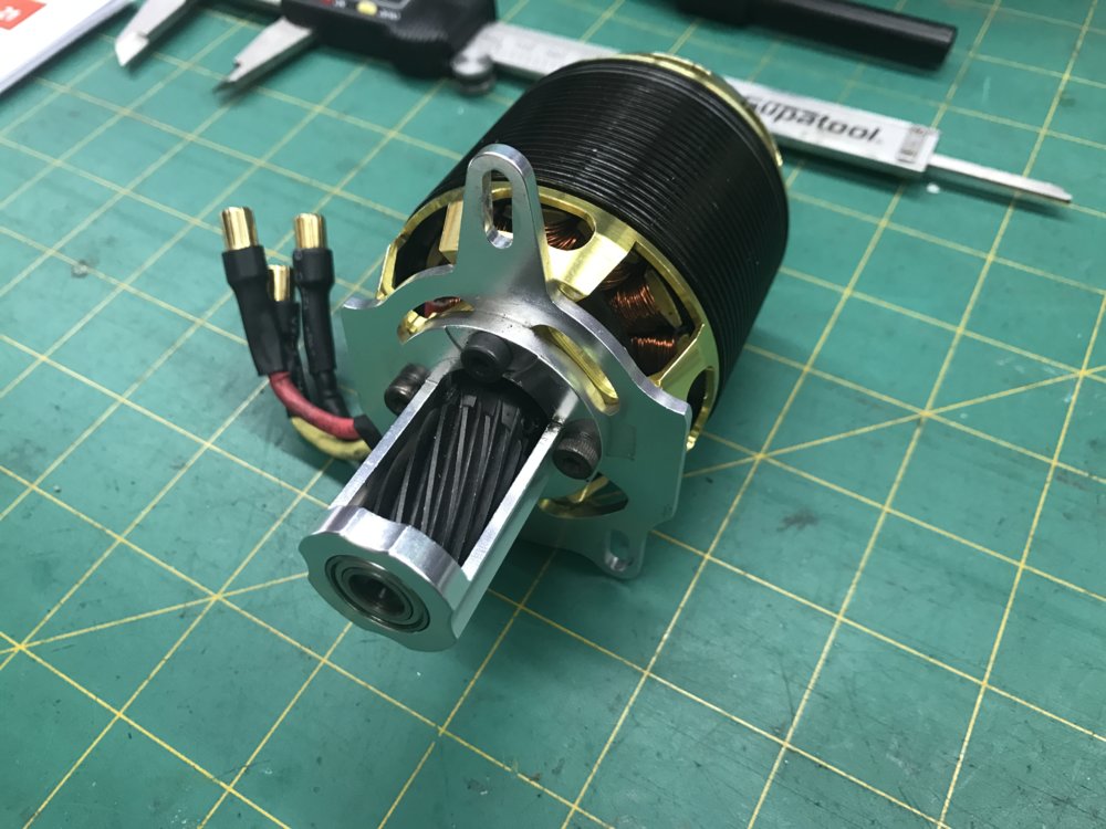

    Scorpion 5035 410kv
    Kosmik 200
    BK DS-7001HV

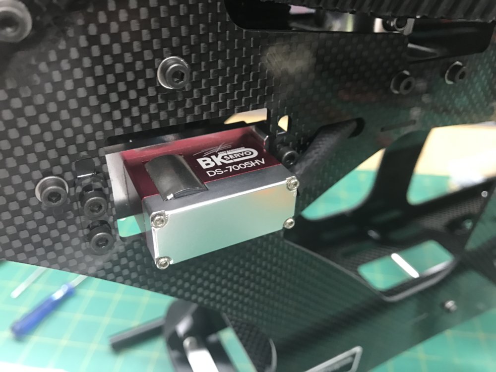

    BK DS-7005HV
    Vbar NEO Pro+rescue
    Mikado TelMe module
    Buffer 2s 450mah
    12S 5000
    Xblade 807
    Xblade 116
    HS well not sure yet, highest will be no more than 1900

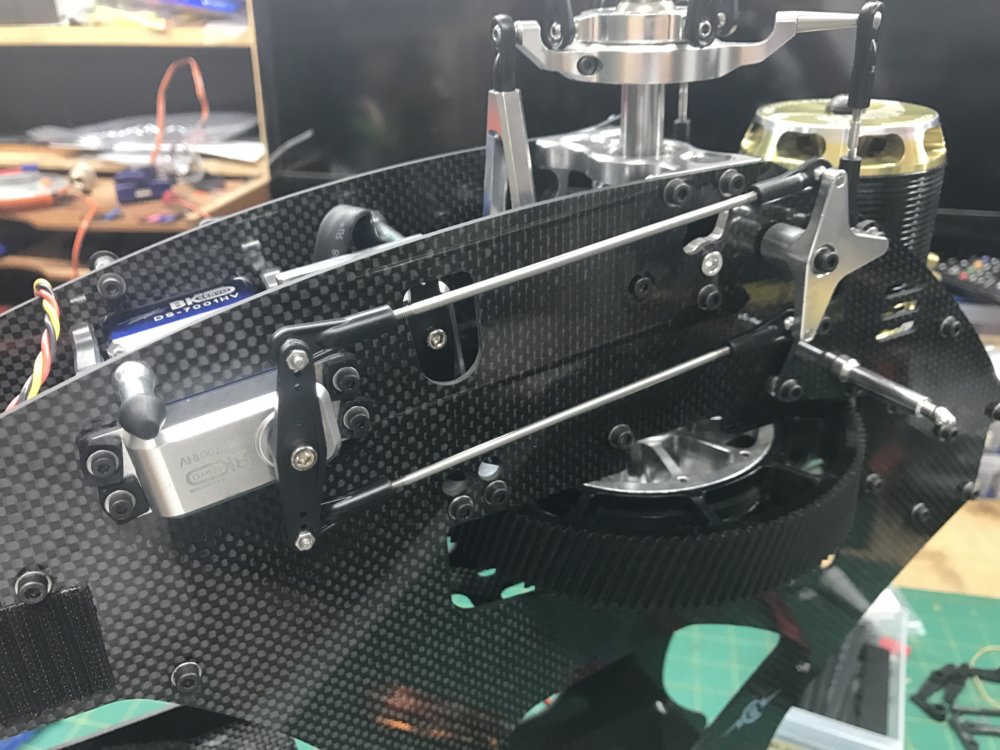

      I just got a Shape 8, but realised that the kit was supplied with two left bellcranks, so Freakware is supposed to be sending me the right-side one and then I can finish the FBL setup.

      I actually got the airframe 2nd hand because coincidentally someone here in the UK was trying to sell one. I have pretty much rebuilt the whole thing though, it's not difficult to build but it cannot be done on auto-pilot like some kits, there are lots of subtle things that require paying close attention to get right. So the first owner didn't notice the two left bellcranks :-o

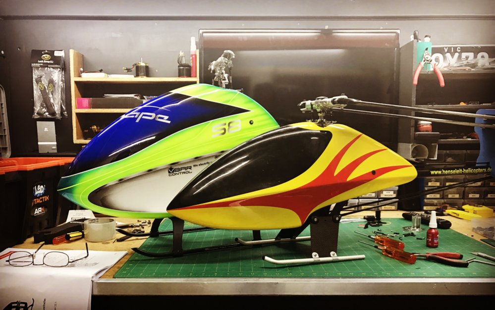

      Mine is almost ready to maiden now. With the correct bellcrank on the right-hand side leveling the swash required very little trim in the Vortex. I have two canopies and they are so nicely finished, so I started looking for some kind of canopy cover. I have covers for all my other helis but nothing that was even close to fitting the Shape. I asked around a bit, asked Freakware but they didn't know of anything. So I took a chance on a motorcycle helmet cover, thinking it's almost the right profile and I couldn't think of anything else. So for now I have slightly modded this cover and it does fit, it doesn't cover the entire canopy but it covers the whole nose area which is the bit that is most prone to getting scratched when I'm carrying them around.
