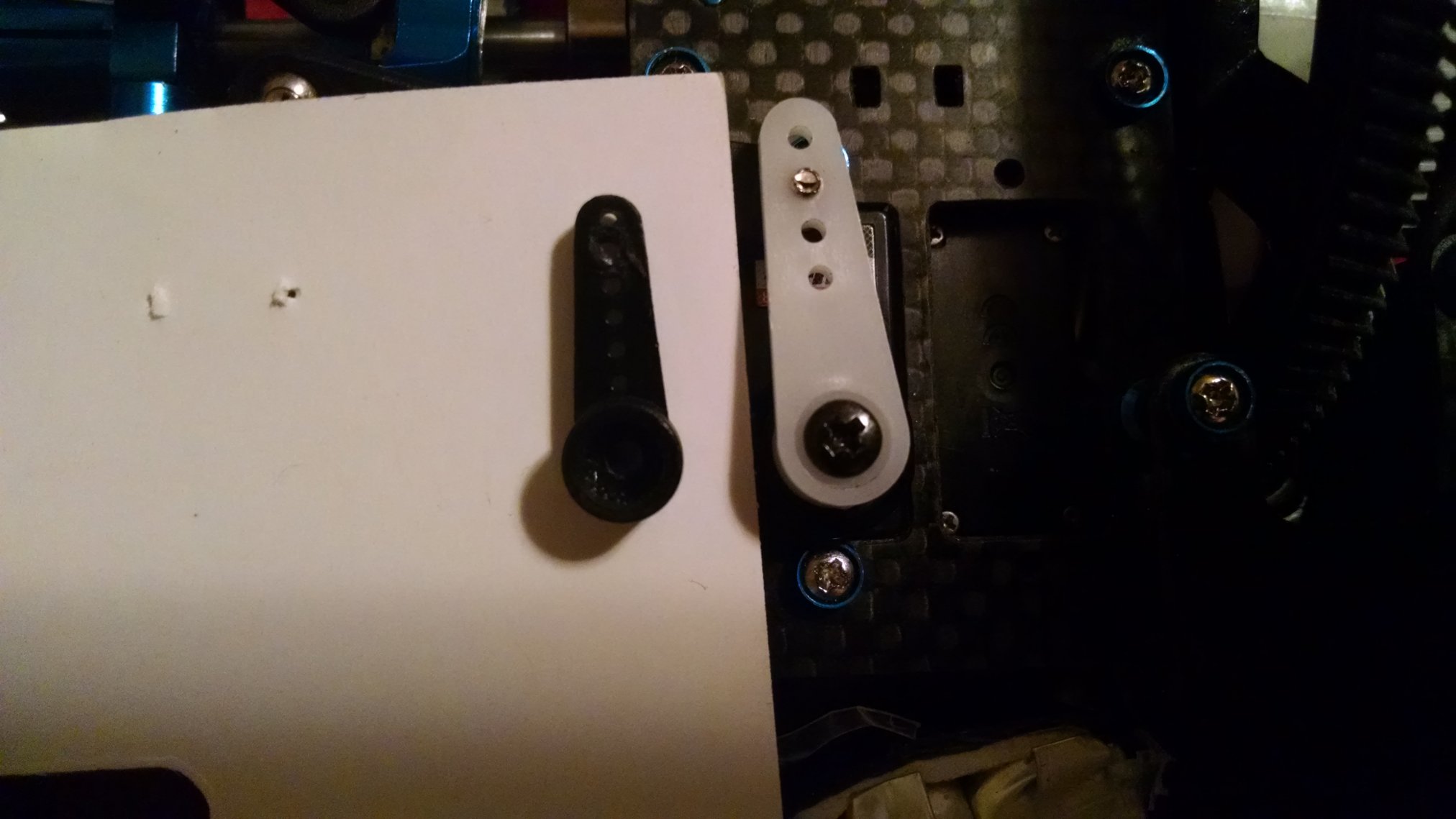

      Hey mate what length are you now running your servo arms and what was the advantage in going longer?
      Not counting total length of the arms since I avoid going out to the last hole on the arms for added strength..... I went from (approx) 13mm (center to center) on the black arms to 17mm on the new white arms. This changes the geometry between the servo and swash so that the servo moves a bit less and moves the swash a bit faster.... similar to changing gear ratios. This does make the servos work a little harder and draw a bit more current. IMG_20160331_011254313.jpg

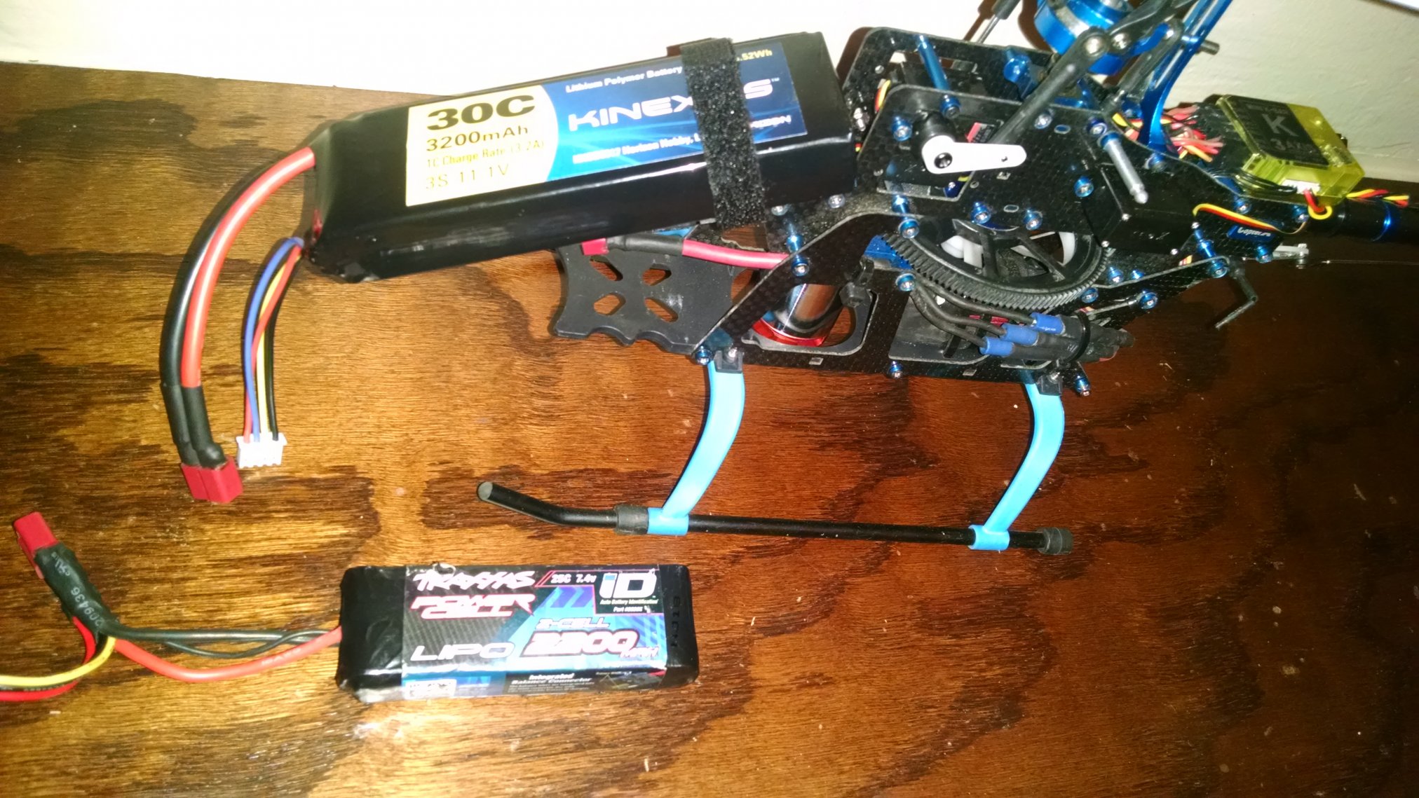

      For tonight's flight, I ran times on both the 2S 2200mAh pack and the new 3S 3200mAh pack. Both packs pulled solid 10 minute flights measured from spool-up to power-down, so it's realistically more like 9:45 actual time in the air. I still want to buy a second matching pack to go with the 2S pack to build a 2S 4400mAh "split" pack, and mount the second 1/2 of the pack on the lower tray.
      I think I could get close to 20 minutes, based on the first 2S test flight, with the 2S pack weighing 120g, and with the old 3S/3000 pack still on the Heli as dead-weight, and still pulled nearly 8 minutes in the air carrying 233g of dead weight! Both 2S packs together (4400mAh) will only weigh 240g. The new 3S pack is 260g and makes the 450 slightly nose heavy, but doesn't seem to have any noticeable effect on elevator trimmings. IMG_20160403_203824813.jpg
