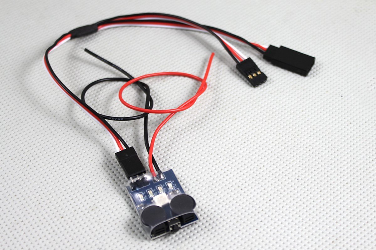

      I signed up for a free product test and review for a place called Targethobby on Amazon. They are sending me one of these 3-in-1 buzzer units for low voltage/signal loss/model finder.
      It will be interesting to see how well the voltage threshold works compared to using a timer to keep from going below 3.7v per cell/ 25% charge as I have monitored lately with a dedicated multi-cell LiPo balance meter.

      The buzzer should arrive in a few days.

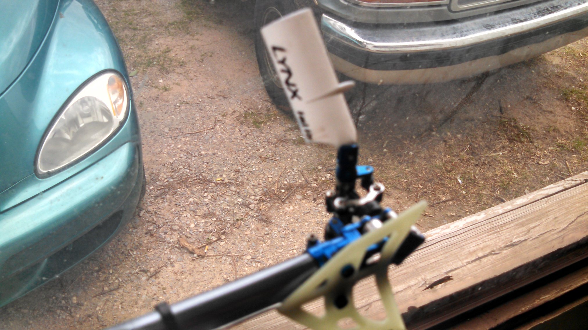

      So, having given the 450 a good inspection and taking care of a few small details, I focused my attention to the tail blade problem. Being without a viable set, I tried cutting down a set of Lynx Nano CPx blades that were damaged at the outer end of one blade, but far enough out to get slightly longer than what the CF blades were... 64mm maybe? Roots shimmed with small washers to take up slack in the grips. Will test them tomorrow. :D

      I hit the park and went straight to the 3S pack and gave the 450 as much of a flogging as I'm currently capable. The Cut-down NCPx blades worked great for tail blades! No tail blow out or drift at all. I need to back the tail gain down a bit now..... Several times I observed a fast wag after hard maneuvering, otherwise.... Success.
