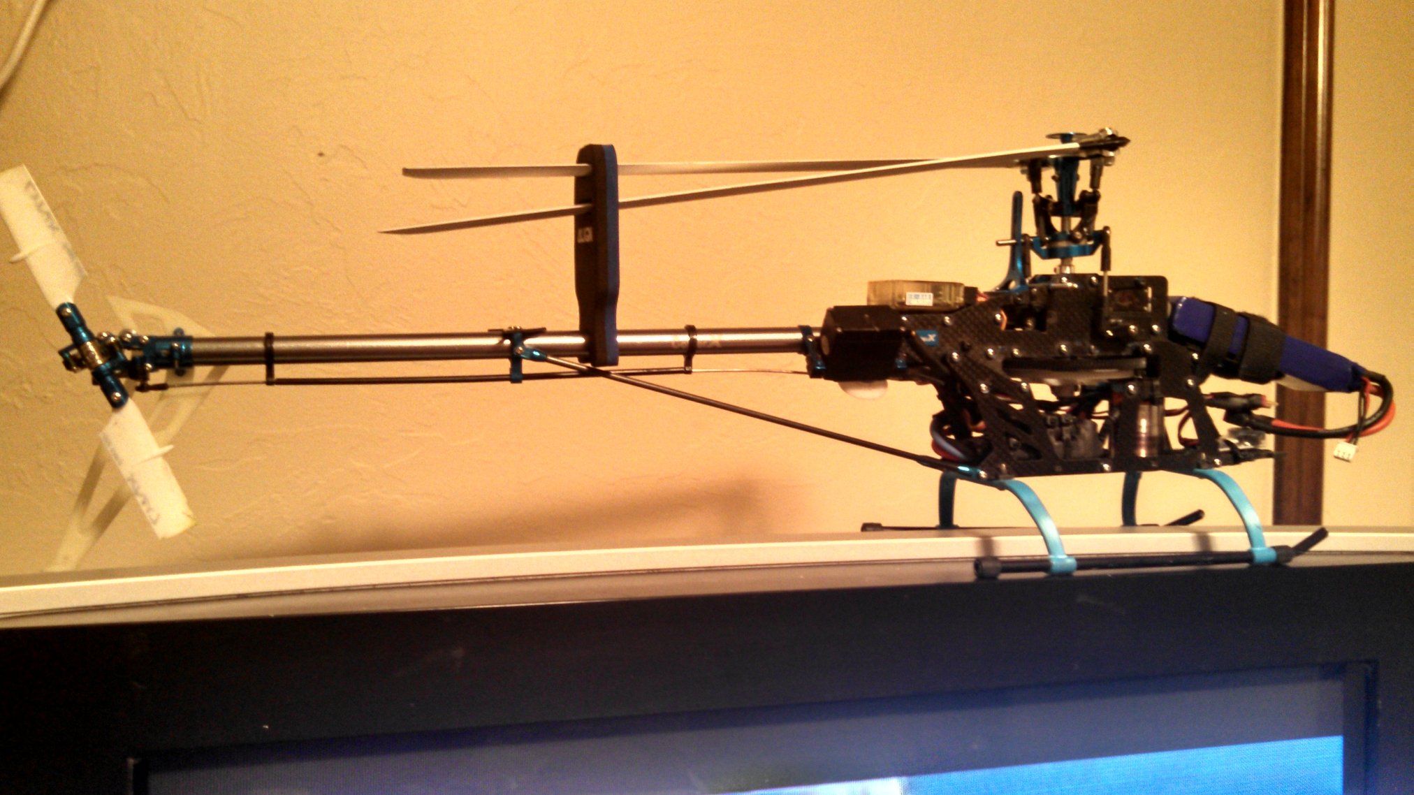

      one thing I noticed Beaver is getting faster at repairing every time
      I'd be right in the middle of it if I wasn't running karaoke tonight. I'll get back on it tomorrow night.
      Four hours worth of work including all adjustments of setup.
      I put a DFC (shorter) main shaft on with the standard fbl head, shortened the head links and dropped swash neutral just a tad. Full range collective and cyclic movement at the swash with no binding or interference with frame or head due to the shorter main shaft. :D
      Two servos repaired: one needed gears, and the other needed the motor replaced. That was unexpected time spent.
      All said and done, it's ready for the air again..... or at least a good test flight to start with. :D IMG_20160519_021326_035.jpg
      How did you replace the motor @Beaver? That would have been very tough to do? Never had to change a motor yet and do not look forward to it.

    7. Beaver
      Soldering isn't difficult as long as leads and terminals are pre-tinned........ then its just a matter of touching the wires to the terminals and applying heat till they melt together.... Then hold till cooled.
      Motor is easy to get at, especially on that elevator servo where the back of the servo is sticking out the side of the model. Takes all of 5 minutes if a motor is already on standby, but I actually had to take several old motors apart to make one good one and then install it, so it took a bit longer this time.
