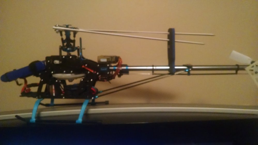

      ..... and it's back. Waiting for a chance to test it. :D IMG_20160623_042033052.jpg

      Well @Crash Heligod has taken all my helicopters and stashed them in his heligraveayard. Every time i get myself a model @Crash Heligod confiscates it and says that i need to produce descent news before i am allowed to fly. The only model he has not taken is my pride and joy shown below... Its cheap to run - I just stare at it and dream...
      Re your DS919MG servo upgrade, please check the following before flying. I was reading your post where you said it seemed like there was no control and the heli continued to drift right. It made me think... what happened if you had a power drop due to bec overload and the transmission was lost to the fbl. If that's the case when you fly next using the even higher torque servos you might have the same thing occur. So... i would recommend spooling up your heli with no blades.... switch off the transmitter. What happens? Does the heli keep the engine powered up? are the servos stuck in the same position? If so then that might be the cause of your original problem - ie the receiver has lost signal some how - either due to power fluctuation or something else. Your failsafe should depower the heli so it falls to the ground....
      I've been pretty thorough in going over the BEC awhile back. It's at 5.5V 3A with 5A surge capacity, and I installed 4400uF worth of capacitance and double BEC leads to the Kbar. Heli was under power till I cut the throttle switch, then it shut down immediately..... then dropped on the roof. IMG_20160311_014627786.jpg

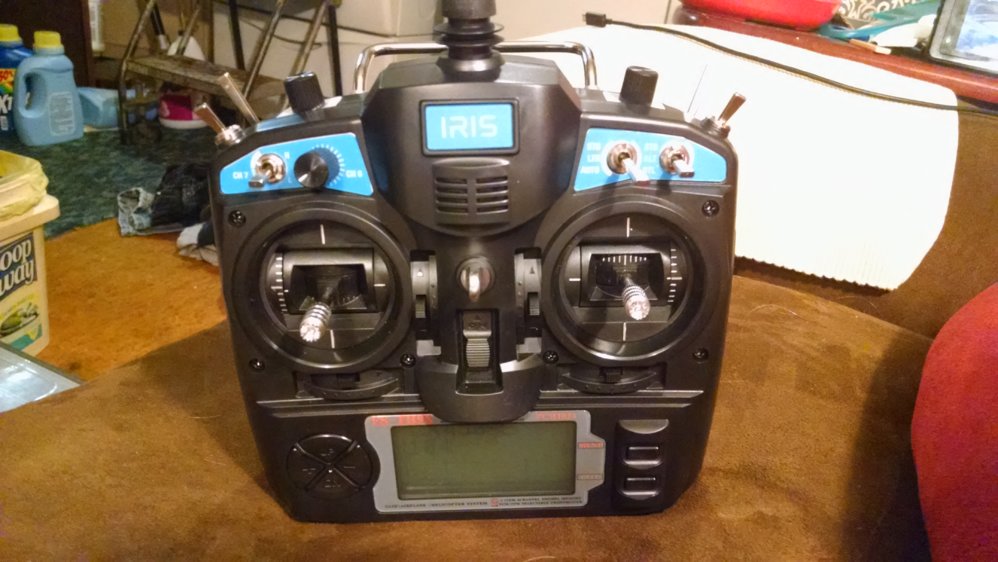

      The FS-TH9X radio arrived today while I was away at the gig. Now I need to scavenge a high output DSM2 or DSMX module from one of my old radios.
      I'll be a week learning how to work the menu to program this crazy thing! :eek:
      ..... but when it's ready, I'll have full control of K-Bar or Fly-bar. :D IMG_20160626_240751757.jpg

      Thanks, but I just started using this new FS-TH9X (9-channel) little more than a week ago. It works great! I'm just getting used to the computerized programming functions..... it's my first computer Tx and I converted it to DSM2 to work with my birds. I was even able to revive the NanoCPx that wasn't working with the old DX4e anymore. 5 models programmed in now, I still have some minor fine-tuning to do. The important thing is that it's new, and it does everything I need it to do. :D IMG_20160626_240751757.jpg

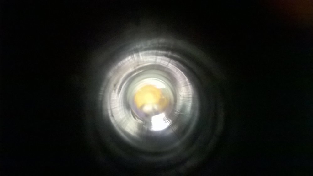

      It's good to work in a well equipped shop. This tail boom had a nice bend in it before I straightened it..... Good as new.
