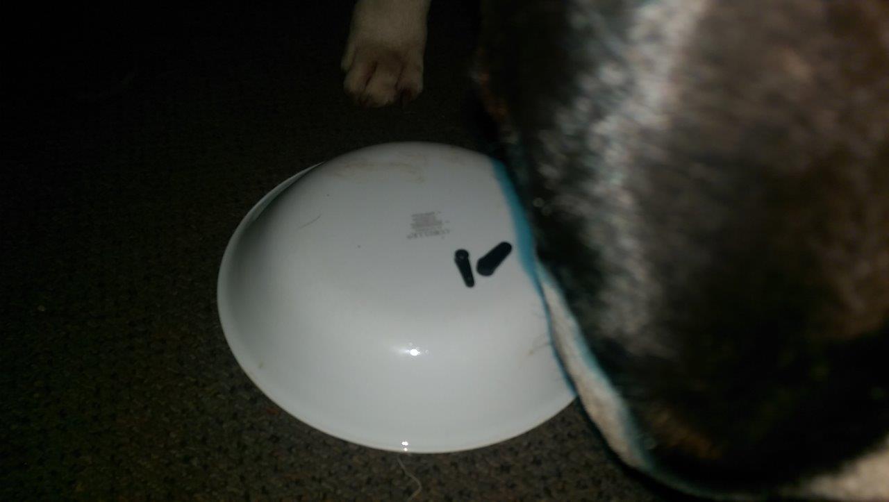

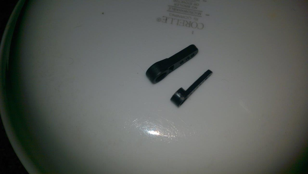

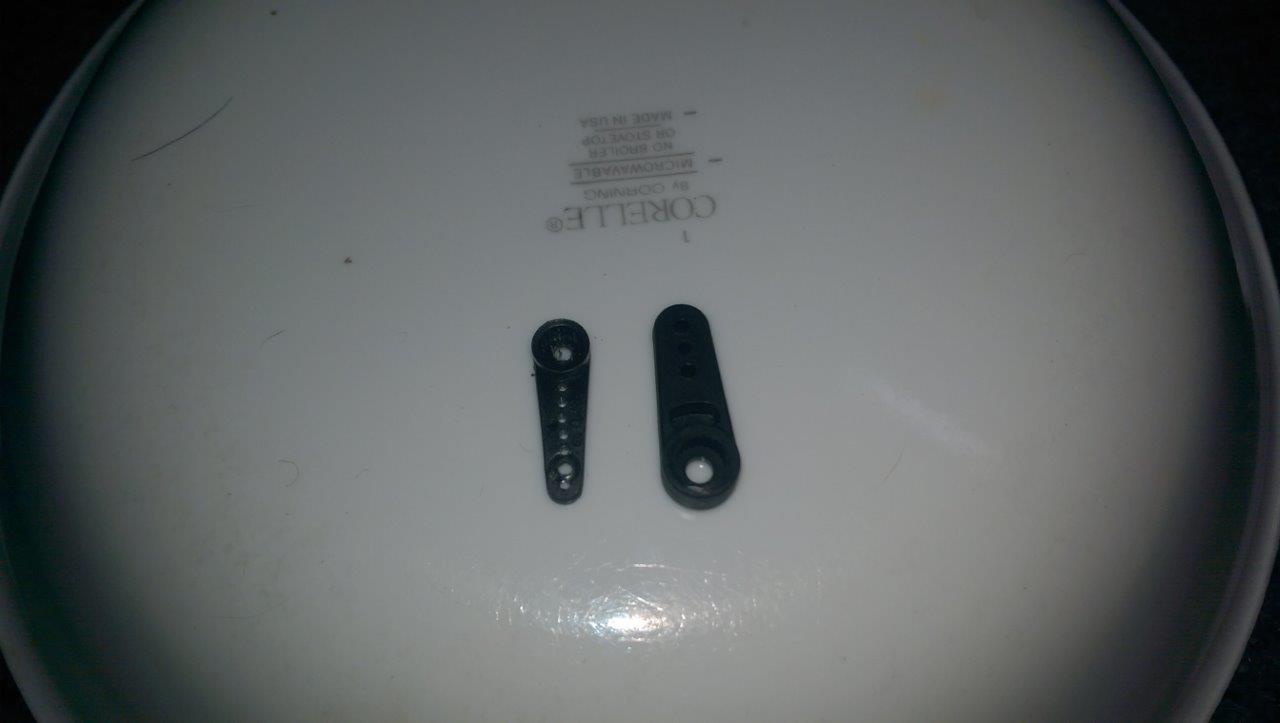

    I was noticing some weird feelings while flying my gobby 380 at the swamp. It just did not feel right, ie it was a bit lethargic on the pitch pumps. Don`t get me wrong, it was still great - but i noticed something was degrading over time. I was playing around with the swash and noticed that the servo horn was twisting when pressure was placed on the ball link. After X amount of flights the servo horn was actually getting softer!
    So i found a set of SAB servo horns which were bigger, stiffer and harder!. I cant wait to try them out this afternoon. Too hot at the moment *35 degs. Has anyone else found the same issue? Here is a comparison of the stock bk servo horn compared to the sab servo horns which fit perfectly.

      are you using a nut to lock the ball on the servo horn?

      Yeah I was using a nut as well.. Just back from the flying field and yes a huge difference, Simon why didn't you tell me? Every one else said it didn't matter!

      Well now I am a convert @simon - thank you for that...infact i would go further and say that the slightly longer (servo) horn is also better because it makes for a much more responsive reaction. Couple that with a thicker and stiffer geometry and you can really make her dance! Today was simply awesome and my heli felt sooooo good. cant wait for tomorrow! (btw my screen is now covered in coffee after reading your first reply)..
