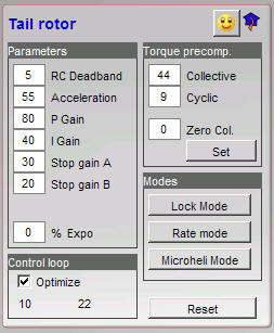

    I've just put a yellow K Bar on an Align Trex 450 Sport that I've had for some time. It's been using a ZYX v4, which flew pretty well, but now I'm moving most of my fleet over to the K Bar. The tail servo is a KST DS115MG micro servo, that is quite fast at 6 volts (which I'm using).
    The yellow K Bar uses a digital 3 axis MEMS and a second MPU to emulate the older analog sensors, one of which is now end of life. So the gyro is a bit of an unknown, and this is the first time I've tried it on a 450.
    The heli flew well on the default settings, but the tail wasn't as good as it used to be. Changing the gain just took it from wag to mushy, but it still felt odd, with strange kicks and the odd flutter, especially with puffs of wind.
    The Accel setting had no effect from 55 to 75 and the P gain didn't help. I tried the I gain from 50 to 90, and that didn't help, but when I set it to 40 it was better. I then had to increase the precomp (currently 44, but I'll play with that some more).
    William has offered to show some settings for his 450's that look to fly very well, especially with his excellent flying skills. I know he spends quite a bit of time getting his helis right and he has a lot of experience with the V Bar. This K Bar may however require different settings, due to the different sensor setup.
    If anyone has a good working setup for a 450 then please share it here.
    I've attached my current tail settings, but I'll play some more to see what's best.

      Yes, the bluetooth is great. That's all I use now, even with the laptop. I usually enable the bank switching after I've got the tail how I like it. This has proved to be more of a challenge with the 450.
      I had another go at mine this morning. I managed to get rid of most of the stop bounce by increasing the stop A/B gain and lowering the I gain slightly. I also lowered the precomp, which eliminated some collective stop tail movement. More experimenting tomorrow. I want to see what effect a lower accel has on the 450. One person found accel=35 and P=90 worked well on his 450, with 75% gain.

      These are my final settings for the Align 450 Sport. I don't think I could get it to fly any better than this:
      Gain = 71%
      @William, note the Stop A = 80. This is what I needed to get a sharp CW piro stop/reversal. Note I think stop A and B can be reversed depending on the gyros mounting position.

      After seeing the new Align GPro uses the Microheli mode for the 250 and the 450, I decided to try the Microheli mode on my 450 Sport.
      The result was a heli that flew well on nearly the stock settings at a gain of 60%:
      Note: When you click the Microheli Mode button the tail gain is also adjust to 75, which is normally too high for a 450 or 250.
      So it looks like a V Bar Microheli is anything 450 or smaller. Off now to set my 450L Pro to the same settings...

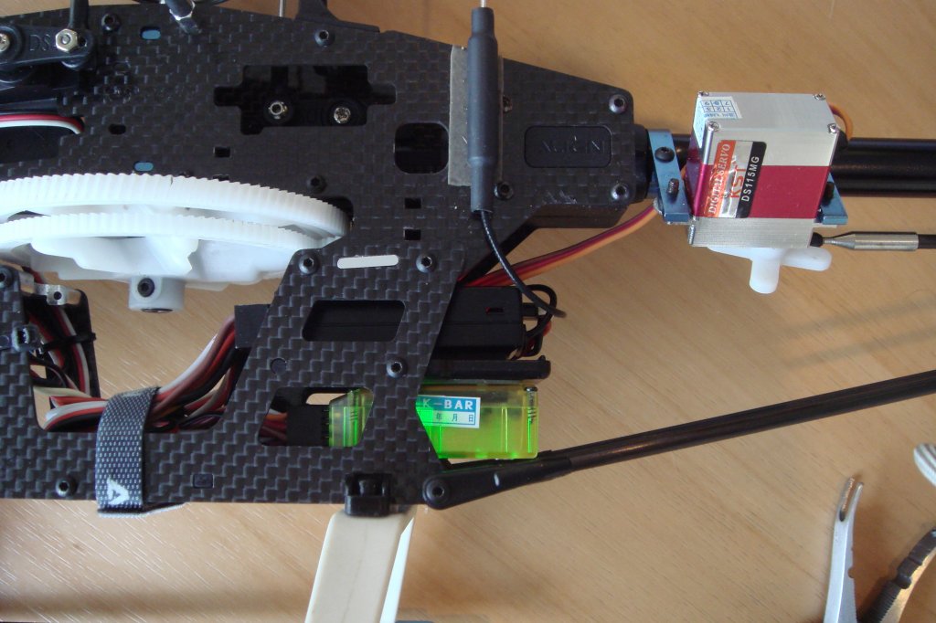

      Have got one of these to try side mounting on a 250.
      Has anyone tried side mounting it & noticed any differences.
      Whilst a small detail, I actually like the "green glow" when it is active...
      Here is the "manual" to show the various mounting positions.
      Cheers,
      Yak.

      @Yak, I have it side mounted on a 550E. Works really well. No issues I can find when using it this way. Slow flash setting in my case.
